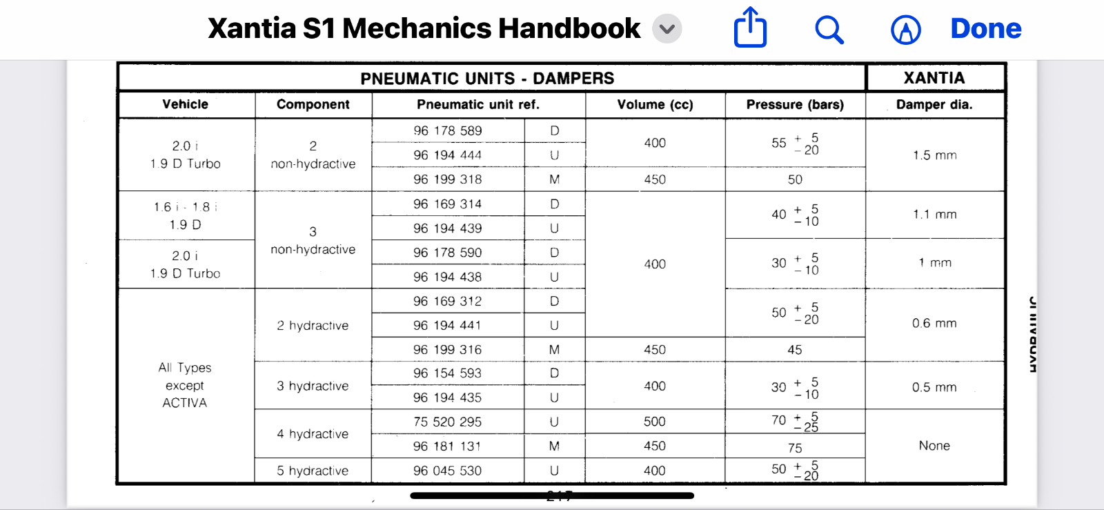

Rather than complicate the other WOES thread with sphere talk, I thought it would be useful to keep this separate.
I assume my S1 1.9TD is non-hydractive because I have 3.5mm pipes.
So looking at the 1995 Xantia Mechanics Handbook I note that the spheres for the 1.6i, 1.8i and 1.9D have the biggest damper holes.
So I set about writing them down for quick reference when searching for prices.
Part Numbers (membranes D for Desmopan, U for Urepan and M for Multicouche) as follows:-
Front Spheres (Part Index 2):-
96 169 316 (D)
96 194 445 (U)
96 199 312 (M)
Accumulator: (Part Index 1)
96 154 588 (D)
95 451 376 (U)
Rear Spheres: (Part Index 3)
96 169 314 (D)
95 451 376 (U)
SC-MAC Sphere (Part Index 6)
NOTHING LISTED FOR NON-HYDRACTIVE!!!!
Am I going MAD?
Does anyone know what the part number would be for the accumulator on the 1.9TD please or where I can find it?

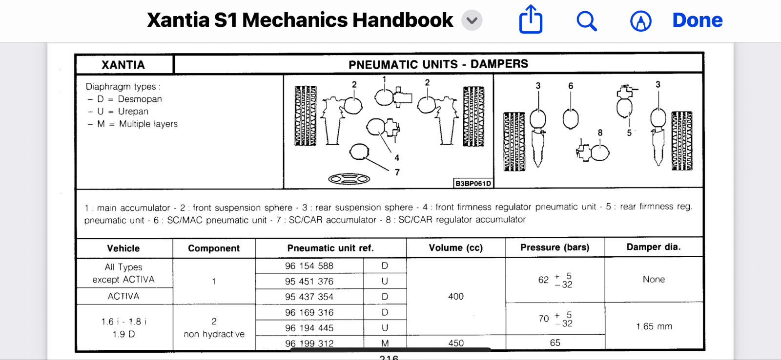

Re: Citroen Spheres - S1 1.9TD (Comfort required)
Rhothgar wrote: 30 Mar 2026, 13:06
Am I going MAD?
Au contrare Roger, the third of your pictures has component 6 listed for ALL TYPES except Activa!!
Does that not mean that if you have component 6 then the car is Hydractive? :-D
Unread post by Rhothgar »
mickthemaverick wrote: 30 Mar 2026, 14:45
Am I going MAD?
Thereby hangs my problem!
It's cast a shadow of doubt on whether my car is hydractive! I am sure it isn't because I thought Hydractive cars have the 4.5 mm or 8mm pipes. I must admit, however, that I haven't actually measured the diameter but what's a millimetre between friends?

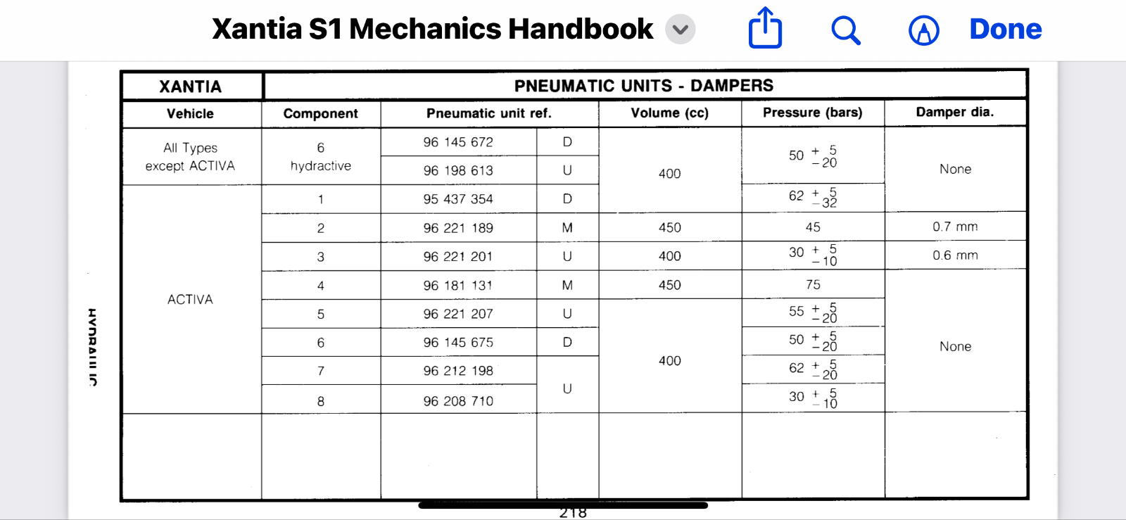

Unread post by xantia_v6 »
Number 5 is the hydractive sphere, number 6 is the 'anti-sink' brake accumulator sphere.
Rhothgar
(Donor 2026)
Posts: 2432
Joined: 22 Nov 2004, 00:21
x 221
xantia_v6 wrote: 30 Mar 2026, 22:35 Number 5 is the hydractive sphere, number 6 is the 'anti-sink' brake accumulator sphere.
OK but is my S1 car hydractive?
Posts: 10967
Joined: 09 Nov 2005, 22:03
x 1459
Rhothgar wrote: 31 Mar 2026, 06:57
Probably not. In the UK, hydractive was only fitted to VSX or Exclusive trim cars, and I don't think I saw a UK 1.9TD with those trim levels (I have seen them in France).
A Xantia with anti-sink and hydractive will have 4 spheres at the front and 4 at the rear. Without hydractive there is one less at each end.
Rhothgar
(Donor 2026)
Posts: 2432
x 221
Thanks for the clarification Richard.
I wrongly believed it was all to do with pipe diameter.
I have 6 spheres so the search for a part number continues.
Posts: 10967
x 1459
As Mick said, All Xantias (except Activa) use the same SC-MAC sphere, regardless of hydractive. The SC-MAC sphere has no influence on ride quality or comfort.
Rhothgar
(Donor 2026)
Posts: 2432
x 221
xantia_v6 wrote: 31 Mar 2026, 10:36 As Mick said, All Xantias (except Activa) use the same SC-MAC sphere, regardless of hydractive. The SC-MAC sphere has no influence on ride quality or comfort.
OK. So I am safe to use that part
number then. It’s just that reading it in black and white it doesn’t state non-HA in the Mechanics Handbook.
