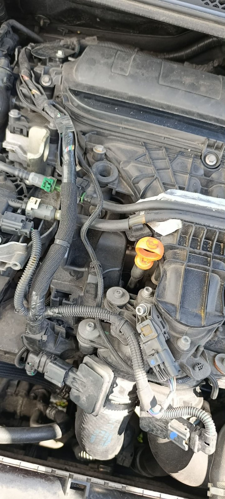

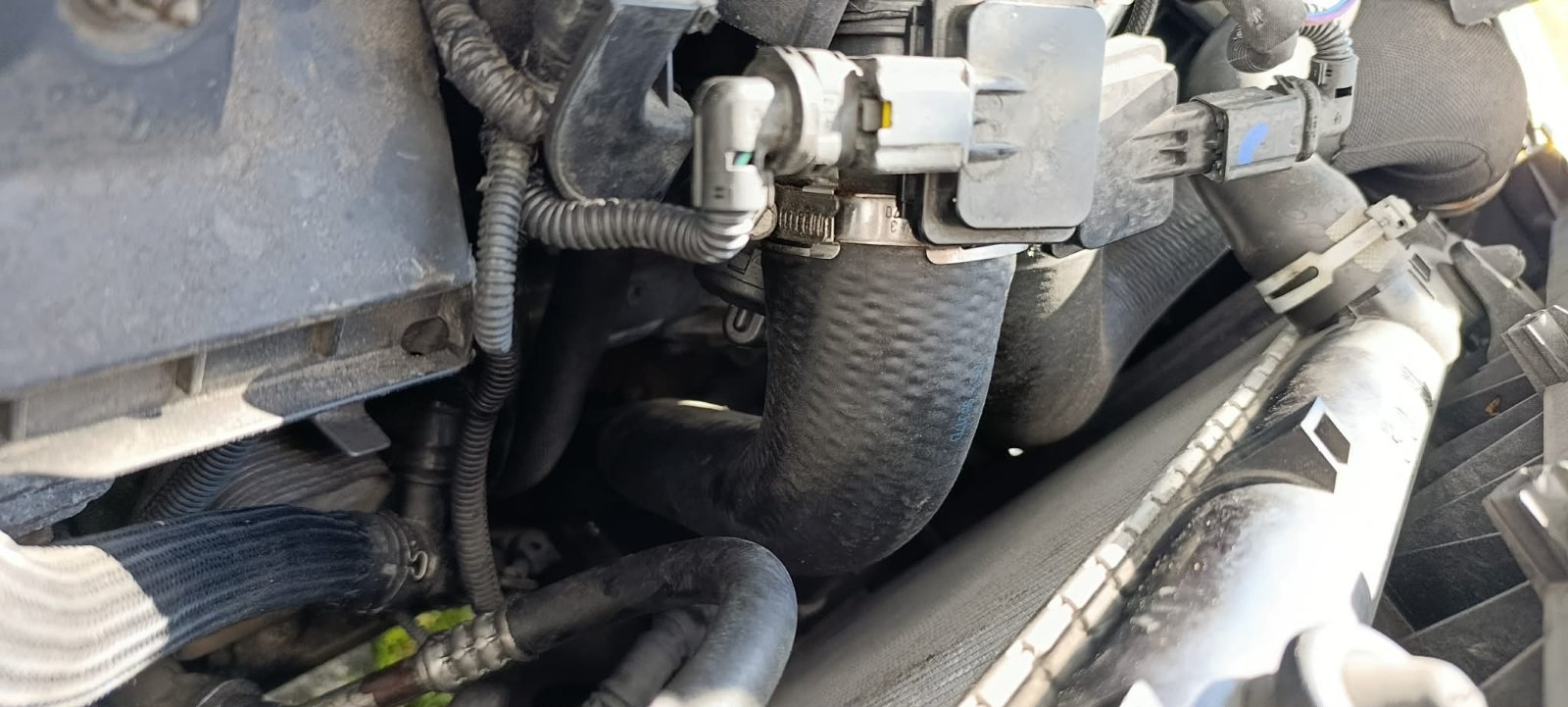

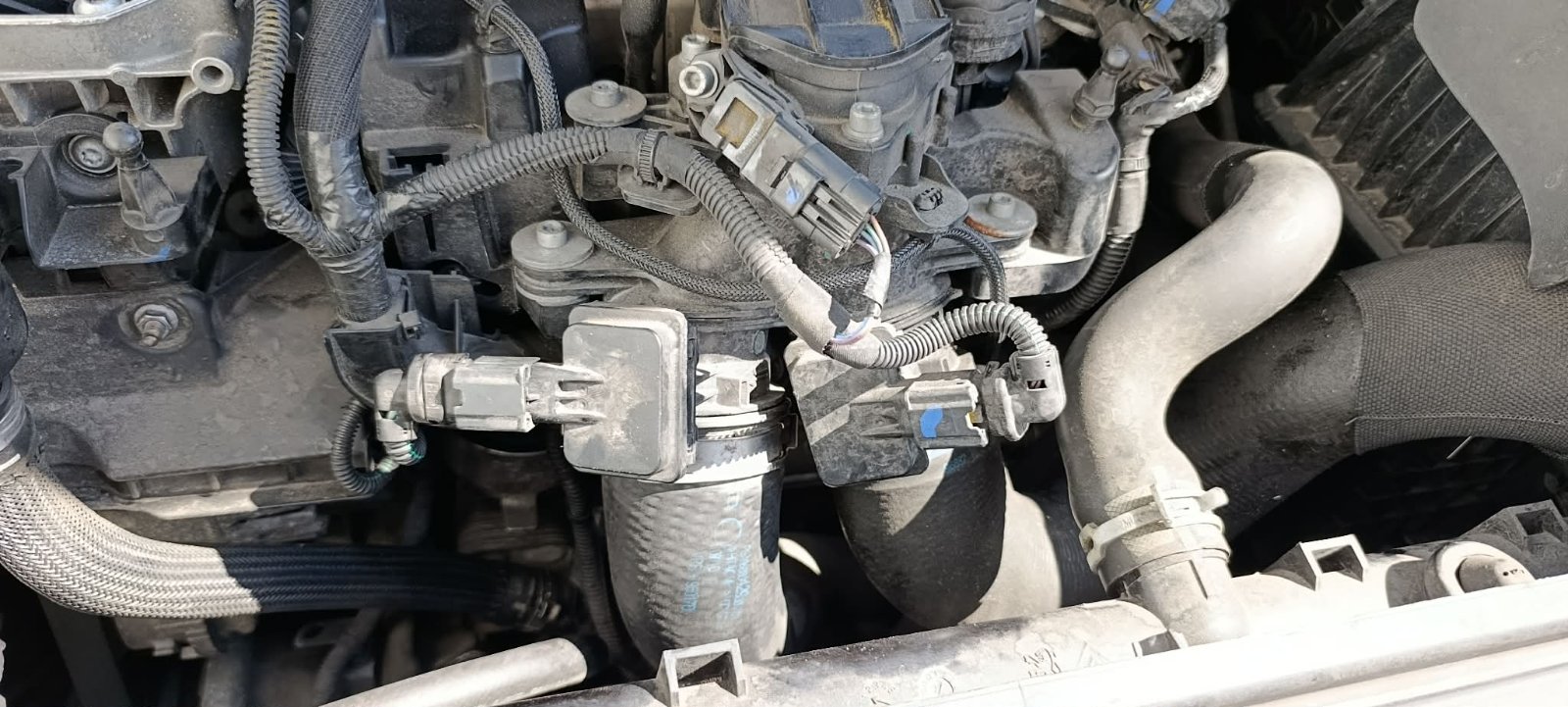

THis is my air doser, on the left bank you can see that the flap conector is there connected but it was disconnected, although from the top of the engine there is only 1 vacuum pipe connecting to the right bank on the left bank the electrical connector for the flap was turned off and I have again turned it off and the vacuum conector has no vacuum pipe and there is also none in the engine. I have read on the net that some had the left bank disabled, I am just not sure this is one because there is a pipe connected under the air doser.

Drive with the windows open, or better yet through a tunnel, if you've a significant boost leak you'd hear a whoosh / hisssssss sound.JohnyRiffle wrote: 23 Mar 2026, 20:02 I also feel under light load that there is a boost or pressure leak and wonder if it is related to this or not, the car seems to be pulling well,
That's normal, only shows above 20 mph I think.One thing I did noticed is that it only starts to show the instant fuel consumption after a certain speed or in 3rd gear.

I do have that hiss sound on light load, what I dont know is if it connected with the fact that the left bank doser was like nullified or maybe its even like that I have no idea but there is a closed flap on the left side and the connector is turned off and the vacuum pipe is not even there.MattBLancs wrote: 24 Mar 2026, 06:17Drive with the windows open, or better yet through a tunnel, if you've a significant boost leak you'd hear a whoosh / hisssssss sound.JohnyRiffle wrote: 23 Mar 2026, 20:02 I also feel under light load that there is a boost or pressure leak and wonder if it is related to this or not, the car seems to be pulling well,
