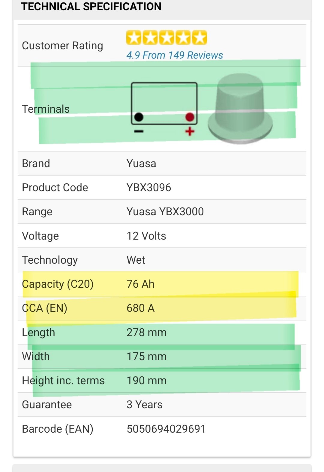

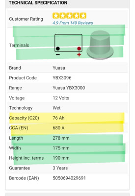

This is my opinion, the information in green is very important, the yellow, however, is not so and should be thought of as as minimum. Being a Diesel, I would buy one with a little more CCA (Cold Cranking Amps) if possible, as it could be usefull in the winter, if you can.
Stu

Re: DS5 battery mismatch
Yes I agree there Stu which is why I went for the 5096 to get an extra 40A cranking
