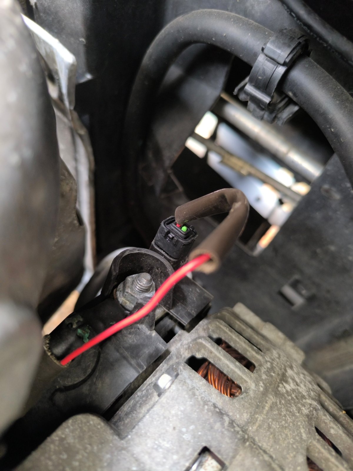

Hello Guys,
I've been struggling with getting this issue solved, been to lot of local car electricians, only thing that they've said was let's replace the alternator,
but something there is not looking right to me. The alternator is charging at proper voltage 14.3-4, but when they connect it to a diagnostic tool they can see fault in
alternator to ecu communication. There's no check or fault showing on dashboard.
Is there something missing here?
Here's a photo of the connector to the alternator, I am seeing there's only red wire here, and there's no green one, is this how it should be on this model, or someone has done something incorrect in the past?
Any thought will help,
Thanks in advance to all who've read this.

Re: Citroen C3 1.4i 2005 - Alternator Permanent Fault
It is normal for the green wire to be cut off, if you open up-the alternator you will find that pin isn't connected to anything.
I have the same problem. It's some sort of looseness in the connector for that single wire. I can unplug it, jump across the gap with a test lead, and the fault can be cleared. That wire is a single-wire linbus connection.
(if jumping the connector doesn't resolve it, there's probably a break in the wire somewhere, check it with a scope.)
It's not a -major- probem, other than the alternator stops being smart and outputs all the volts all the time.

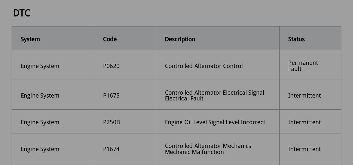

Hello guys, thank you all for replying on the subject, I am sorry I was not replying, I was waiting for the scanner to arrive from AliExpress it took 3 months, now I can finally see on my own what is going on
These are faults Alternator related
And yes it is charging good, bit on higher side, I am worrying if this maybe can cause innacurate sensor readings and what not, thats why I want to get it fix.
