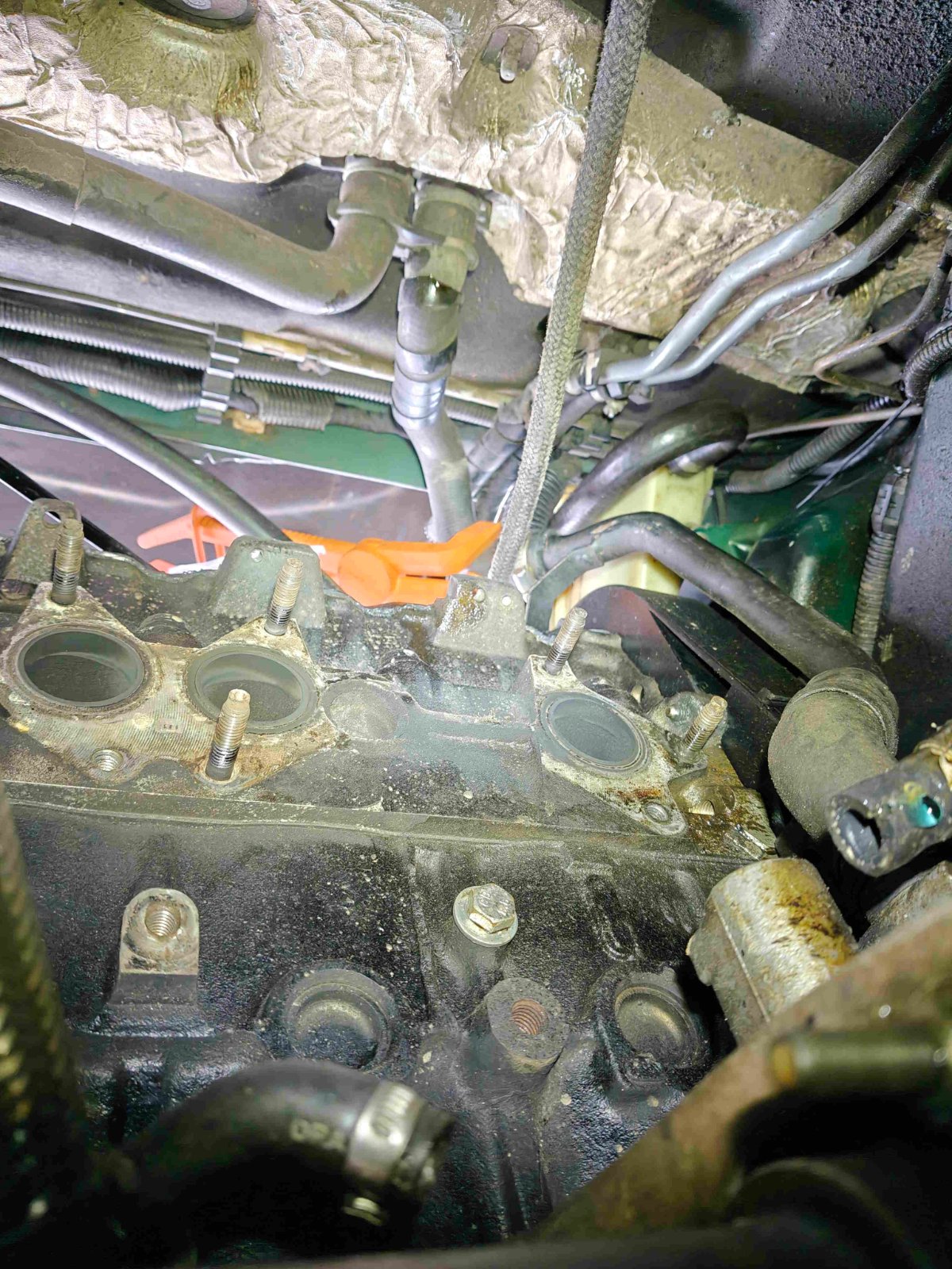

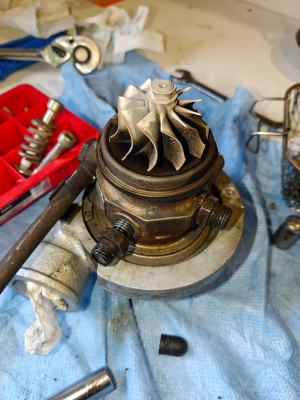

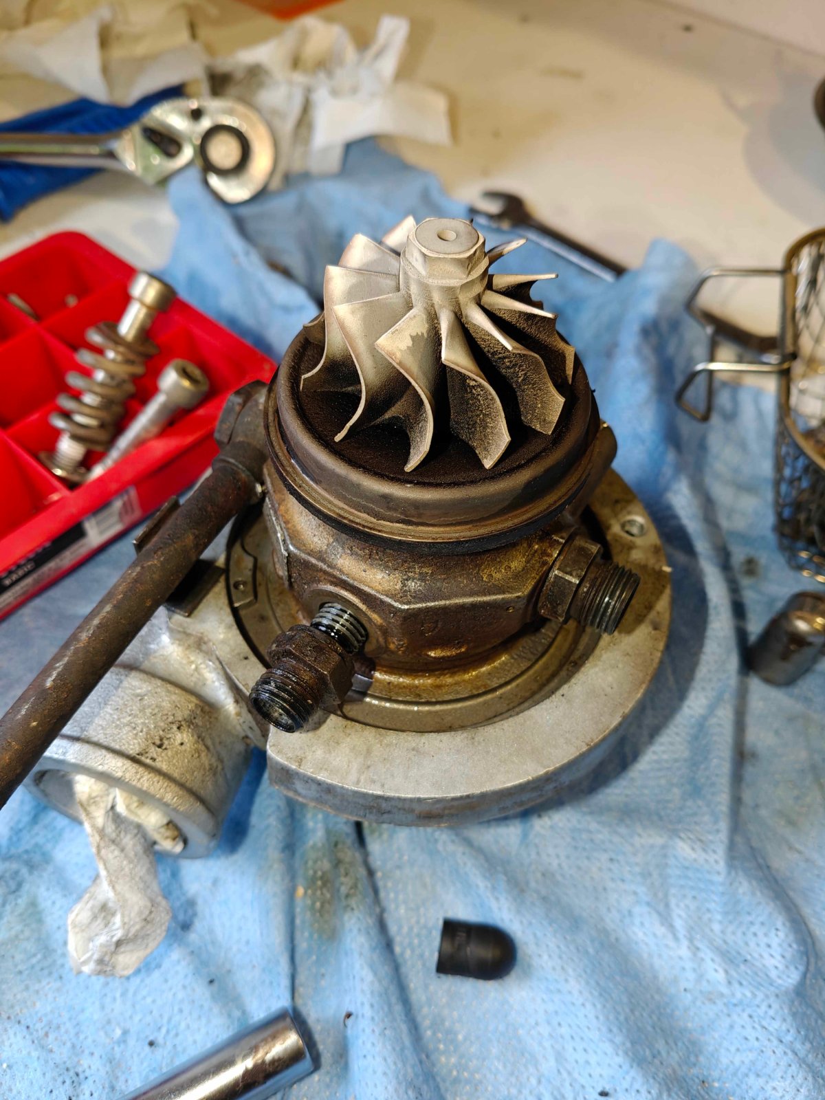

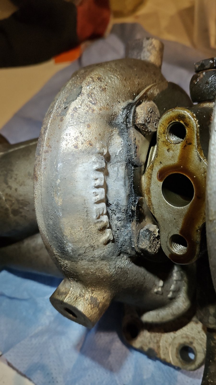

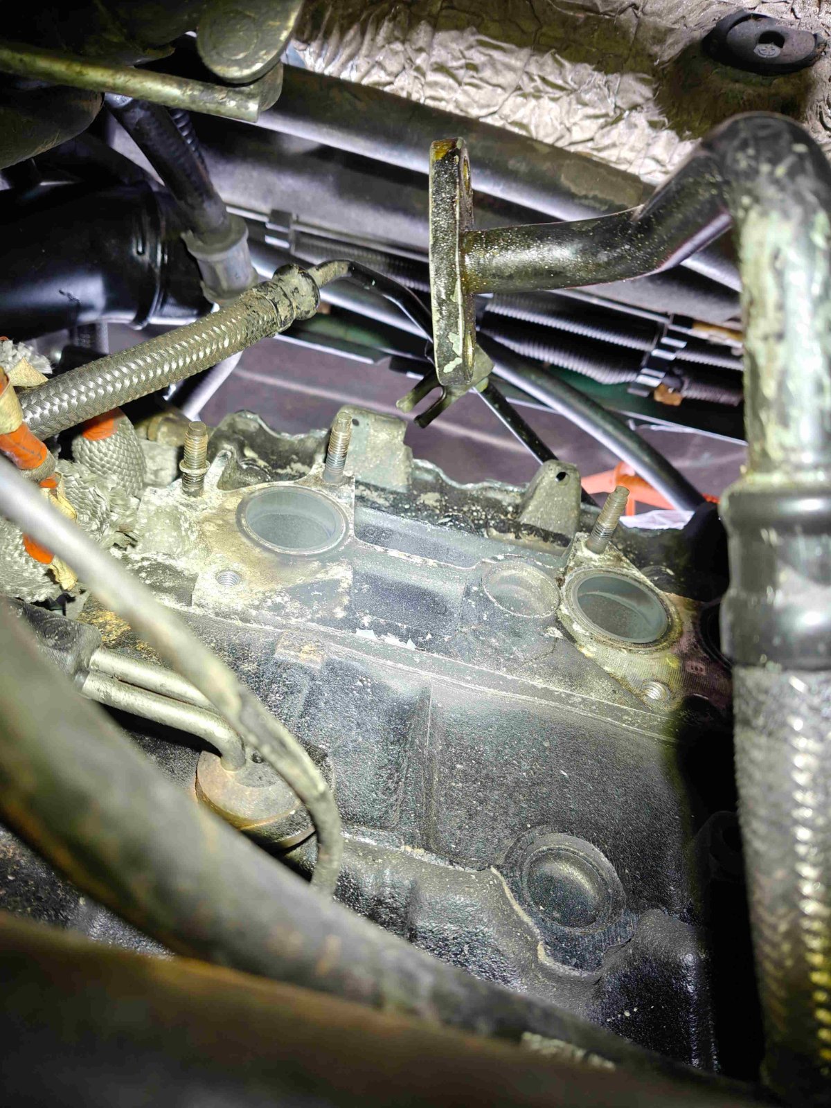

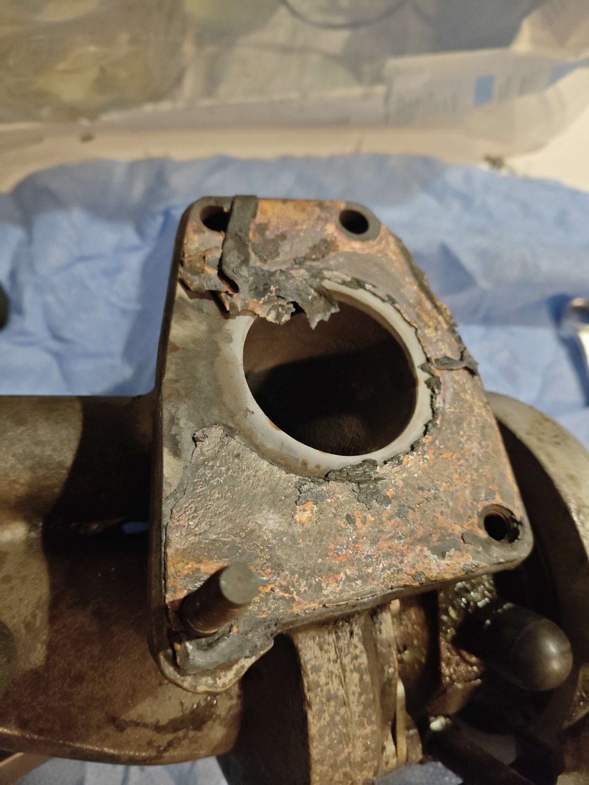

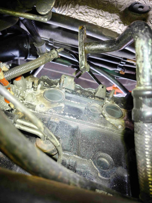

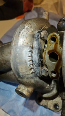

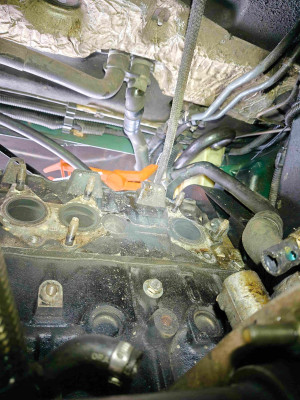

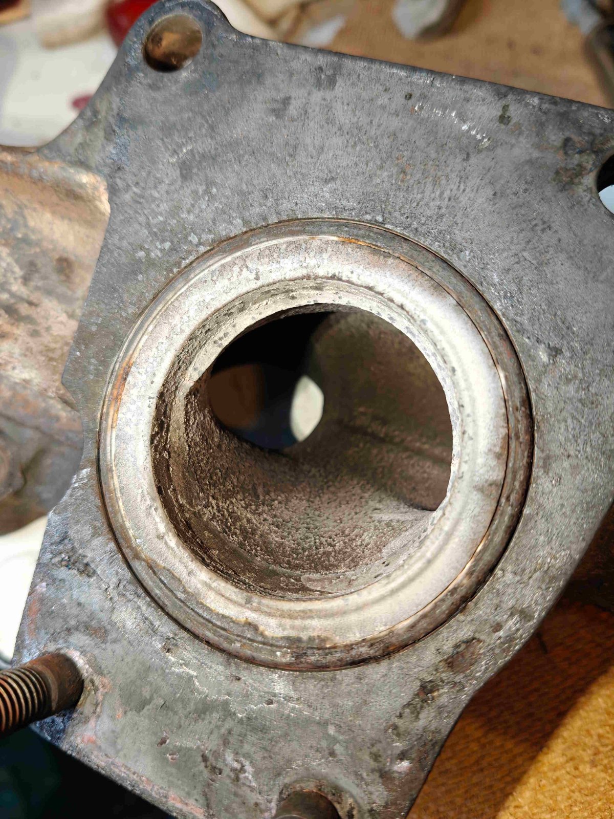

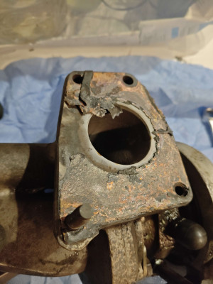

In the photos you can see a chalk?like white residue on the turbine housing surface that has leaked through the sealing surface. There is also some of this white deposit on the turbine itself, and all the way on the backside of the exhaust manifold. But I don’t think I see any of it in the exhaust ports of the cylinder head?
When I removed the turbo, I suspected an internal coolant leak in the CHRA, but I couldn’t see any obvious signs of it, and blowing air through the water channels with soapy water didn’t make any bubbles.
At this point I’m no longer sure whether this white residue is burned coolant, or something caused by running rich/lean.
Continuing that thought, could this vapour simply be the result of combustion itself?
In one of the pictures the turbo-to-manifold gasket is completely destroyed. That normally leads to incorrect oxygen sensor readings, which then affect fueling. But could this much vapour really come from just that?

Is it possible the exhaust has simply filled up with snow/rain over winter and somehow got into the other parts and frozen breaking stuff ?
Was the new turbo actually new or a used one ? I had a Saab petrol and the turbo failed and that surrounded the car in white smoke as it was burning oil. An egr valve problem can also cause smoke, these are fitted to petrol engines as well as diesels so something to check. You can also check for oil in the intercooler.
Have you checked if the coolant level is falling as another sign of a coolant leak ?

The turbo was most likely a refurbished one as it doesn't have a numberplate. There is a noticeable ammount of oil in the inlet tubes, but this is most likely due to PCV venting.
The vapour does not smell like oil at all, and I think I mentioned that it had filled the middle muffler with a bunch of water. There wasn't any oil residue, burnt or unburnt in the turbine housing or further.
The coolant level has always been inconsistent which is why I did suspect that the turbo was burning it, however a Exhaust Gas Indicator test didn't show signs of a head gasket failure.
This particular model doesn't have an EGR valve. One is referenced in the service manual but it could be a translation error as the component they make reference to is a Boost Control Valve.
