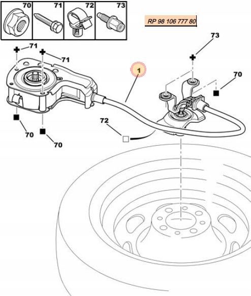

Do you know if it is possible do use a winch under the chassi for the spare wheel? I found this part number 9810677780 for Citroen/Peugeot winch, but i am not sure if it is compatible with the new C3 aircross.

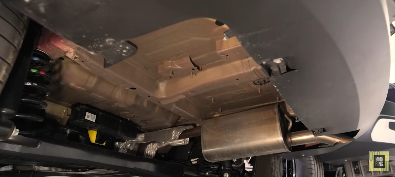

If you go to the configure car bit of the Citroen uk website it shows the option using the well under the boot floor so I doubt there is room for a winch. Normally there is a big plastic wing nut style device to keep the wheel in place, if you have a big accident you don’t want a wheel joining you in the drivers seat. It should be relatively easy to sort something out with a bit of diy. Remember you will need jack and wheel brace, and likely a “thingy” for getting any decorative caps off the wheel bolts.

That is with the spare wheel predisposition option, since i don't have that option, the floor boot is flat (see image attached). That is why I was concidering a winch. I saw that under the floor it has two screws in the middle (73 in the image) and a hole covered with some kind of tape, that looks like the hole for the thing that turns the winch and also some holes for the winch screws (71 in the image). I am just not sure if this is the right winch (part Nº 9810677780), and thought that someone has already done it.Richard_C wrote: 14 Mar 2026, 17:57 If you go to the configure car bit of the Citroen uk website it shows the option using the well under the boot floor so I doubt there is room for a winch. Normally there is a big plastic wing nut style device to keep the wheel in place, if you have a big accident you don’t want a wheel joining you in the drivers seat. It should be relatively easy to sort something out with a bit of diy. Remember you will need jack and wheel brace, and likely a “thingy” for getting any decorative caps off the wheel bolts.

Basically, there's no solution from Citroen. I'll have to take the risk and buy the winch and see if it works.
