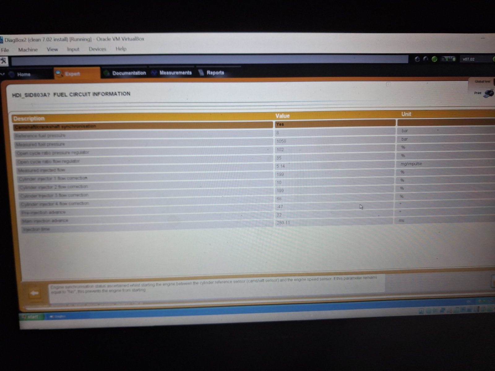

I've just moved my diagbox to a new laptop, and it's not been an easy experience ! Tried connecting to the van and diagbox indicated it couldn't identify several ECUs. Not sure why.
I picked SID803 and RHK for the engine, which i think is right. The injector corrections look very odd though. They show 199, 10, 199, 68.
Of those, I think only the 68 is in the normal range, based on the message at the bottom of the screen when i clicked on one of them ?
Might explain a mid range judder i guess ?
Dispatch 2.0 hdi injector corrections seem wierd

Re: Dispatch 2.0 hdi injector corrections seem wierd
Unfortunately the picture is too fuzzy to read. Could you post a clearer image, maybe a direct screenshot?
Sorry, working away from home at the moment. The correction values are 199, 10, 199, 68.
The crucial question is, are these values reasonable, or are they crazy, related to the software inability to identify the ecu ?
Tim
