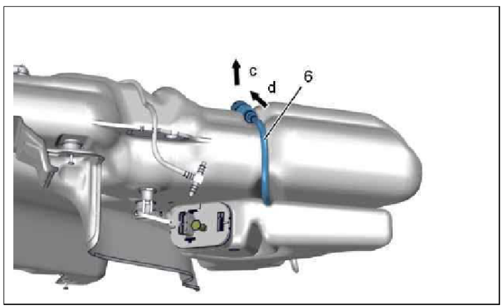

Dear colleagues,
I need to replace my Eolys tank because the additive pump is throwing an "open electrical circuit" fault. I am currently stuck trying to remove the old tank. One of the hoses (Air vent tube 6 in the diagram) runs above the diesel tank and becomes inaccessible. I cannot reach the connection with my hand, even after lowering the diesel tank by approximately 5 cm.
Does anyone know the trick to reaching or disconnecting "Air vent tube 6"?

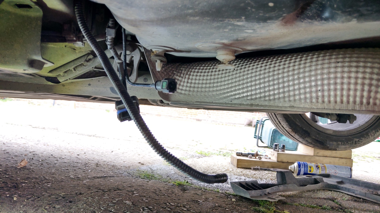

I had the same problem as you and gave up trying to disconnect from top of fuel tank - as you say, it's not accessible even after lowering the fuel tank as far as possible without removing the exhaust.
I left the pipe attached above the fuel tank and just pulled it off the nipple on the EOLYS tank instead(then refit is reverse of removal, as they say).

thank you for your reply! You are right, the tank hangs now on the exhaust. I think your solution is THE WAY TO GO! At the end the pipe is only the air vent. I will check, how snug the pipe sits on the old nipple. Hope it will stay tight enough...

And now the proper solution with the Air Vent tube Nr. 6:
It was easy as...
Just remove the Eolys tank from the fixation points and move slightly towards the air vent tube. Push the tube upwards and it slides easily out from the protrusion in the diesel tank.
But the method by Iain is a very functional workaround, if anything fails.
It was easy as...
