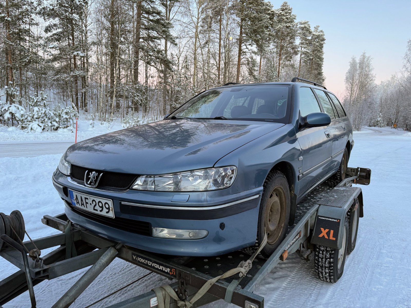

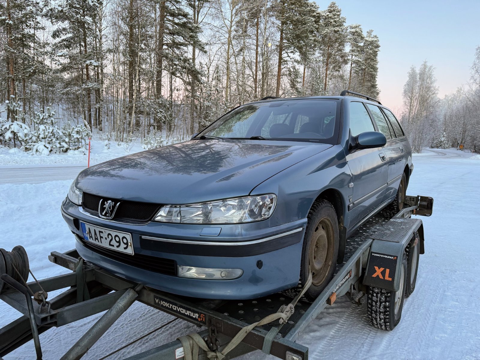

It's a 2003 Executive with only 135.000km (~84.000 miles) on the clock. Half leather seats, basic CD player, auto A/C... this is how the Executive was spec'ed for the Finnish market in 2003. No optional extras as far as I can tell. The reason why it's on a trailer is that the timing belt was 14 years old at the time of purchase. And NVM the rusty steelies, it came with 16" Ouragan wheels too, which will get winter tyres on them very soon hopefully.
The belt has now been replaced together with the water pump. Old parts looked good after doing only about 45.000km, but I didn't want to take any chances. There are a few bits that need attention, but I'll get in to those later. There was some surface rust in the floor pan rearwards of the fuel tank, but the sills seem to be intact. No idea how they look on the inside of course...

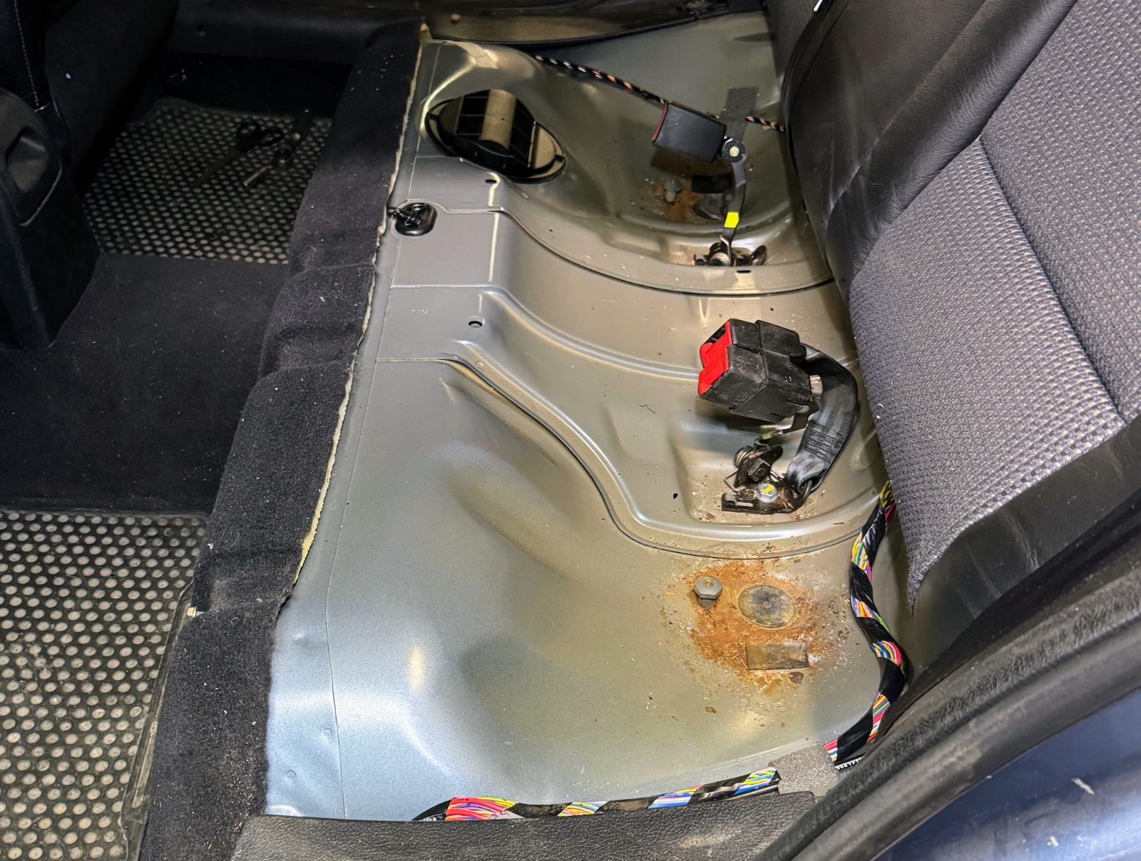

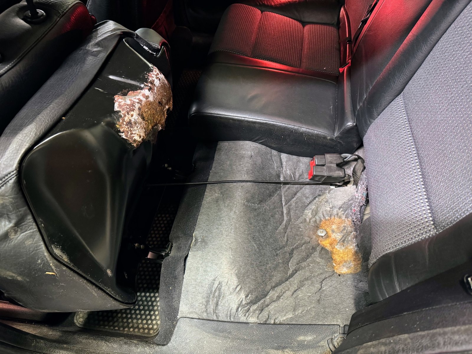

A bit surprisingly (to me at least) the worst corrosion damage seems to be under the rear seats. When I opened those loose plastic plugs on the floor, there was a sand up to the floor pan on top of the tank on both sides. Weird construction. I'm guessing the loose plugs let in water from below, and then the dirt and sand below and the sound insulation on top keep it nice and moist...

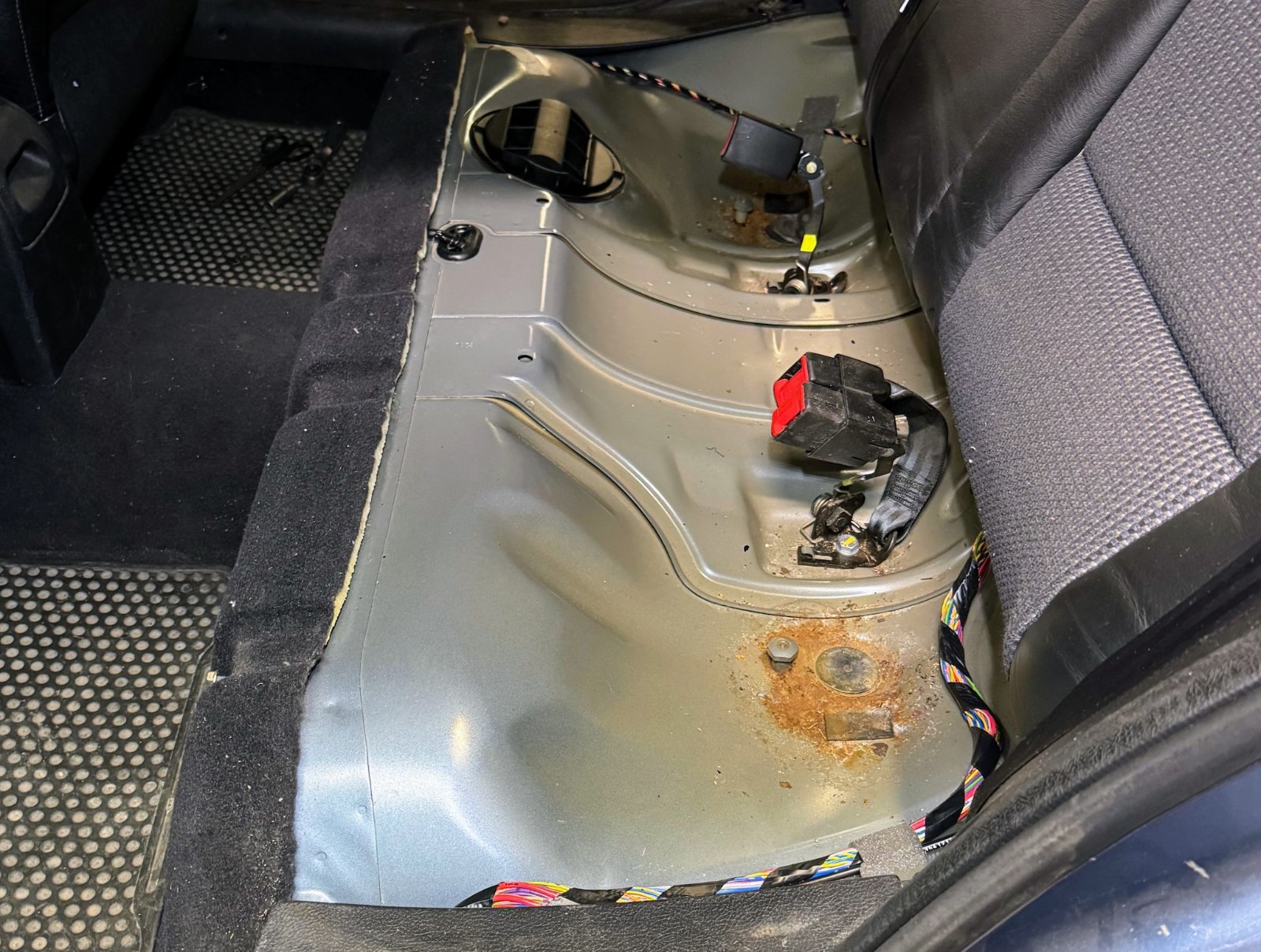

Interesting the differences in spec between countries, of ostensibly the same car.
I've seen corrosion in that same general area on mk1 C5's as well (similar design).
I felt it came from underneath, rather than above.
