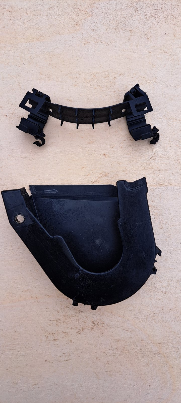

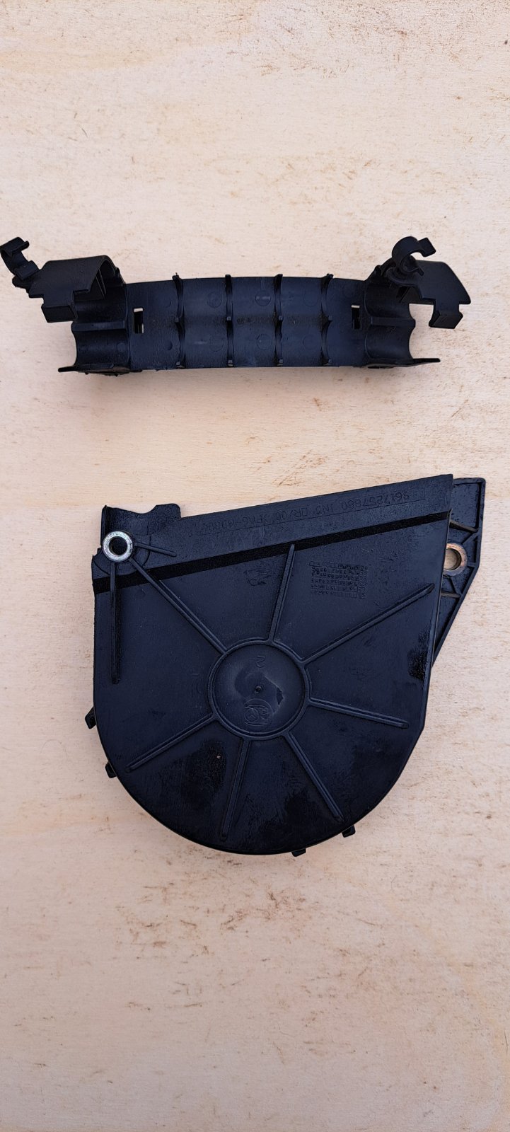

However, it was only when I got the car home that I noticed these two items in the passenger seat footwell (see photos), at that point I could feel my BP raising and the last thing I needed was to drive back there and get into an altercation with them.
Now my mechanical knowledge of cars may be limited, but even I know, having looked at that 'cover' piece that it seems whoever called me wasn't talking about the cambelt at all but some other sort of belt.
The other piece appears to be something that holds pipes or tubing in shape.
So if any of you guys recognise these bits, and therefore the likely part they were actually referring to instead of the cambelt, that would be greatly appreciated.
Cheers
I've now gone and collected the car and have it back home. I was steeling myself for a confrontation but in the end there was no push-back on their part or trying to convince me to have the work done. I didn't really say anything or question them, I just wanted to get the car and get out of there.

The bottom one is cambelt top cover. I wonder where the bolts are.
Top part looks like something that might hold a wiring loom.
I've PM'd you.
I've PM'd you.

But why the heck do the garage go anywhere near the cambelt and remove the covers? Very worrying behaviour. I'd be having a very stern discussion with them.

I've been to see JoeNinety and had a look at the belt. There is some micro-cracking but it is really minor it is hardly noticeable. You have to catch the light right.
Took it for a drive and there are no unsavoury noises. The car drives like an absolute dream. Much better than mine but then the suspension has been done in the last couple of years.
The tension seems OK but IIRC the longest run is to the front of the camshaft and not the rear of the engine so you cannot really get your hands in.
The throttle cable was perilously close to being scored by the cambelt. Fancy leaving it like that! Negligent.
A little bit of the usual rot on the offside front of rear wheel arch in the door shut. Didn't look at nearside.
