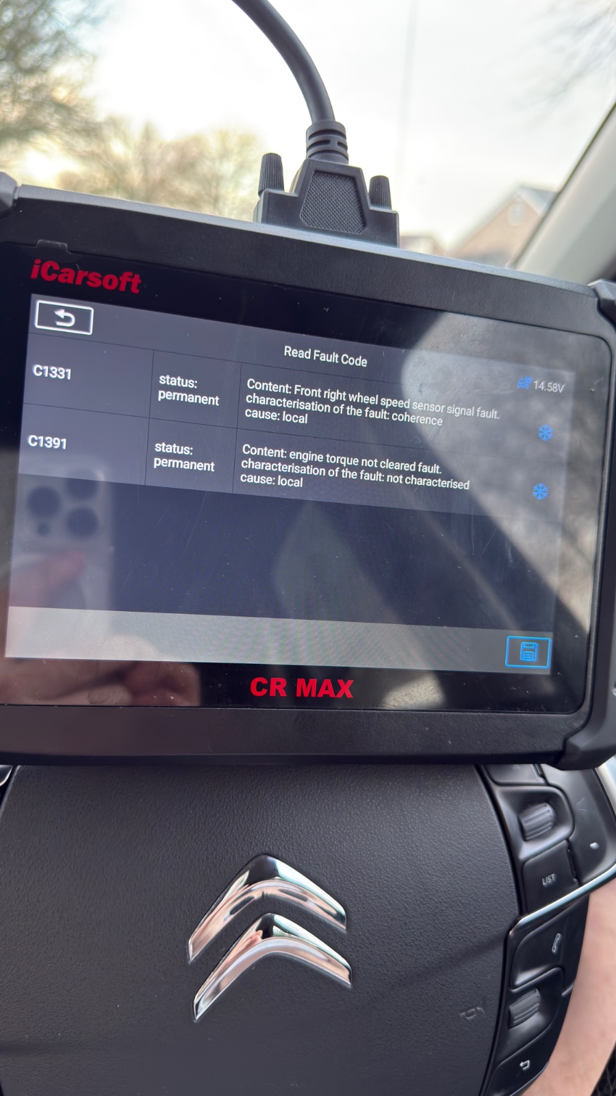

Hopefully somebody can shed some light on this issue I’m facing. I have a 2012 1.6 Citroen C4 which has developed an ABS fault. I had the same fault but on left side a few months back and fixed it by replacing the sensor. So I thought I’d replace the sensor on the right hand side but fault was still there. So I proceeded to change the ABS ring and the fault is still there.
I’ve attached a photo of the faults from the diagnostic machine
It seems to be reading the speed from front right sensor okay..
Because of the faults the car is off the road as it’s undriveable as the fan stays on after the engine is turned off as well and it drives awfully.
Does anybody have any ideas what I could be? I don’t think it could be wiring as it’s reading the speeds correctly..

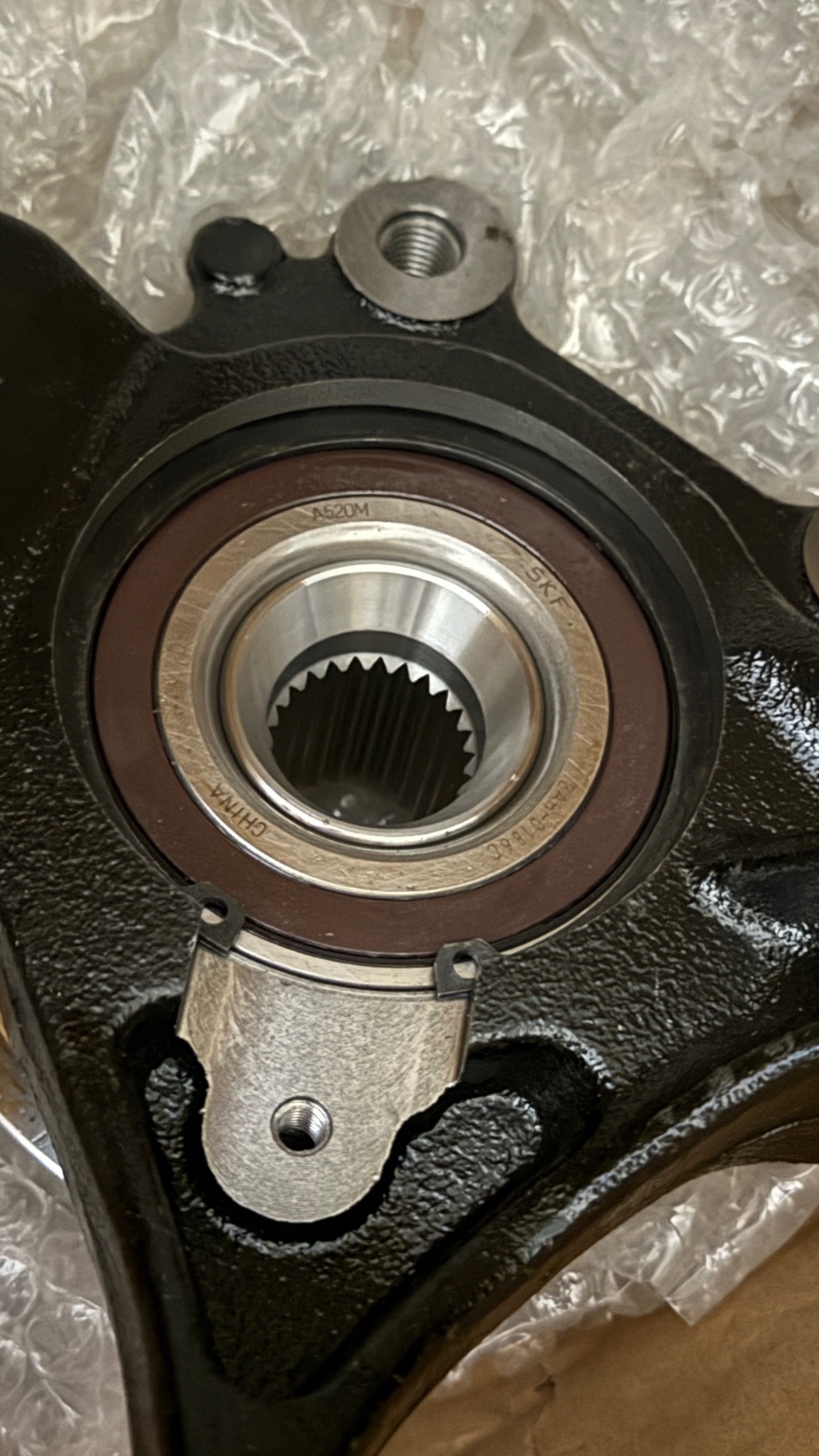

So I've replace both parts with a Febi one so not a genuine but a well known brand. The left side fixed itself easily enough but I'm having nothing but issues with the right hand side.
Replaced the full hub rather than just the bearing and replaced the sensor so I'm at a loss. Surely it can't be wire related if it's reading the speeds fine??

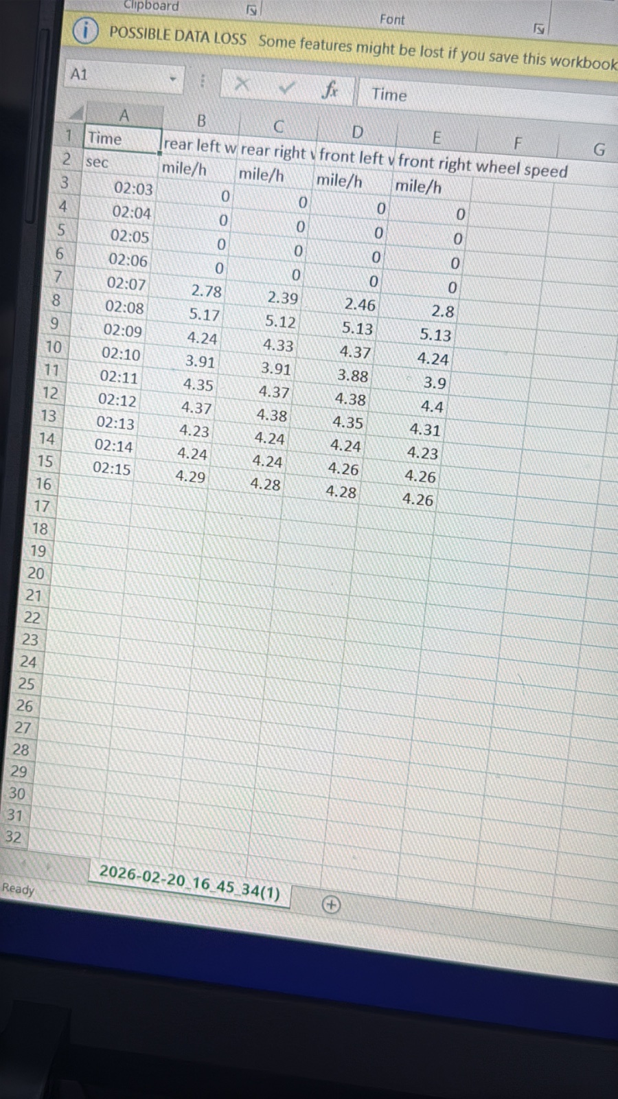

Have you had it on the road and done a live data? I’ve seen everything running fine for a half a mile and then all of a sudden a wheel speed difference occurring. Had a Citroen one time with broken wires at the rear on the axle but all looked fine until I stripped down and found corrosion on the wire. It still gave me reading but on test route it read differently but still would correct itself (but lights on dash stayed on). I just wouldn’t rule wiring problems out but this sort of thing could drive you nuts. Does the light come on as soon as you start the car or does it only come on when you drive it ?

I haven’t done a live data run whilst driving, how would I go about that as my machine doesn’t let me over 10mph. Someone on Facebook has mentioned diagboxStevieE wrote: 20 Feb 2026, 19:53 Have you had it on the road and done a live data? I’ve seen everything running fine for a half a mile and then all of a sudden a wheel speed difference occurring. Had a Citroen one time with broken wires at the rear on the axle but all looked fine until I stripped down and found corrosion on the wire. It still gave me reading but on test route it read differently but still would correct itself (but lights on dash stayed on). I just wouldn’t rule wiring problems out but this sort of thing could drive you nuts. Does the light come on as soon as you start the car or does it only come on when you drive it ?
