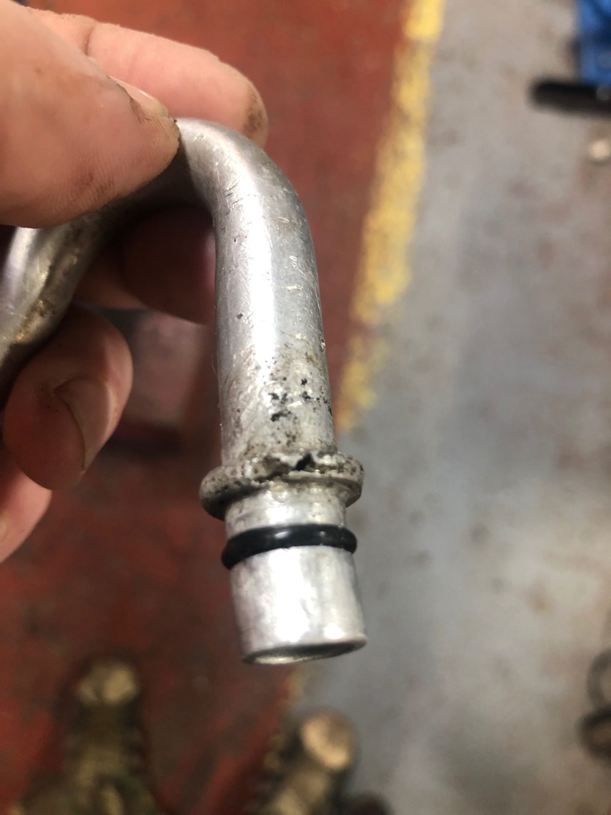

The garage tells me my trusty and much loved C5 (Exclusive 2.0HDI Estate 2006) (VIN VF7**************[VIN obfuscated, can be read by forum staff]) has a leak from the low-pressure power steering pipe. Apparently a corrosion crack in one of the metal sections.
Is its possible to repair this (alloy) section of pipe? Has anyone found a source? Is there a supplier out there who can make up a new pipe, possibly using the end fittings which are supposed to be ok? It's just a hose!

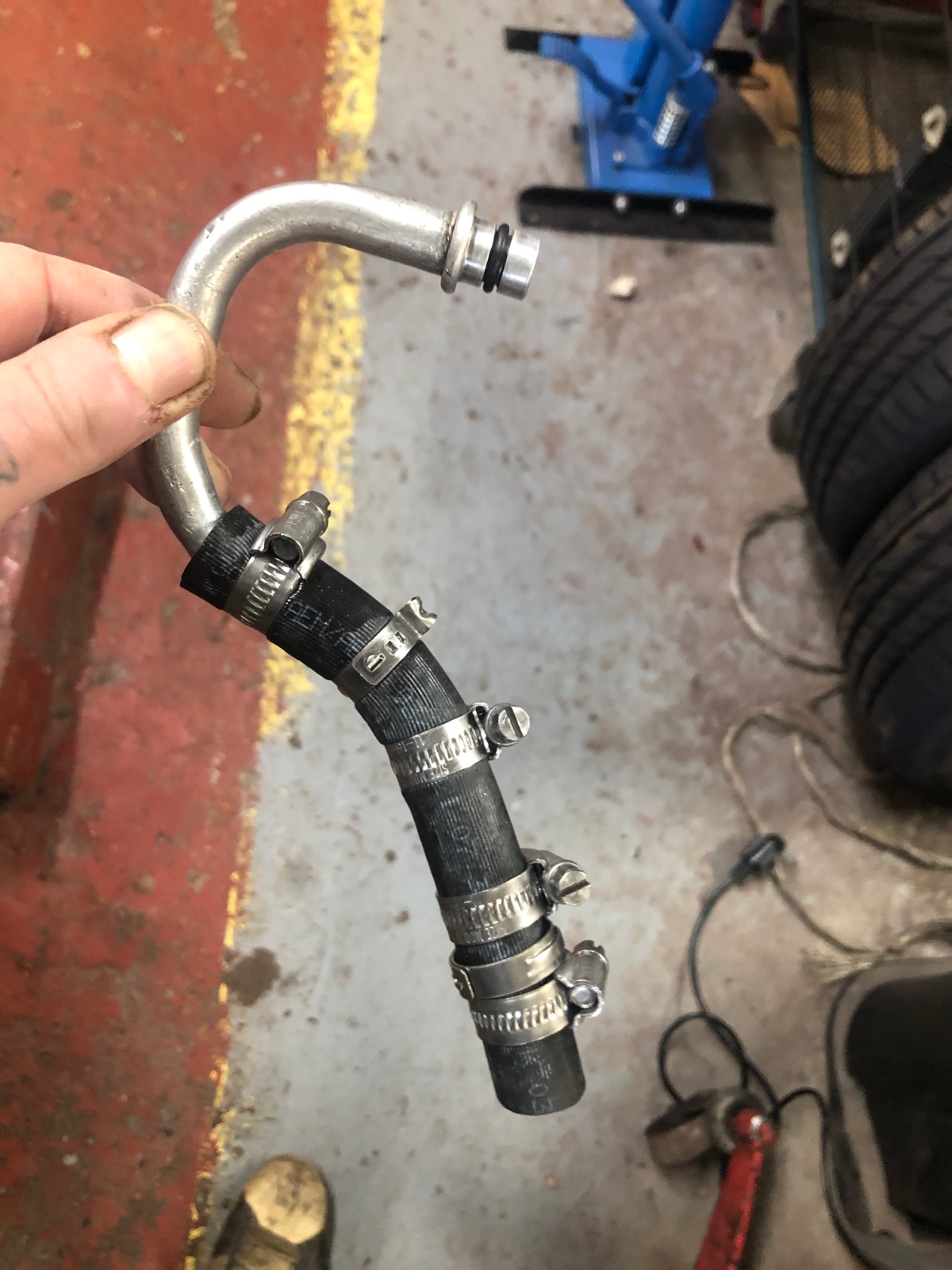

I feel your pain, I’ve had exactly the same on my c5, 2008.
I did repair it using a similar pipe from a berlingo, the berlingo has exactly the same end but is only about a foot and a half long, I chopped off the cracked section of mine and spliced the new piece on with a high pressure rubber pipe and pipe clips. It’s a bit Frankenstein but it has been ok for well over a year now. It’s seems that fixing them like this is our only option as new pipes are not available at all.
To chop off the old pipe the only option really is a copper pipe cutter as that’s the only way of chopping it without swarf getting into the system, plus when the pipe is still on the car there really is at any way to get ant type of grinder or saw to the pipe.
Pirtek and similar pipe manufacturers may help but I think they can only do it if you have the correct ends to work with.
Taking the whole pipe out and replacing it is a major task and getting a new pipe in without bending it is near impossible

I had this. The corrosion occurred where the return pipe passes just in board of the front left wing. Annoyingly, the corrosion (and leak) was disguised under the sheath of foam rubber intended to protect the metal pipe from stone impacts. Unfortunately, the sheath promoted the corrosion. I got an equivalent piece of rubber hose from some other scrapped car and spliced it in. I used the original style hose clamps, rather than jubilee clips, so that it would look original. It is the low pressure return piping so jubilee clips should be OK. Took me a couple of hours on the drive with front on axle stands.
