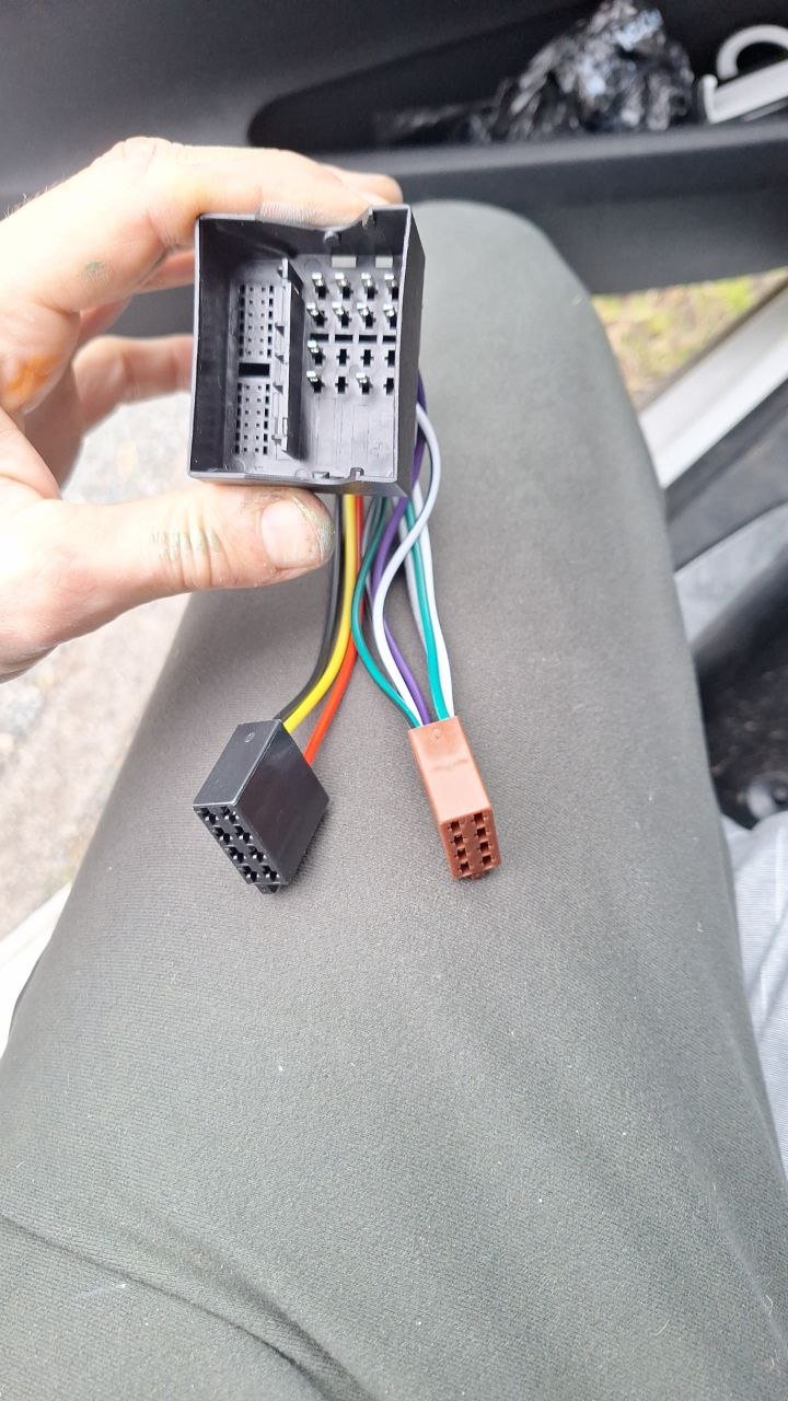

I just bought a new car radio for my citroen DS3 (2009 -2010) , it's a Pioneer mvh-s520dab
i tried 2 cable ISO adapter supposed to be compatible but not !

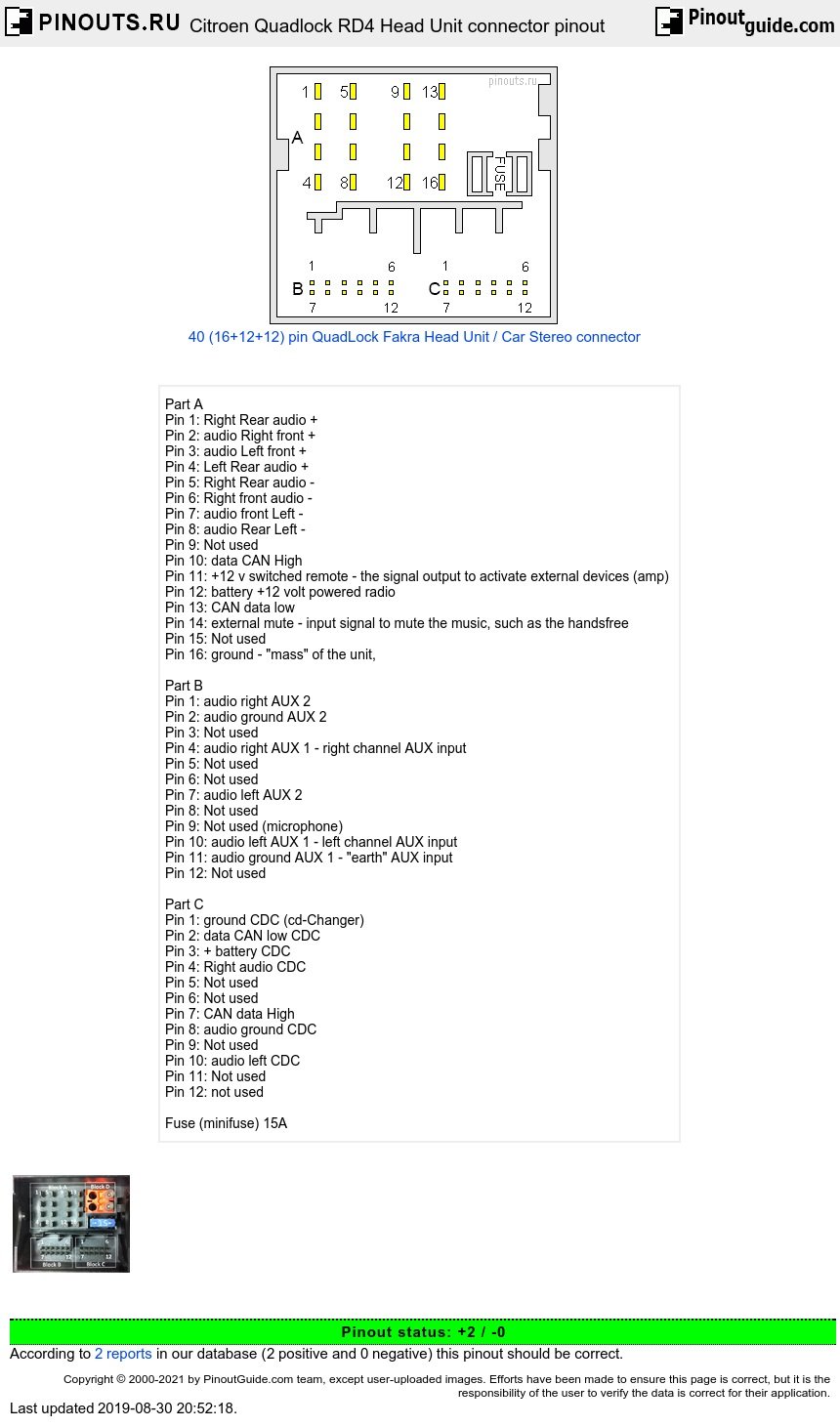

I'm looking for the wiring diagram of the car radio socket to make the adapter myself ( i need to know where the yellow and red wires goes )
can you advice me where to find the diagram ?

This is the DS3 audio diagram from Citroen Sedre backup: :)
DS3 audio.pdf
copied from Sedre backup
(1 MiB) Downloaded 94 times
You may need to refer to the guide in the link below to help to understand it
viewtopic.php?p=782862#p782862

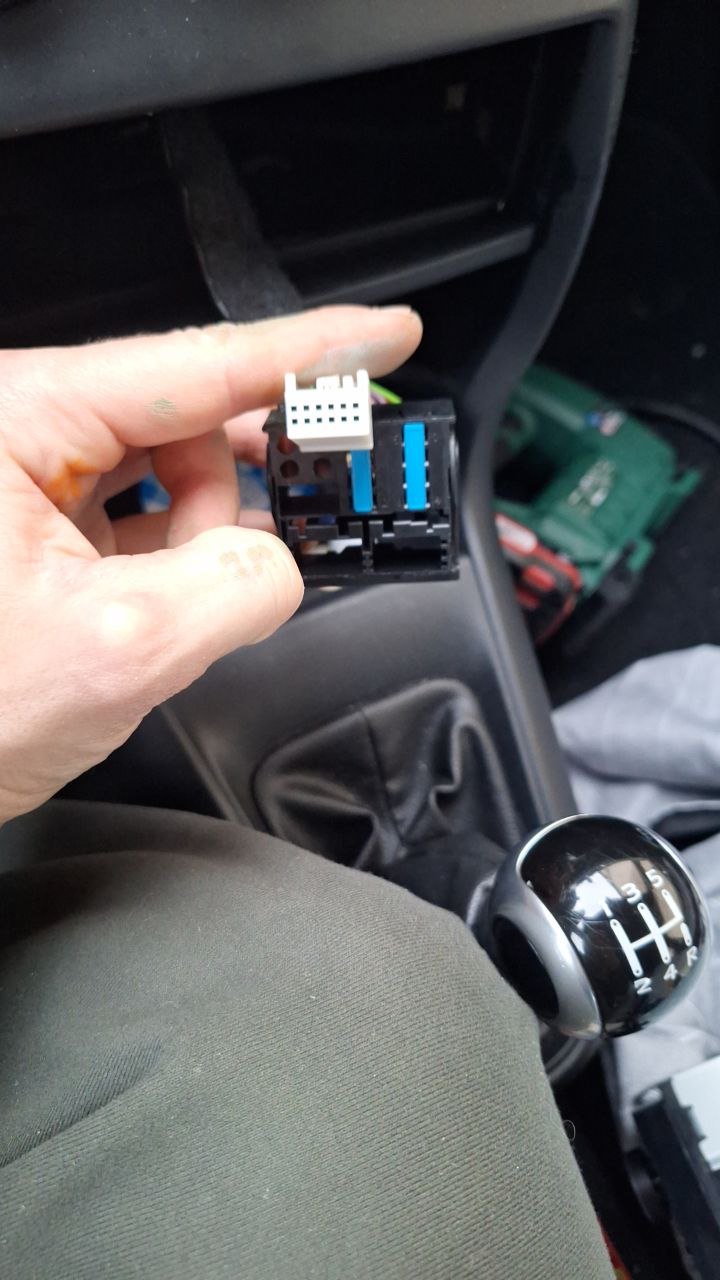

sorry but the file is hardly readable , i would like to match those connectors below

I think the yellow wire is not where it should be

i think i found what i'm looking for
