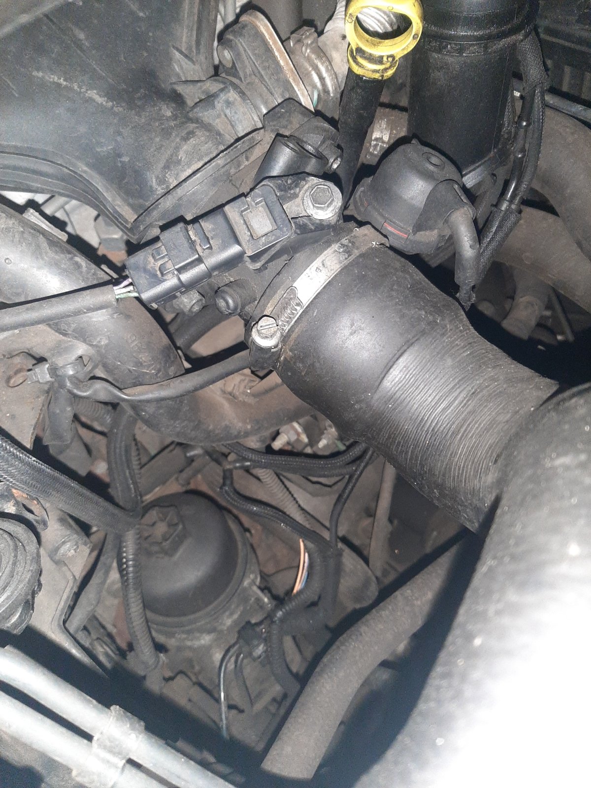

Hi everyone,
Cut a long story short,had to go do some work in oxford,Anyway van was running fine before, (dispatch 2L 2008 lwb)
The roads are a 3rd world country,potholes everywhere,some are so wide I would say dangerous,
Anyway started to get a knock sound especially on start up,will try add the sound)
Looked on various forums,some say coolant temperature sensor but can't find it,
Others air intake temperature,don't seem to have it on my engine,( after seeing a video) but there's one below it but nothing attached inside the hose,
Also since being here ns tyre needs pumping up every 2 days( not sure if that coincidence or not, been to tyre fitters couldn't find a problem with the tyre,,
Was OK before,seem I can't add video off the noise,
Thanks in advance Ste

Maybe there is an air leak in one of the vacuum pipes or ducting. Can you hear it under the bonnet ?
For the tyre going down, you might have to remove the wheel and wet the tyre, valve and wheel with soapy water and look for bubbles showing a leak. If the tyre is not leaking then it could be a damaged wheel.

PaulC5 wrote: 16 Feb 2026, 12:09 Maybe there is an air leak in one of the vacuum pipes or ducting. Can you hear it under the bonnet ?
Hi Paul C5
When in the cab it feels like it under the floor panel,but under the bonnet it seem to knocking all the engine,
Googling some say coolant temperature sensor can have a effect,on mixture,bought one I believe now its behind air filter housing,
Ait sensor on some models but It seems that on some models it's incorporated into the mas sensor,( I assume)
On the video I seen scudo engine looked the same as mine but he had two sensors, still can't find what that sensor is.in the pic.
As for the tyre took to a fitter, checked it no leaks/air bubbles,changed the valve, day later lost 5psi,went back checked it again resealed it, after doing leak test
