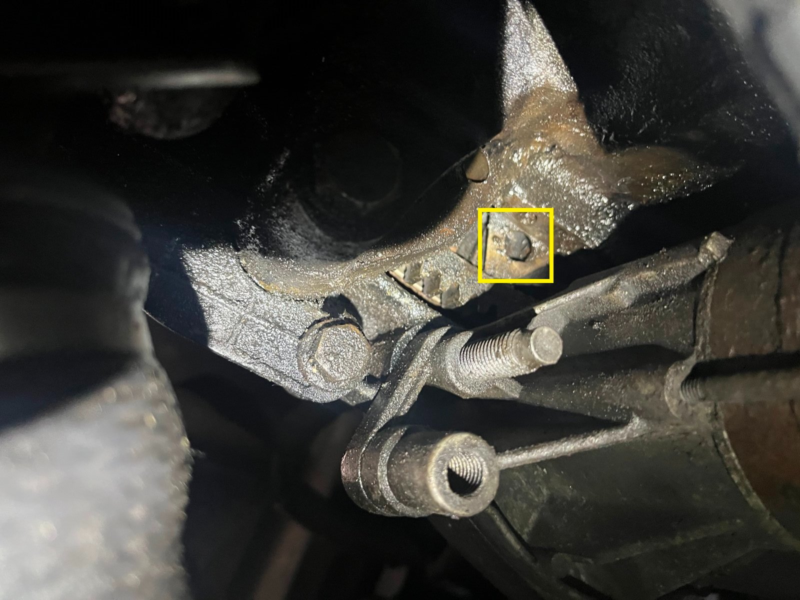

Whoever worked last on this vehicle, successfully f**ed the timing hole on the Flywheel(pic1). I spent hours to try to adjust the crank to the TDC, so i can check the cam position. When i was sure it's on the correct spot, or at least pretty close to it, i checked the cam position which was off by probably a teeth(pic1). Also the arrow on tensioner was way out of its designated position (pic2). The belt wasn't loose, so i thought no catastrophic damage was done.

I'm not sure about this but is the hole I've put in the yellow square the flywheel locking hole?
If so then it looks to me like the flywheel is not in the right place at all?

Yes, thats the locking hole.mickthemaverick wrote: 14 Feb 2026, 14:47 I'm not sure about this but is the hole I've put in the yellow square the flywheel locking hole?
If so then it looks to me like the flywheel is not in the right place at all?![]()
I took the picture before started the whole timing process, because if the flywheel is in locking position, that litle tab is not visible.
