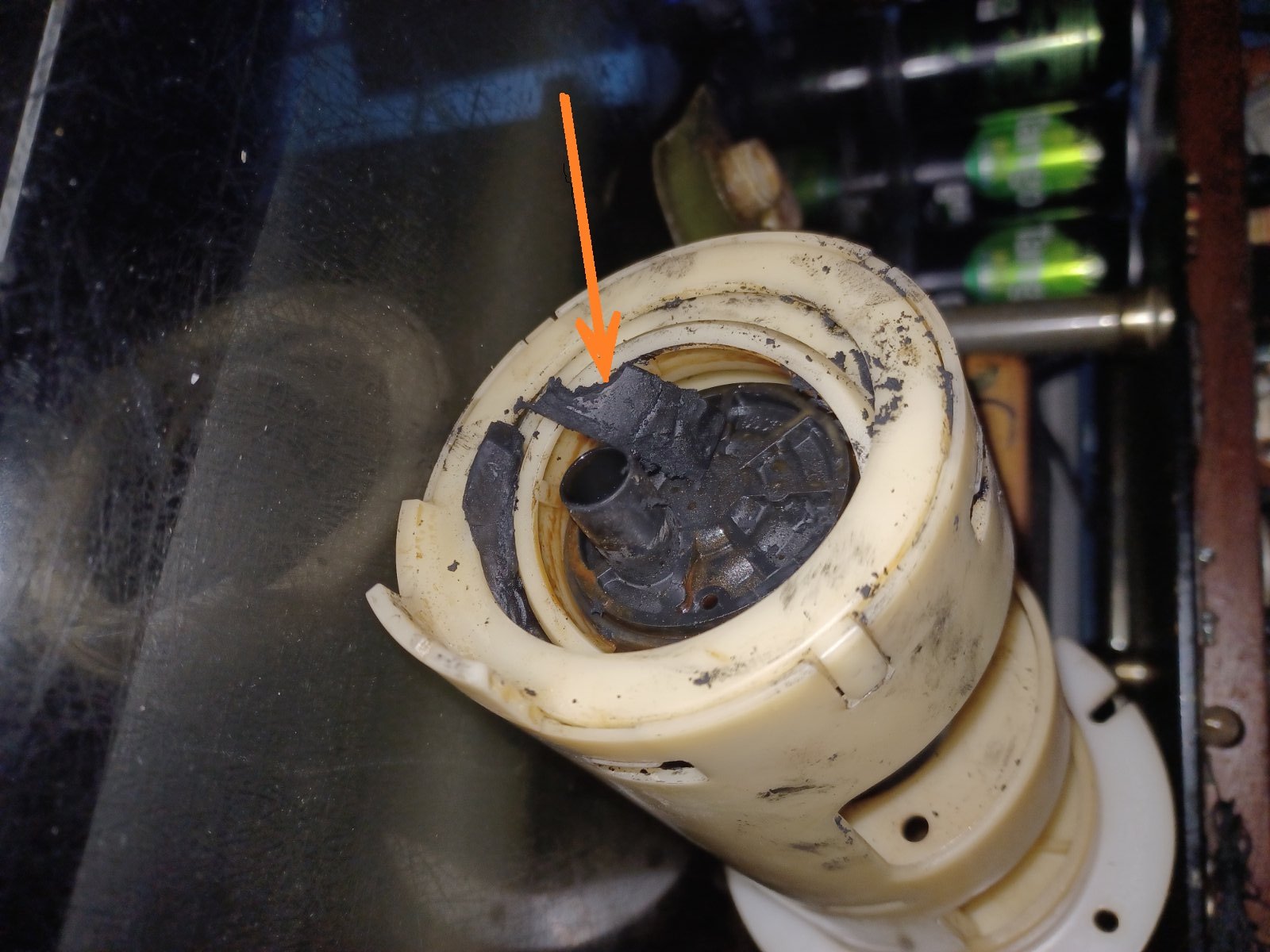

There was a ring of foam strip/rubber around the base of my fuel pump in Betsy the AX.....E10 ate it !
So where can I find some/alternative .... I presume it is for preventing the torque from "swinging" the pump when it starts/runs.

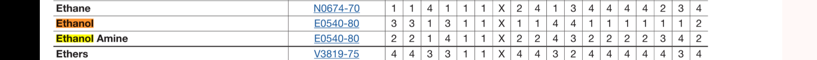

Parker know a thing or two about O-rings:
https://www.espint.com/products/o-rings ... lity-table
The columns are:
Nitrile NBR = 3
Hydrogenated Nitrile HNBR = 3
Ethylene Propylene EPDM = 1
Fluorocarbon FKM = 3
Hifluor FKM = 1
Perfluoroelastomer FFKM = 1
Aflas (TFE/Propylene) FEPM = X
Neoprene/Chloroprene CR = 1
Styrene-Butadiene SBR = 1
Polyacrylate ACM = 4
Polyurethane AU, EU = 4
Butyl IIR = 1
Butadiene BR = 1
Isoprene IR = 1
Natural Rubber NR = 1
Hypalon CSM = 1
Fluorosilicone FVMQ = 1
Silicone MQ, VMQ, PVMQ = 2
And the numbers mean:
COMPOUND COMPATIBILITY RATING
1 - Satisfactory
2 - Fair (usually OK for static seal)
3 - Doubtful (sometimes OK for static seal)
4 - Unsatisfactory
x - Insufficient Data

Just tested with one, O Rings will not work, not thick enough....needs to be a soft rubber strip as ion the photo.

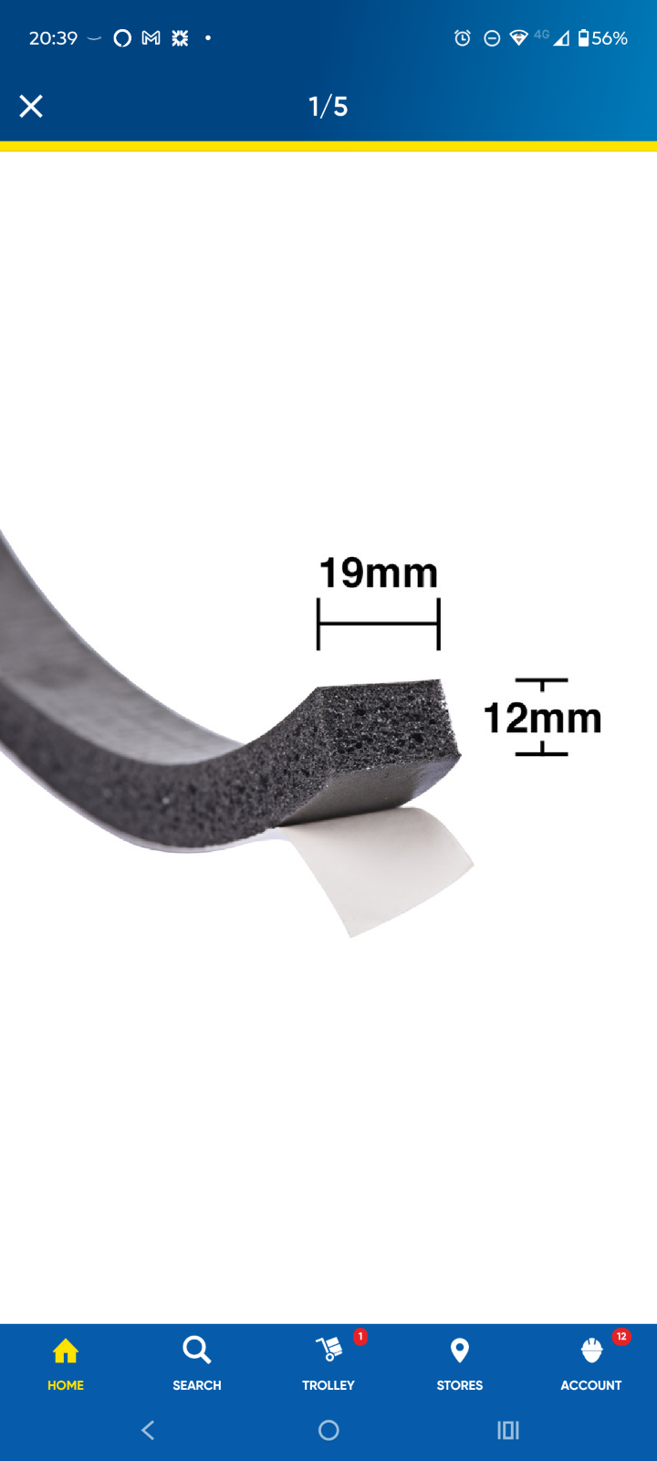

Is it more like this sort of stuff: https://www.toolstation.com/stormguard- ... rip/p95977Stickyfinger wrote: 12 Feb 2026, 19:32 Just tested with one, O Rings will not work, not thick enough....needs to be a soft rubber strip as ion the photo.
- material properties / squidginess ?
(Just an example, think it's neoprene foam = only rated: 1 "satisfactory" in the data above. EDIT sorry, I overlooked that "satisfactory" is the best rating! )

Yes Matt, it looks more like that......TBH it is hard to tell as , as you can see in the photo, it is rather "digested".
I can find Fuel Tank foam but as I only need about 6 inches max.....gerr, I need to think, wondering if some small fuel hose/leak back tube/LHM hose might work.

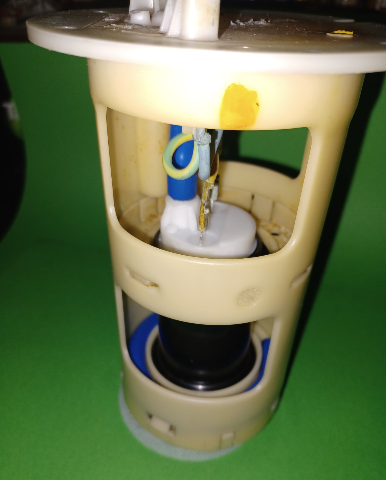

All done.....
I used some fuel safe 8mm air line/pressure hose, split and inserted onto the lower of the spacers (like door rubber trim on a seam), inserted that under a little pressure, fitted the pump into the spacer and pressed on the lower cover......attached the wires with long nose pliers and Bingo, Bob's your Doughnuts , done !
