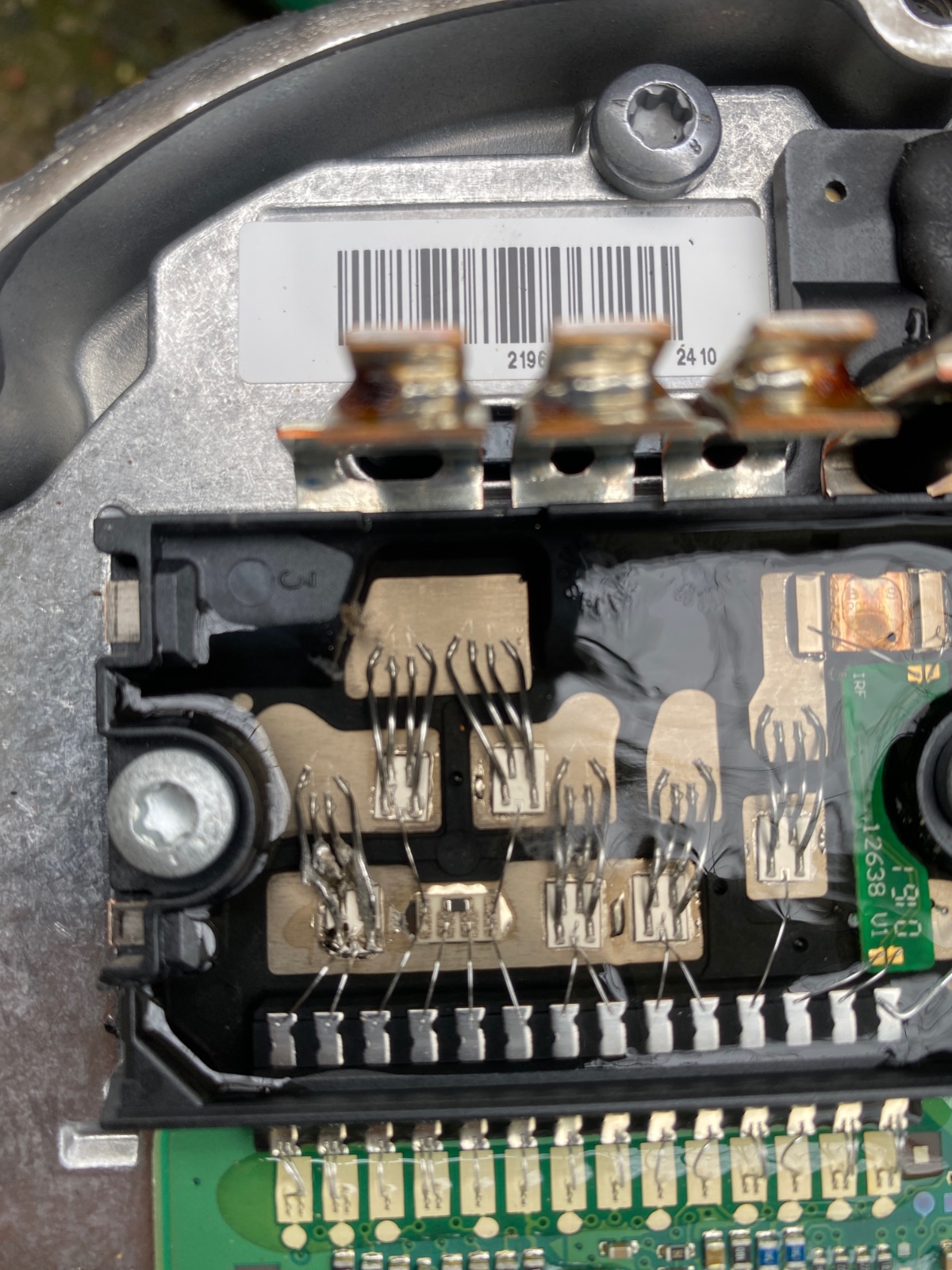

- I took off the steering pump and saw the mosfet wires broken. I sent the pump somewhere to repair it waiting for response whether it will be repaired or not. During this period I bought a second hand same code steering pump. Both has (original and the second hand one) the same code which is 9673017080. I mounted second hand steering pump but there is still fault on the dash. Most probably the ECU of the second hand pump does not match with the car’s BSI.

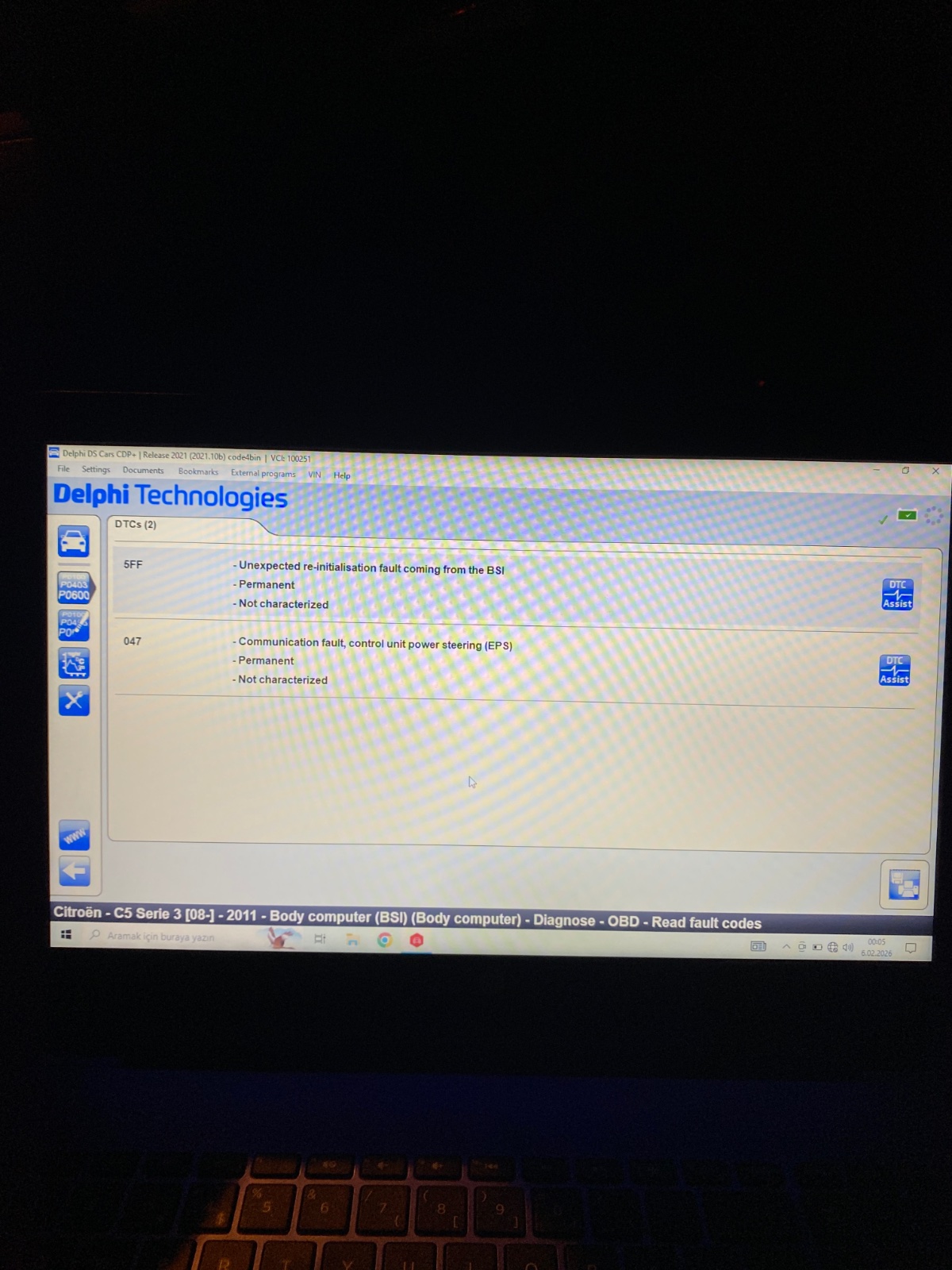

When I conntected the diagnostic tool to the car I cannot reach the pump ECU.

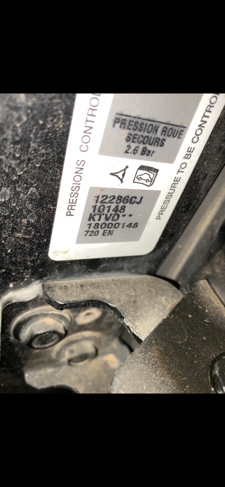

I believe this is the correct diagram for your car but to be certain I need to know that you have electro-hydraulic assisted non variable steering and also your RPO number which is on the tyre pressure sticker on the door pillar. If you think this is the wrong pump come back with that information and I'll have another look!!

VIN is VF7**************[VIN obfuscated, can be read by forum staff]. I will send you the RPO number when I go to the car. I wonder will steering pump work if the plug pins are the same even if the pump codes are different? I think second hand pump was already broken and sent to me intentionally.

I'm afraid we don't have access to the Stellantis database at the moment so I cannot access your build sheet from the VIN. Thus I need to have the info I mentioned to check I am getting the correct diagram.

Here are the informations you have requested. Thanks for your helpmickthemaverick wrote: 07 Feb 2026, 14:41 I'm afraid we don't have access to the Stellantis database at the moment so I cannot access your build sheet from the VIN. Thus I need to have the info I mentioned to check I am getting the correct diagram.![]()

Then that is the wrong diagram that is for RPO 12292 onwards (which was my guess, out by 6!!) and yours is 12286 so I'll have another look!!

I checked the 400828 part number and the advertisements show me 9673017080(TRW A0018267) same with the pump number on my car. The problem is that I can’t find the same number second hand pump in Turkey. Also I learned today, the pump repair service told me that the original pump is unrepairable. Power mosfet blown off. There is damage on the driver.
