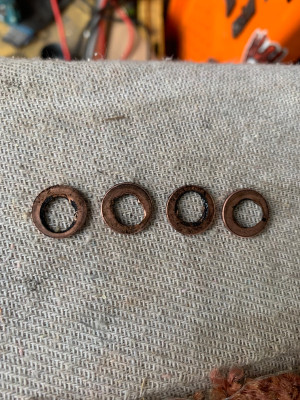

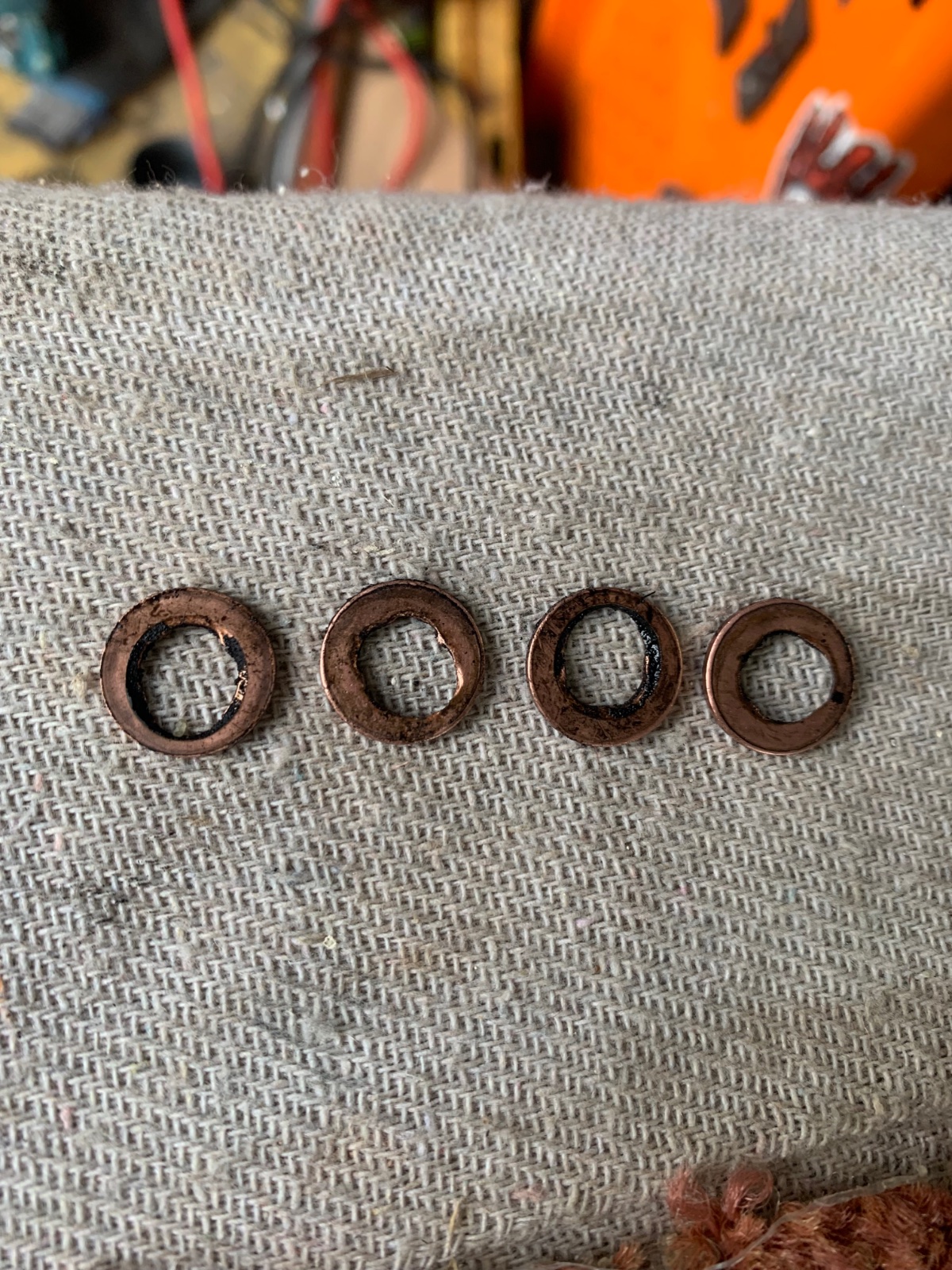

Found blue smoke problem see pic
Can i ask which way crankshaft bolt unscrews pls fitting new oil seal
