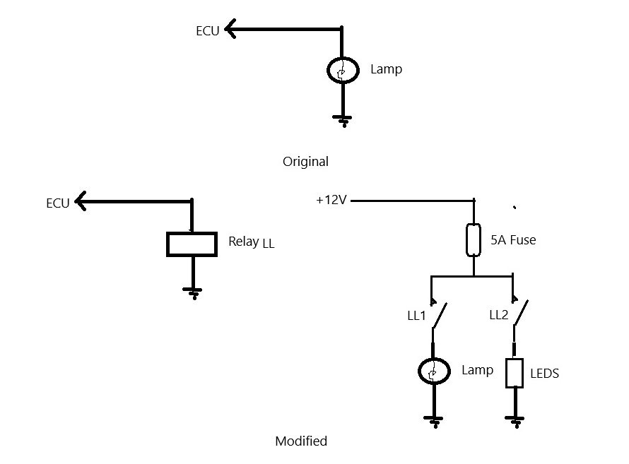

OK. My assumption is that being a modern car the lighting is possibly ECU controlled. If the ECU detects an abnormal current draw it may cut off the supply to the light concerned.
A suggestion which may or may not work:
If you wire in a relay coil to the supply and then connect both the original bulb and the LED via the contacts to a seperate 5A fuse you may have some success as long as the relay coil mimmicks the original bulb's resistance.
Something like this rough sketch:

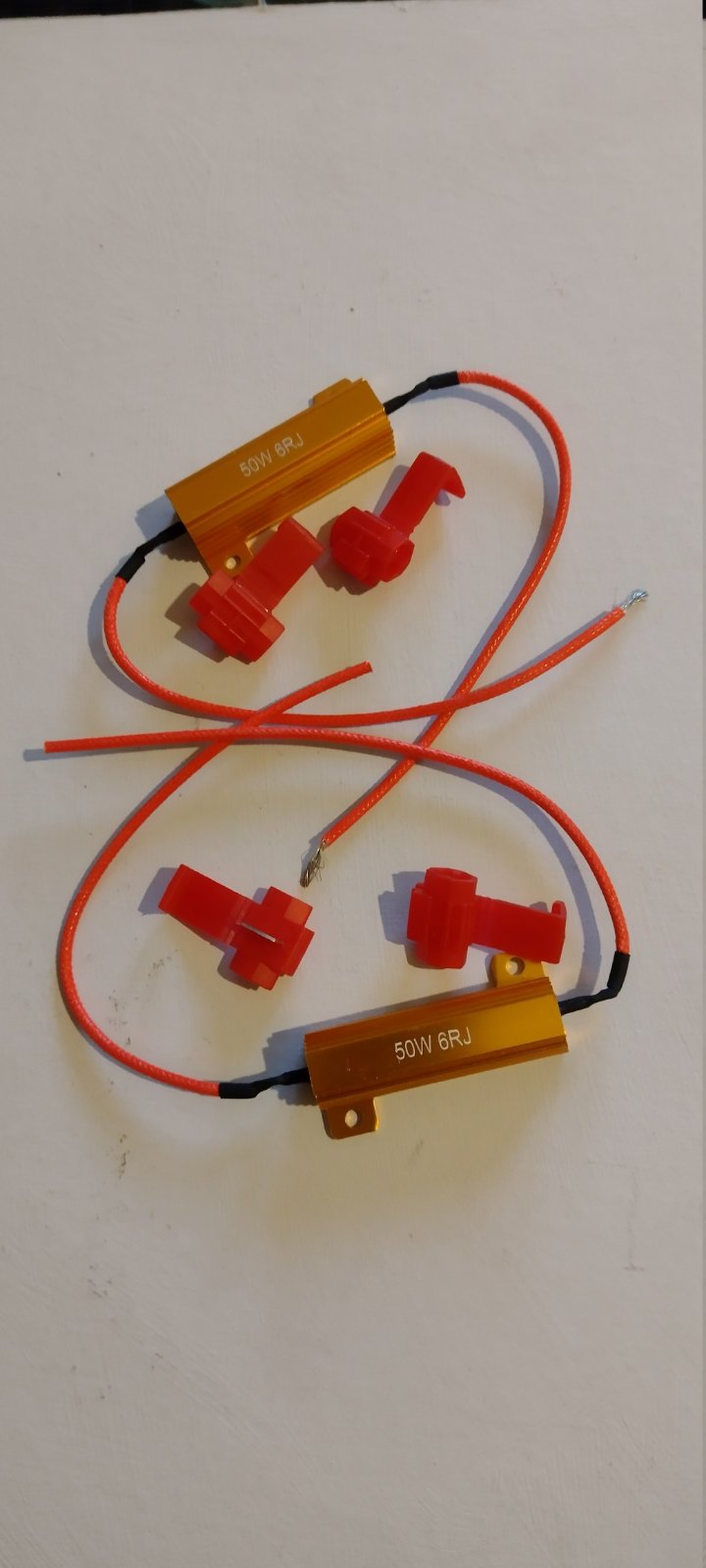

Or perhaps a resistor. I bought LEDs for the reversing lights and they came with resistors for canbus systems. Not needed on the Civic.

These are the ones that came with my LEDs. Never used though.
50 Watt 6 Ohm.
50 Watt 6 Ohm.

Which more or less confirms the need for a load resistor. Worth a try anyway.Finalgrab wrote: 05 Feb 2026, 15:06The battery is new in the car, the original boot light works correctly and the led strip works perfectly when I connect it to some power source at home.wheeler wrote: 05 Feb 2026, 14:24 Have you confirmed its not a faulty unit by trying it directly on the battery? Does it work ok if you do this?
