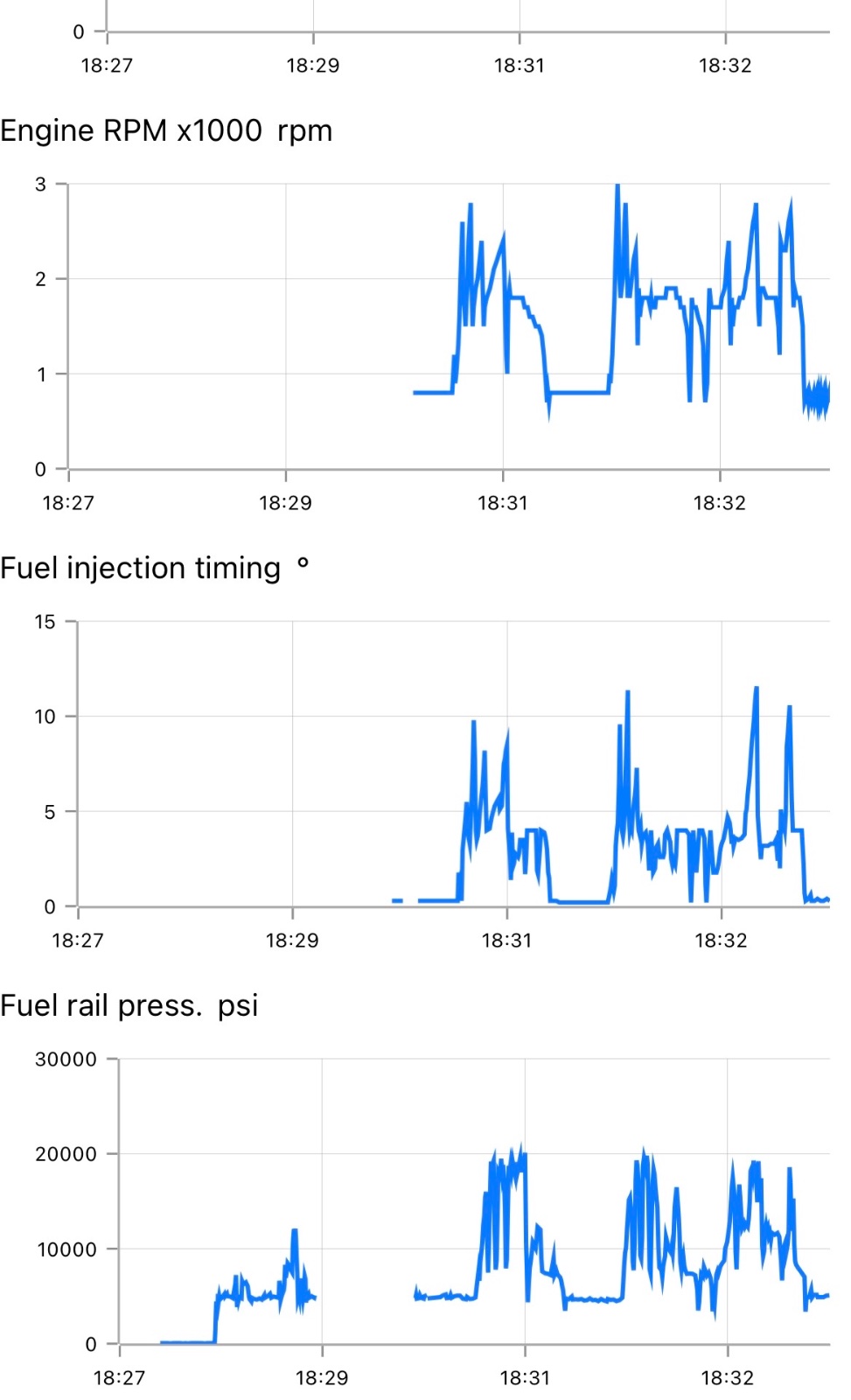

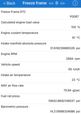

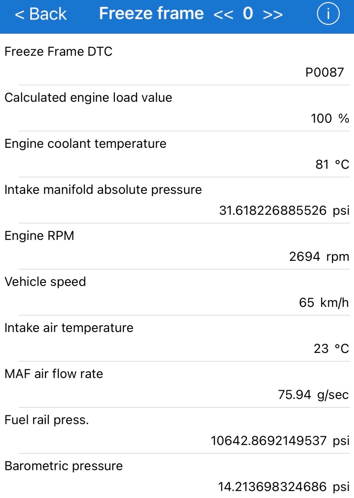

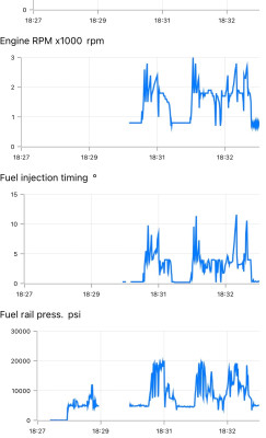

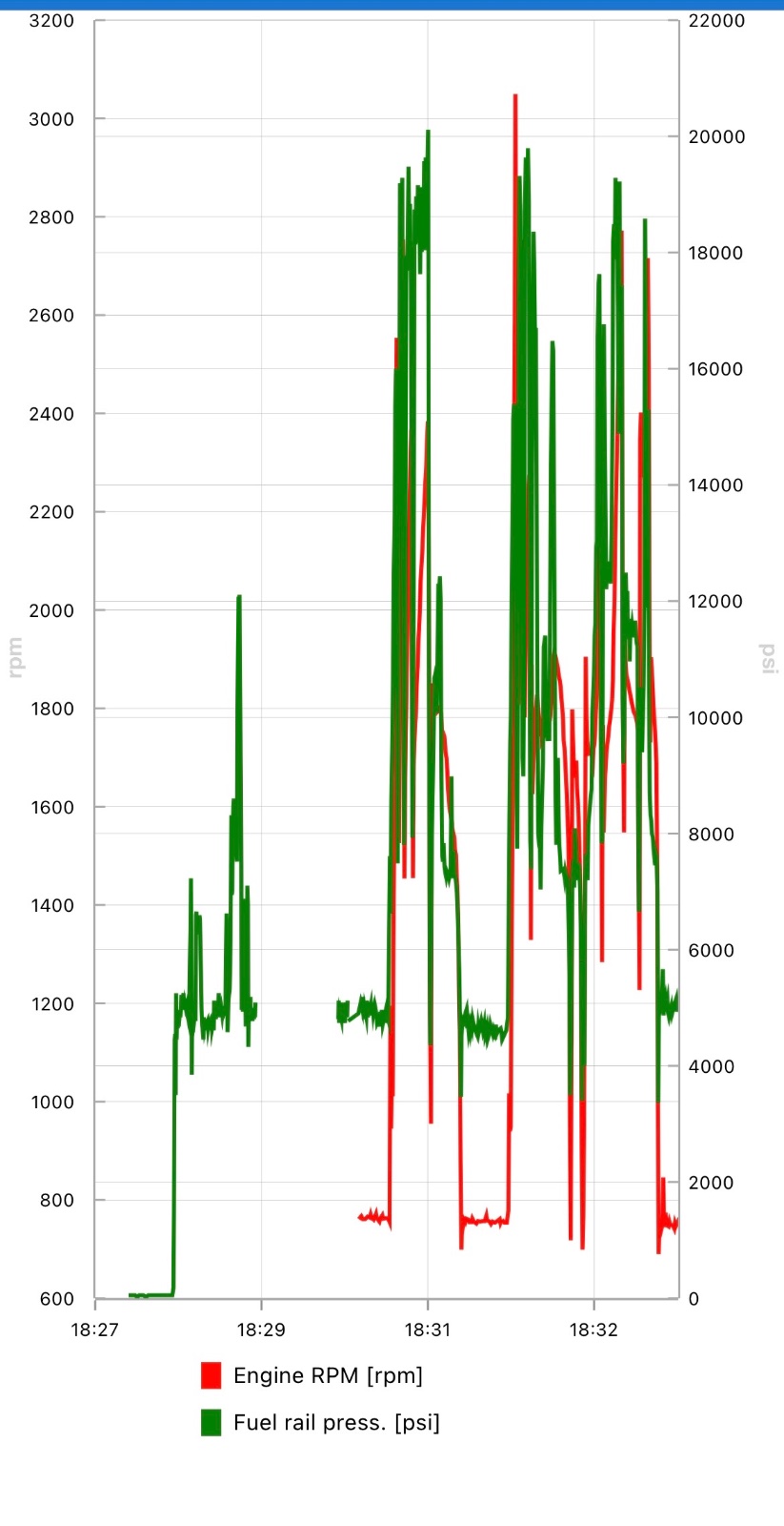

About three weeks ago my 2012 1.6hdi berlingo went into limp mode and had an error code of p0087.
I changed the fuel filter …….and after around 200mikes the issue came back.
It seems to only occur when I’m accelerating hard.
I took some readings on the fuel rail ect- can anyone tell me if they look ok?
Any suggestions? Thanks

A read through this site may give you some ideas: https://carscounsel.com/p0087-code/ :)

This topic has P0087 with a couple of other codes. The fix was new injectors and also a pressure regulator but that might not have been needed. viewtopic.php?t=87677
