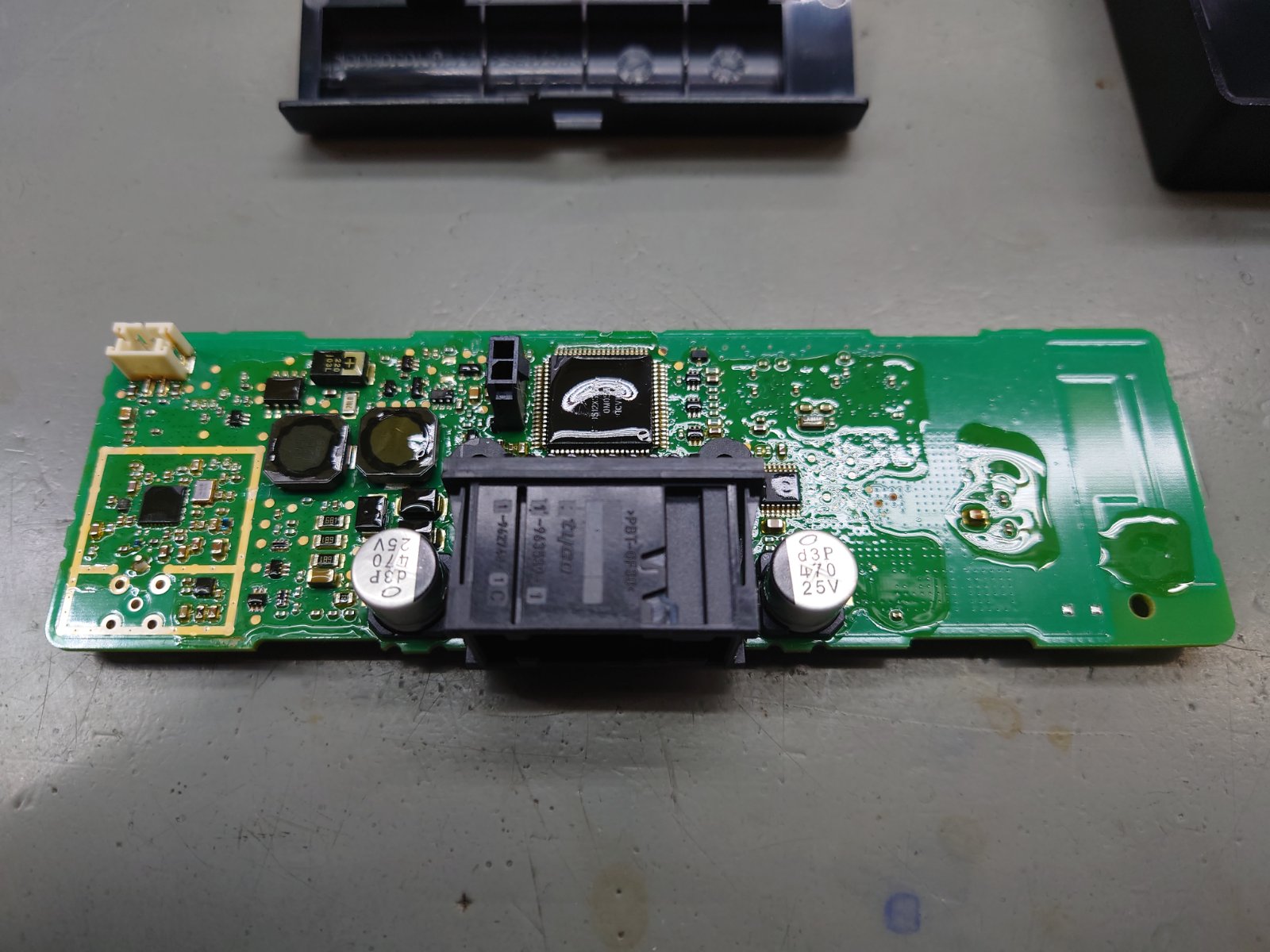

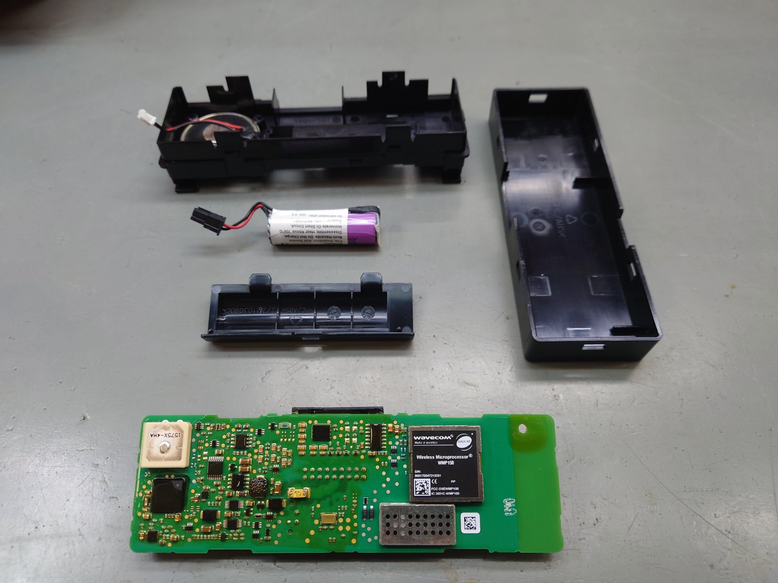

Out of interest, I decided to tear down the old module. The new one I picked up is a Magneti Marelli made in France, the original is an Autoliv made in Sweden. Both reputable brands, so no complaints there. I didn't tear down the new one, but I can say that both have a built-in speaker and an 18650 cell. The speaker is presumably for when the HU is disconnected in a crash (the car triggers an electrical cut-off from what I know). Same story with the cell. Diagbox says that with the current state of the cell in the new one I should have over 15 mins of communication time. Presumably the module powers the mic in the ceiling.

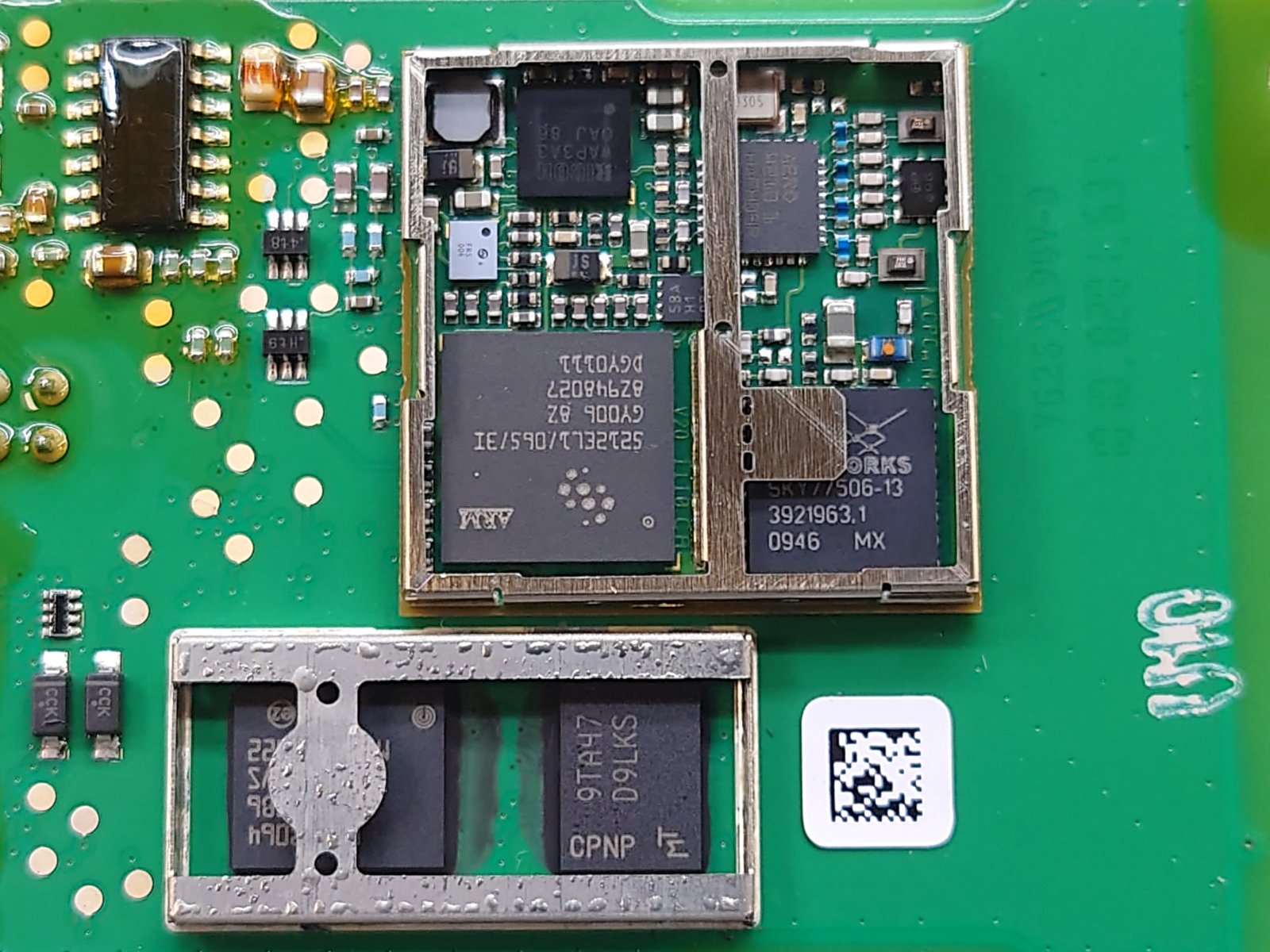

The casing is only held together by simple (and visible) clips, but was a pain to get into because most of them have to be released simultaneously. Once inside, there isn't actually very much to see. Part of me was expecting to find a SIM, but there wasn't one. There were a couple of EMC cans and large portions of the board were covered in epoxy conformal coating. That's about it. I don't actually know what to do with this thing now. On one hand, I don't want to bin a perfectly good PCB, on the other, it's a useless brick since the system got decommissioned.
