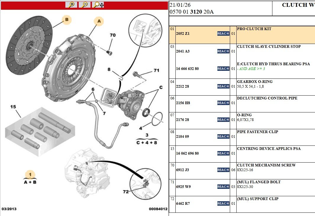

Re: Correct clutch kit
Original clutch part number is 2052Z1
Doesn't list diameter but hopefully should be able to cross reference with OEM part number
