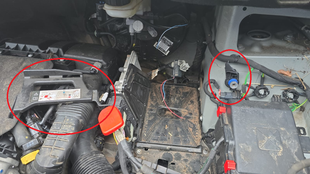

Hi All,
Recently had the battery stolen from a 2023 Citroen Dispatch 1.5 BlueHDi, whereby they snapped the top bracket in the process.
Picture attached.
Could anyone please assist with the part number and if possible where to buy from?
Kind regards
Solar Man 8-)

A Citroen dealer ought to be able to get one.

That's annoying! I'd have thought a breaker would be the best bet; it's quite possible that is the same as other cars - looks similar to the one on our C4 Picasso for instance. I'd have thought a temporary repair with cable ties or pop rivets will get you back on the road.

You actually don't need it as the battery is secured from the front clamp on the battery tray, but it's a lease vehicle and needs the repair :(

The part number might be on the back of the bracket. There is something similar on ebay and that has a part number on it https://www.ebay.co.uk/itm/157625654880 ... dUQAvD_BwE

I was going to post a photo of the repair I did on the bracket on my 308 but it's hardly invisible.

I had to get one for my 2018 Expert, the part number in the link from PaulC5 is the same as I bought via Ebay seller citroenservices in October 24.
It's called something daft like 'Engine Control Module Bracket' and comes in two parts, part number 9808674780 and seems to apply to many different vehicles in the PSA range. I was looking for ages to figure out the part number, most weren't cheap, cost me £26.12 for a new one in the end so worked out ok.

Cheers 👍🏼 I got the part number from the underside of the plastic top bracket and it’s 9808674780 and I’ve ordered from eBay for about £26…. That was hard work…
