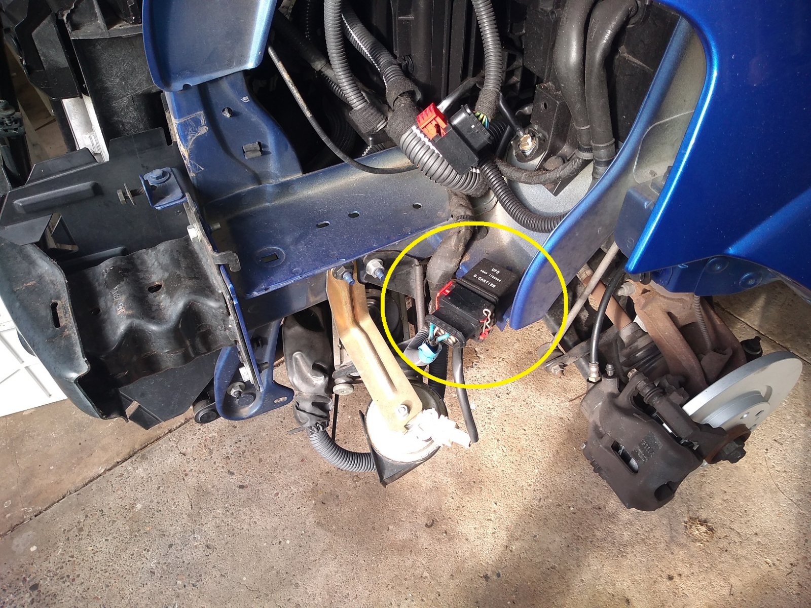

The lock out relay is located below the left hand headlight, above the horn and ABS module. This is a pic from a C3 but the C2 is much the same.
You will need to remove the wheel arch liner to get to it.
Don't get too excited just yet, you need to tell me what type of instrument cluster you have.
