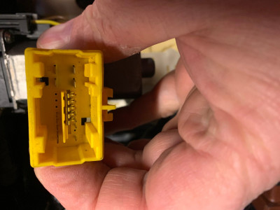

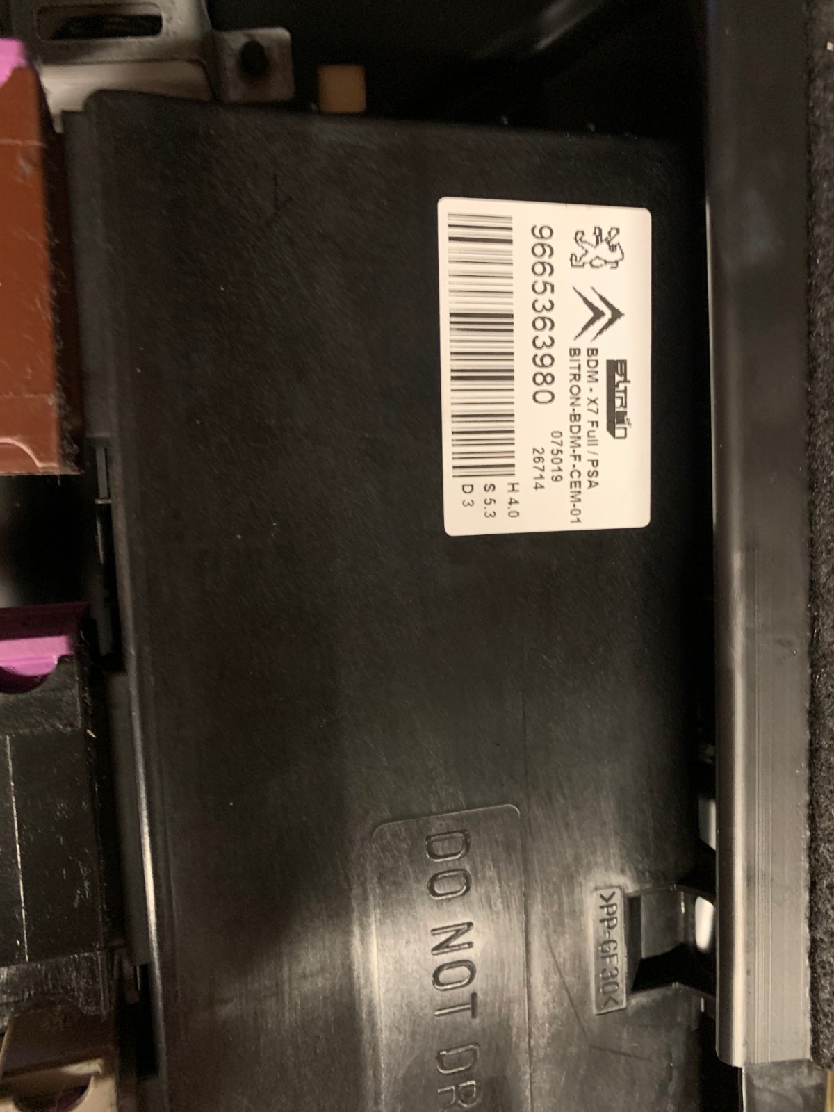

Before starting to install the new front seats, I would like to check the various electric motors without the airbag exploding - so here is the question:
Any advice on where I could apply 12 volt directly into the wiring loom of the front chair to test the electric functions? Can it be done?
The images show the connector and the control box of the driver's seat.

I don't know if it will help but you might get a clue from this site:
https://circuitblaze.com/power-seat-wiring-harness

Re: C5 X7 electric front seats wiring question
I take it you have seen this thread, which contains the wiring schematics/diagrams?
According to those diagrams, the memory seat function is via an ECU under the seat on drivers side (not present on the passenger side as it doesn't have the function for that) so the BSI shouldn't really come into it - unless it does act as a 'relay' in between the buttons and the seat ECU? Sadly the buttons are not shown on the schematic.
I would suggest the massage function is also driven by that ECU and therefore the reason you don't have either function is a 'common' problem.
I wonder if you are perhaps missing one of the power and ground connections?

Update: All connections have been checked, and everything seems to be OK.
The memory function is still not working.
When I now try to switch on the massage function, I hear what I think could be a relay inside the seat ECU box clicking. At first it makes a click when I press the button, and after a appr. 10 seconds it clicks again. However, the massage is not being activated.
I visited another mechanic who connected his tester with the car. The tester detects the massage function, and it also reads what must be old values for memory setting 1 and 2. When we try to force activate the massage function with the tester, it gives the error message that it is not possible due to a malfunction.
I am wondering if it could be a problem with the seat ECU?
The lumbar support works when engaged by the control button on the side of the seat, which makes me assume that there are no mechanical problems with the seat(?)
Still very open to suggestions!
