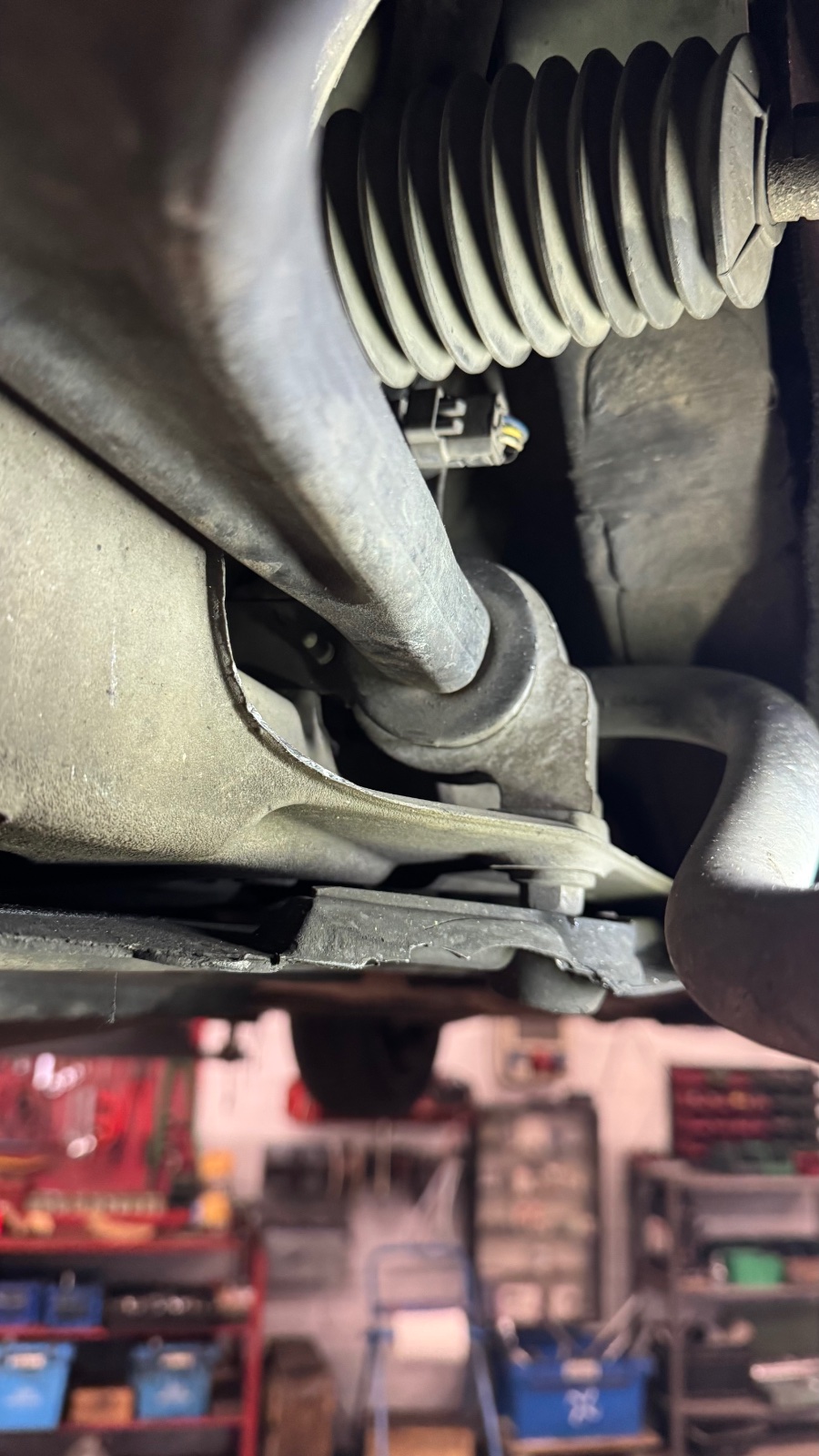

Interesting that the one in your photo isn't listed in the parts diagram. It might officially only be sold as part of the whole wishbone. Come to think of it, that's probably by the stealership kept charging to replace the whole wishbones on my 2L. Either way, I think most people call that one the control arm bush, I've heard some call it the P-bush. According to Autodoc it comes under a multitude of original part numbers.

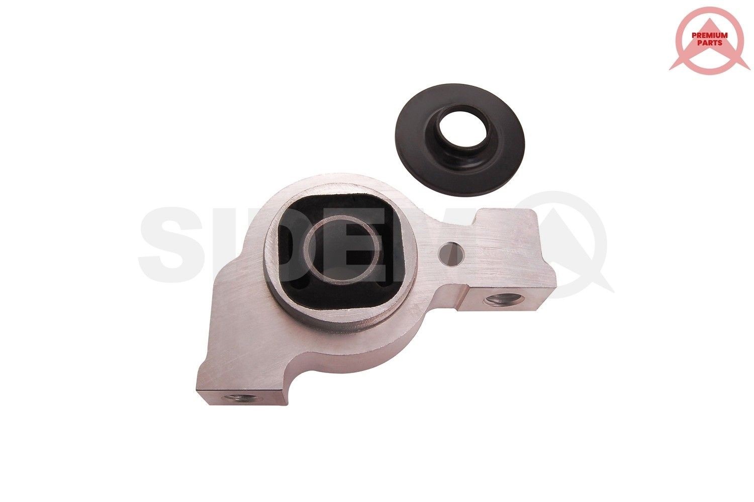

Hi Rob, I found out that there is just one manufacturer doing it, Sidem 853640

Autodoc has a boatload of brands. Are you looking at a different vendor?

Hi Rob, it seems the aluminium chassis has two different suspension arm bushings depending on the suspension type. However, for the H3+, I can only find this manufacturer. Autodoc already provided me with other product formats but none of them are mounting.

That's odd. Try entering the part number into EF24. They tend to sell OEM stuff. I've had no issues with them before.
