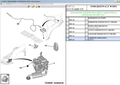

Where can I find the Webasto Telestart 100 module in my C5 X7 3.0 HDi?
I've been looking for it near the battery and the BSI. I doubt it's anywhere in the engine compartment, but maybe it is?
Has anyone tried to control Webasto via W-BUS or CAN?

I have a Webasto remote control, but the signal is sometimes weak. I want to add my own GSM receiver to the heater ;)

I also searched Sedre and only found this. Its part no. 2
Here's the data:
13003CJ
10202
KTVD**
16700202
800EN

Have a look through this document, you may find some clues: :)
