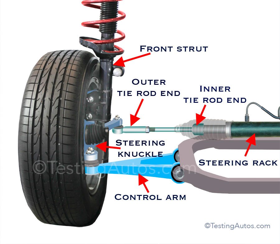

BUT I CAN FEEL IT IN THE TIE ROD END, I SUSPECT ITS INNER TIE ROD END BALL JOINT
Not it makes more sense why my steering wheel started to shake when turning left or right
Any suggestions guys

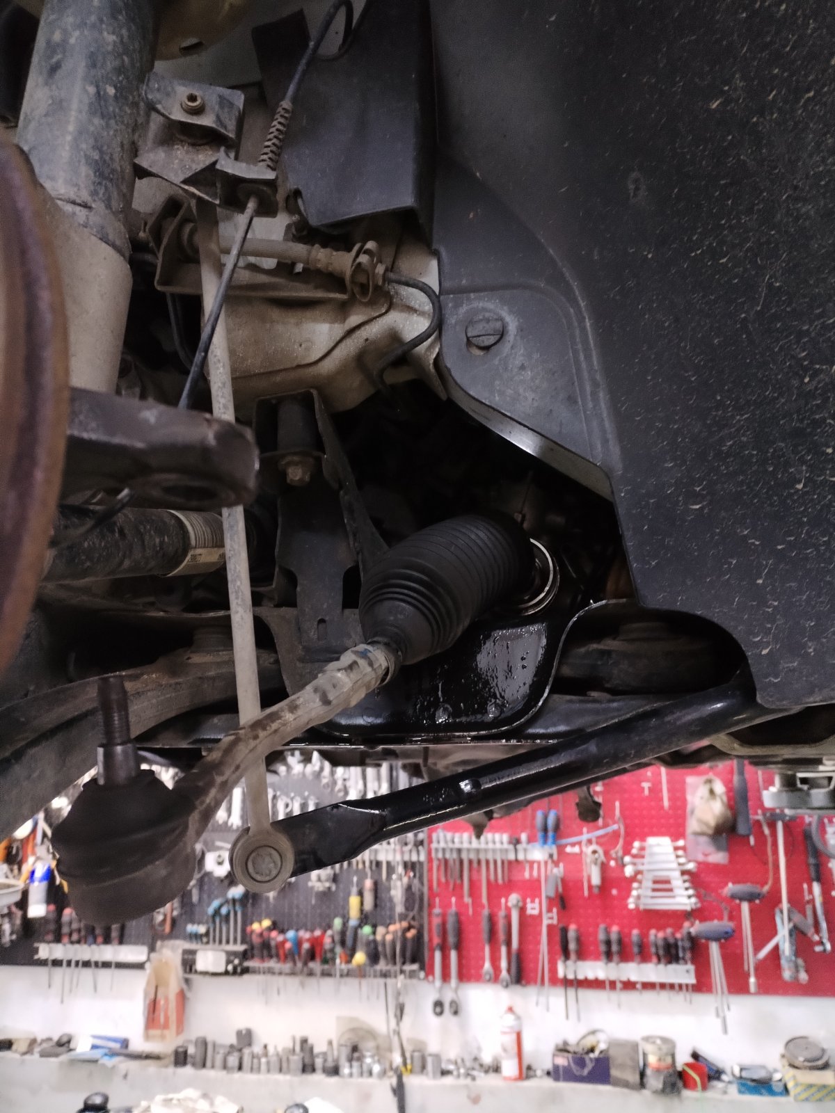

Quick update, its not tie rods, its the steering rack. When we opened the left bootleg cover there was a servo fluid in there it leaked, bootleg was filled with oil from steering rack. Thats why steering wheel was shaking because of oil leakage. And something inside of the steering rack is producing metal on metal sound.
So we will change the steering rack, we found one second hand for 100eur
And let you know if we fixed the problem, but it got to be due to the leakage

This one was Koyo steering rack, they are Japanese but they have that one common issue internal knocking noises. I will provide more pictures tomorrow. Also when i bought my car second hand, I suspect that the person i bought this car from, covered up that issue. Some mechanics say that usually people would insert a grease inside the steering rack and it would reduce the knocking noise to be almost unnoticeable,that sounds strange to me but who would know it, people are coming with all kind of nonsense, so that wouldn't surprise me.
