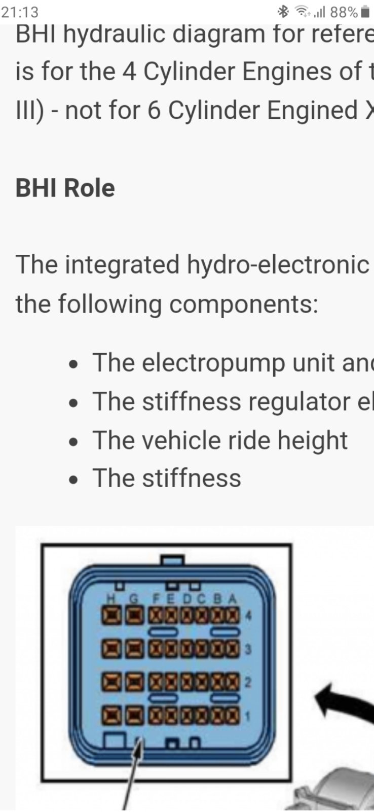

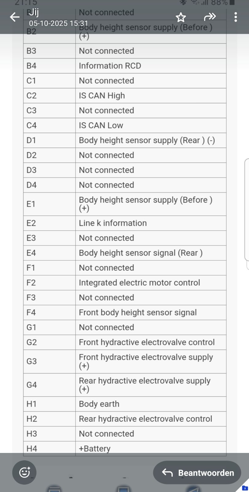

Because you have a 2.0, not a 3.0 it's a bit different, you have to find the right wires on the connector from the BHI (black box on top of the pomp).
Then you have to connect the resistors 10 Ohm/10 Watt on these ones.
But before you do this, you can remove fuse G39 first to see how the car behaves when it's in the soft mode, you get an error on the dashboard, but even so you can drive the car for a while.
Here you see the the connections that you need, it's:
G2,G3 for the front and G4,H2 for the rear stiffness regulator.
