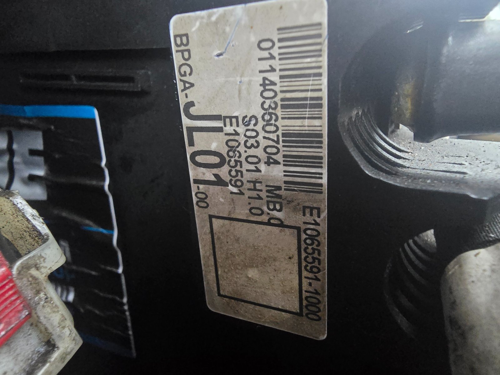

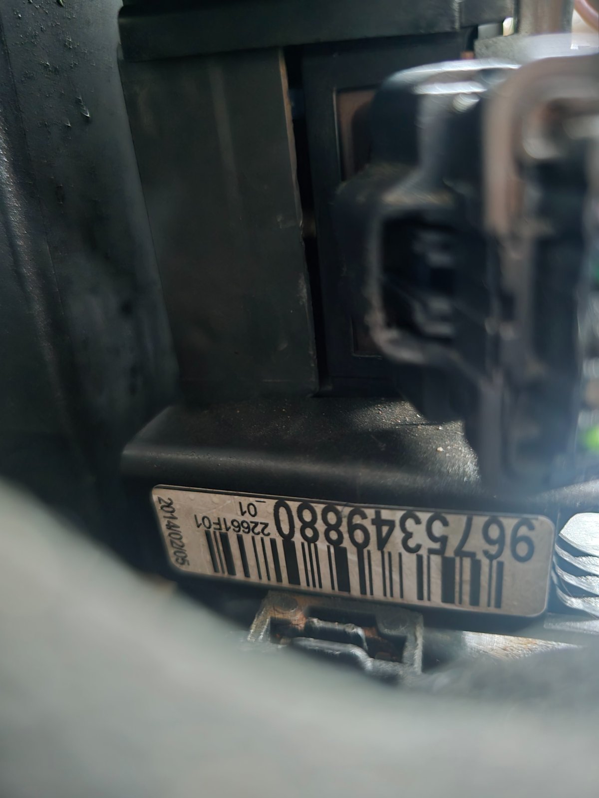

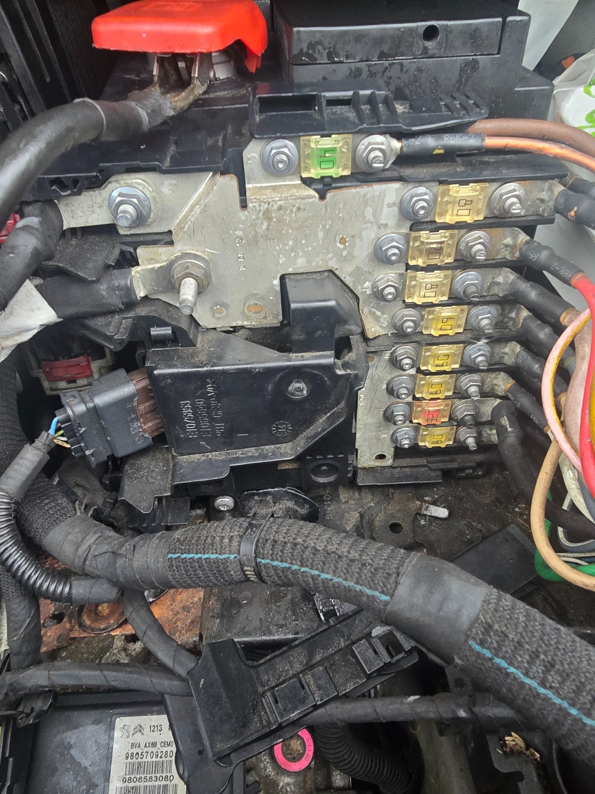

Hi so im picasso has broken down, I used it for school run then went to jump back into the car and it would not start. Rac was called and this is the report,https://rescue-report.rac.co.uk/rescue- ... =MyRac+App
I had the car recovered home and have been trying to figure out what's gone wrong since. I have added two extra earth cables to rule that out, battery has been removed and fully charged still nothing. I havent been able to do a bsm/bsi reset as says need window open to turn on side lights which I cant do as car is in engery eco mode so wont let me open the window. I'm waiting on a launch diag tool to see if I can read anything different and do a bsm reset that way. I brought a second hand bsm to try that still nothing.
My reg is BK14WXR and vin number is VF7**************[VIN obfuscated, can be read by forum staff]
2014 citroen c4 grand picasso not starting.

Re: 2014 citroen c4 grand picasso not starting.
If you leave the key in the ignition switch and you then open the driver's door, do you get a warning message - if not then the immobiliser might not be recognising the key.
We had a Xsara Picasso that stopped working and it was a maxi fuse that had failed, RAC did not spot it but towed it to the dealer since it was under warranty.
