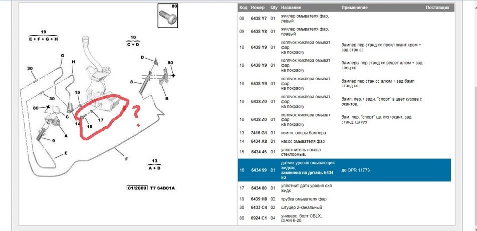

Thanks again, appreciated. Is there a parts diagram available anywhere? I see parts diagram on some posts with exploded view and relevant part numbers. Not sure how to find that info.
Also wondering if anyone knows if this is a bumper off or can it be removed via arch lining?

Re: Citroen C4 Picasso B78 Windscreen Washer Sensor
Photo No. 8
https://www.drive2.ru/parts/peugeot-cit ... ga8#photos
Part Nr :6434.99
It can be removed via arch lining .
Part Nr :6434.99
Extracted from Mihael_M's post click on the picture to enlarge:
