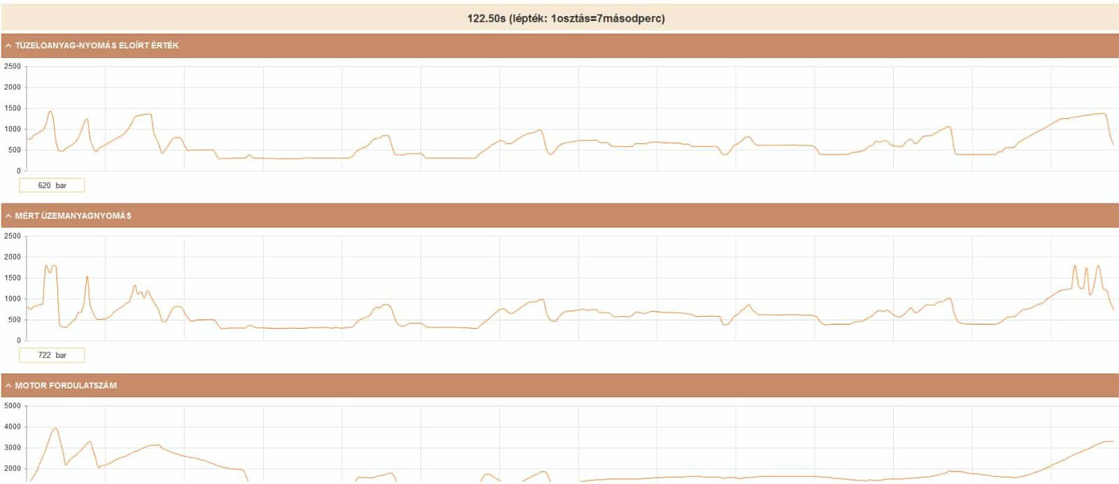

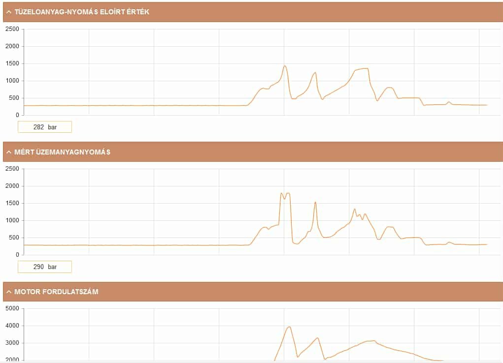

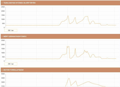

    For the pictures:
    (Top line: Required fuel pressure, Middle: Given fuel pressure, Bottom: rpm). When the computer asks for 1500 bar the car can deliver 1800-1900 bar! LIKE WTH? Or spiking between 1300-1800bar! WTH???
