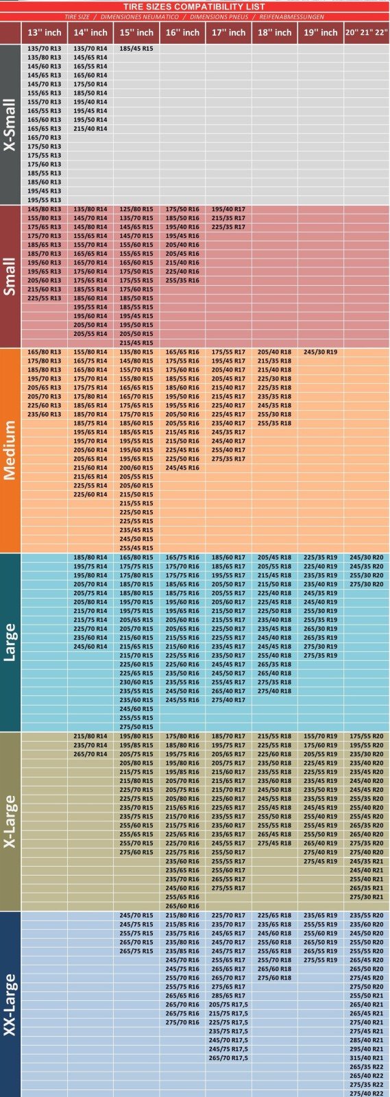

I was looking into buying a set of snow socks instead of chains (I never go anywhere where I need either of these, but better safe than sorry), but I could not find any size chart that fits my wheels (stock 195 60 R18).
I could not find any socks anywhere online (at least not in Serbia).
Any recommendations as to which size to take from the attached table (if any of them would actually be a fit)?

I suggest large but do your own calculation.

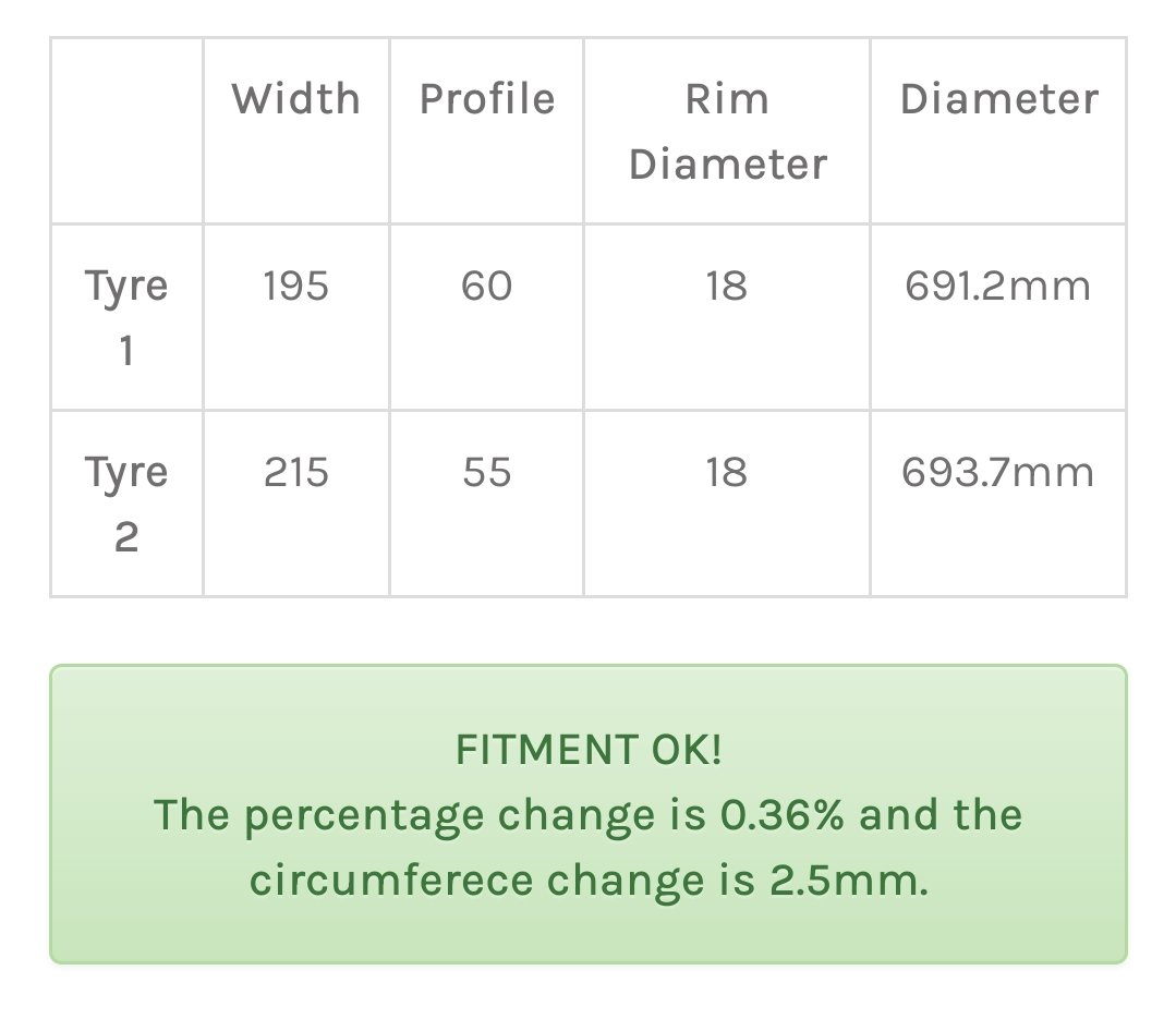

205/55 18 is within 1,25% of the circumference of 195/69 18 and is listed as "large" in your table.
You can look here, the first 'find a tyre' option doesn't work for our sizes, but calculator 2 does.
https://alloywheels.com/tyreCalculator

Yeah, large seems like the closest one, I'll probably go with that one.

215 55 R18 (forst XXL size) seems like an even closer fit, but bigger diff in bidth, so I expect I would have problems there, so I'll go for the large. If I ever get in a situation to actually use them, I'll "report back" with findings.
