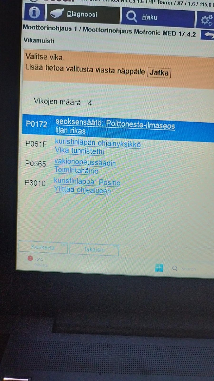

This morning when I started the car, the engine started fine but the fan was screaming at full blast. I checked the fault codes and there were P061F and P3010, I think these are throttlebody error codes?
Troubleshooting is not helped by the outside temperature which was -22°C. So I drove the engine to warm up. While reading the fault codes the car started blowing cold air, when I increased the revs it started blowing warm air again. The engine temperature remains normal. There may have been a little too little coolant, but I don't think it has that much of an effect. So i think i have broken waterpump.. Also i chek heating/aircondition fault codes. There was nothing but i noticed, right-hand outflow temperature sensor is broken. 6513,5°C. Left-hand works and reacts normal.

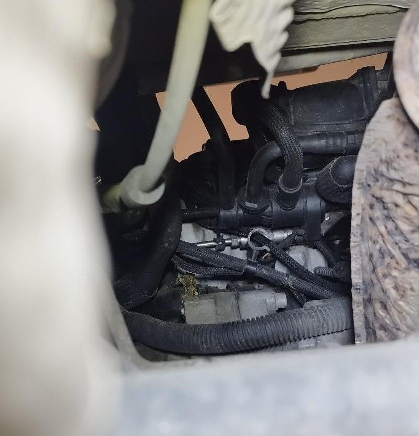

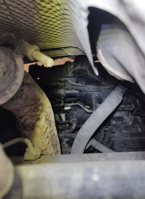

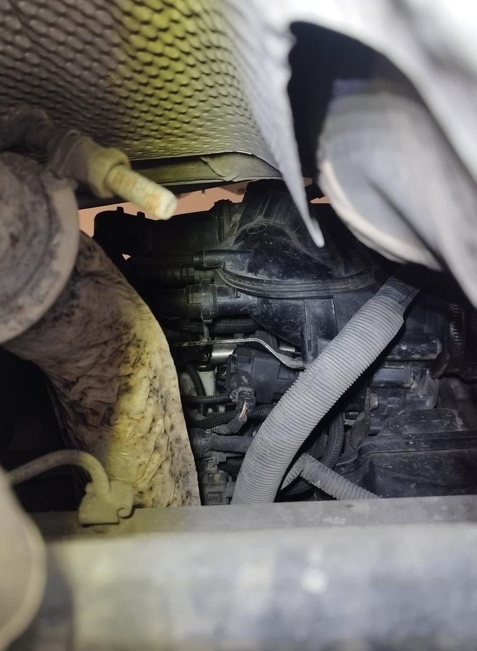

Today I checked the car again. Adding coolant and bleeding the cooling system helped get warm air into the car. I also checked that this "turbo water pump" is working properly. In the summer, when I went on vacation, I checked and added coolant to the maximum level. Now I was able to add almost 1L of new coolant. There was no visible leak anywhere. Somethink is drinking it...
I checked around the injectors. Really hard to see, I could only see the two injectors on the transmission side. The throttle body blocked the view of the first two. Everything looked really dry and clean. I also tried spraying Brake cleaner there, hoping there would be a leak and the engine would rev up. But nothing happened. I also checked the fault codes, there were none of them.

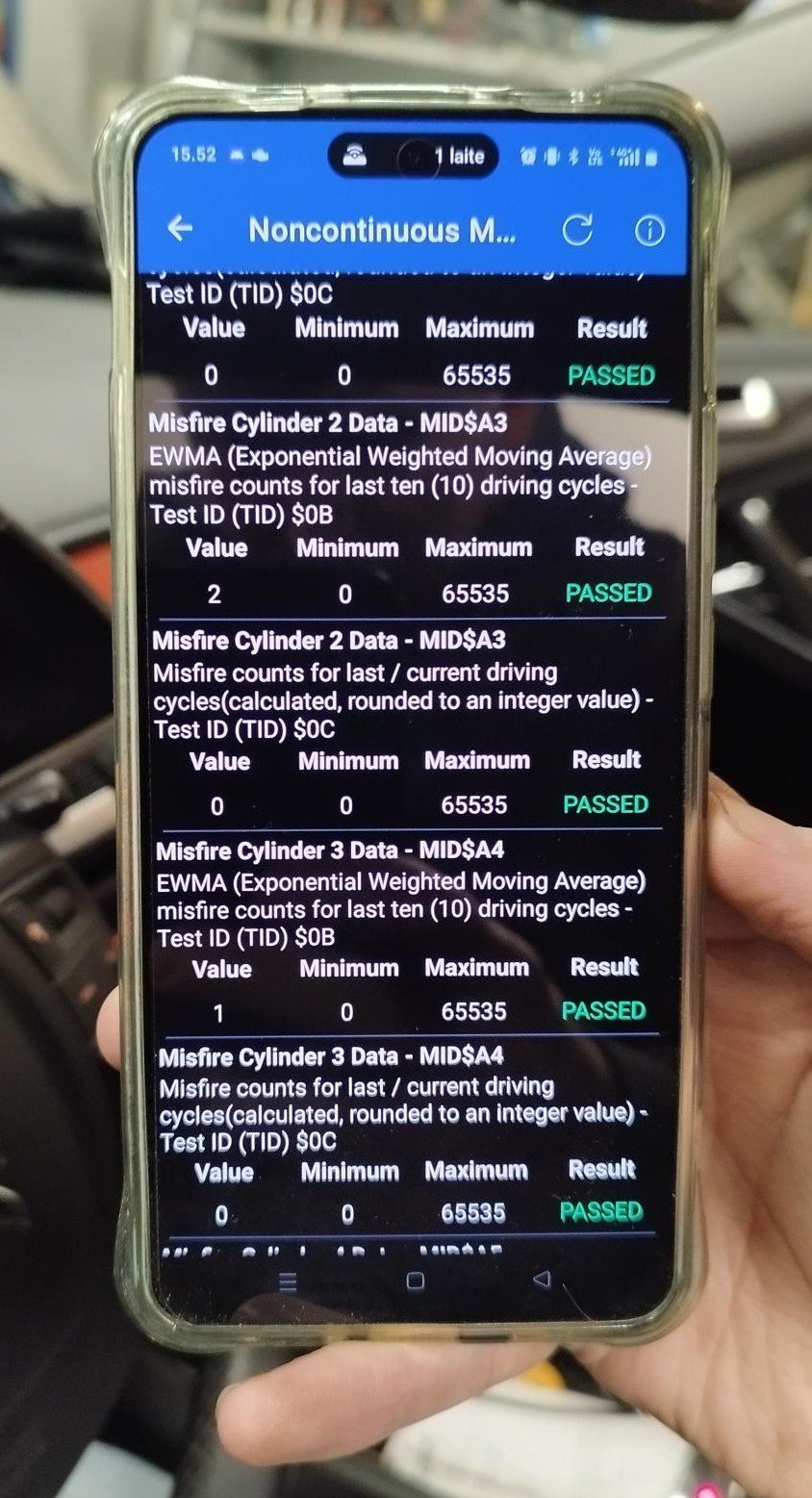

During the last 10 driving cycles, the computer has only recorded 2 misfires in cylinder number 2. and 1 misfire, in cylinder number 3. None in the other cylinders. I also took a short video clip showing some live data. Sorry for the poor quality at the beginning of the video.

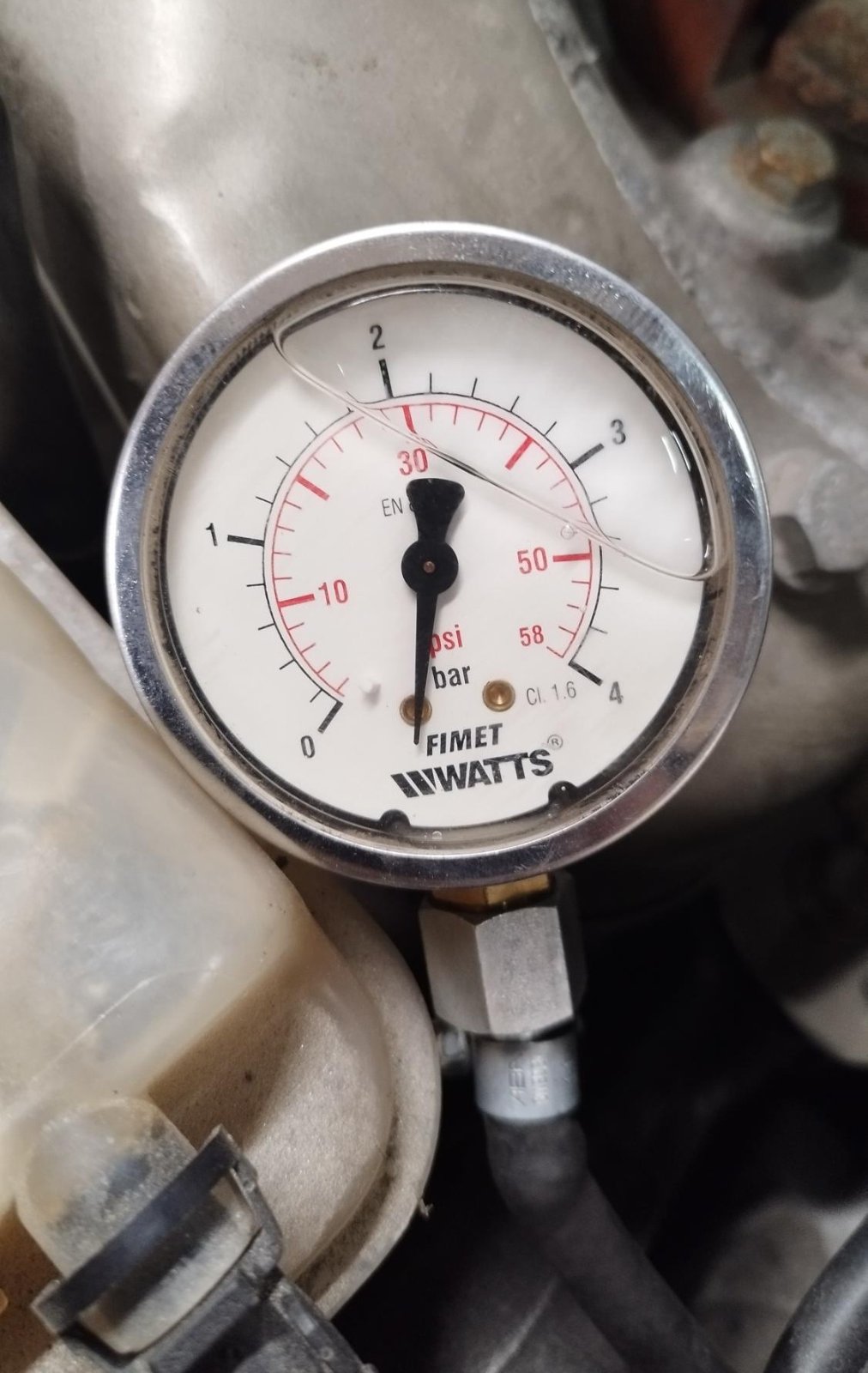

I measured the fuel pressure with a mechanical gauge. It was about 5Bar.

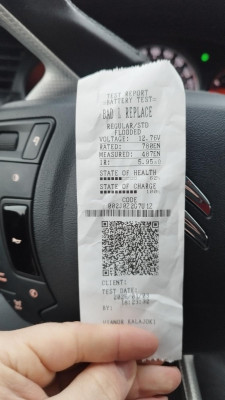

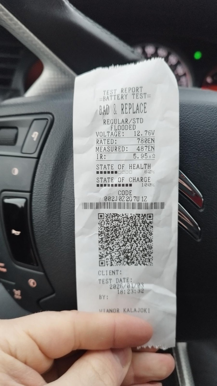

I had already done a battery test before. I forgot to mention that in the first message. According to it, the battery would already be bad. The battery is 2-3 years old, can it already be so bad that it causes these problems? The battery is a Bosch S5 008. 12V 77Ah 780A.
Edit: Add one photo. The car is working completely normally again for now. Does any of the data show anything unusual?

When I searched for your battery I found the link below which suggests the battery has a 5 year warranty. I'd check your receipt for it, if it is only 2-3 years old and see if they will replace it under warranty. Yes any battery can die at any time due to excessive charge/discharge cycles or high level rapid discharge, often caused by continuous cranking of a non starting engine, or even inadvertant short circuiting etc. Replace it and see how it goes:

I checked the battery warranty, unfortunately here in Finland we don't have such long warranty periods for batteries. I don't think the battery is that bad it could cause such problems on its own, at least other car brands haven't had this. Of course, with a new battery this option would also be ruled out, it's a approx. €150 experiment.

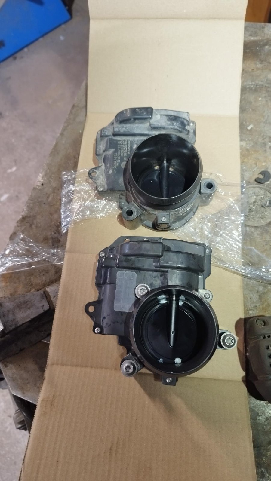

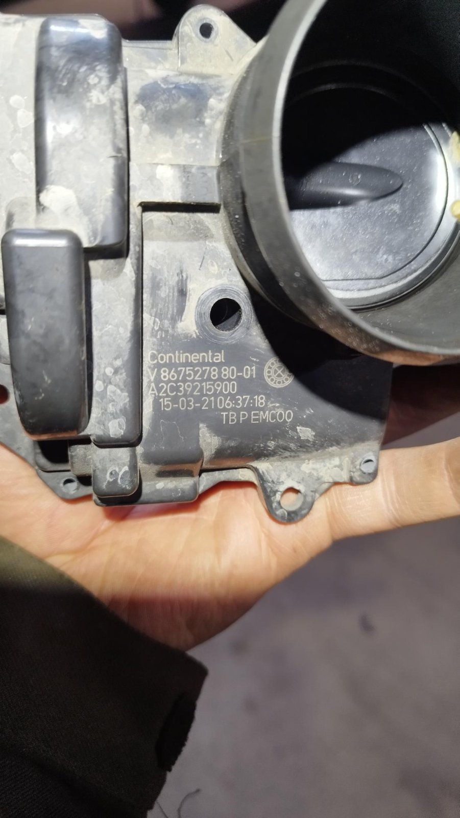

A month ago I ordered and replaced a new throttle body and gasket. I ordered a Hitachi (Astemo) one from Autodoc. The original one seemed to be made by Continental. I noticed that there was a little oil in the throttle body connector, the wiring harness itself was completely dry, so the oil must have come from inside the throttle body. I think moisture/oil has gotten in from the shaft root and it has caused these problems in very cold weather. Now, after a month of driving, all fault codes related to the throttlebody, transmission, handbrake or cruisecontrol are gone!

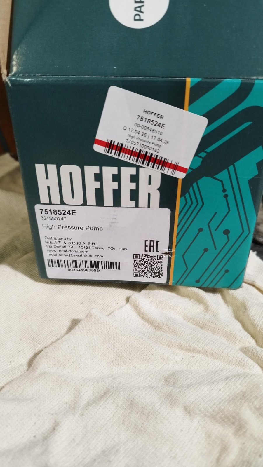

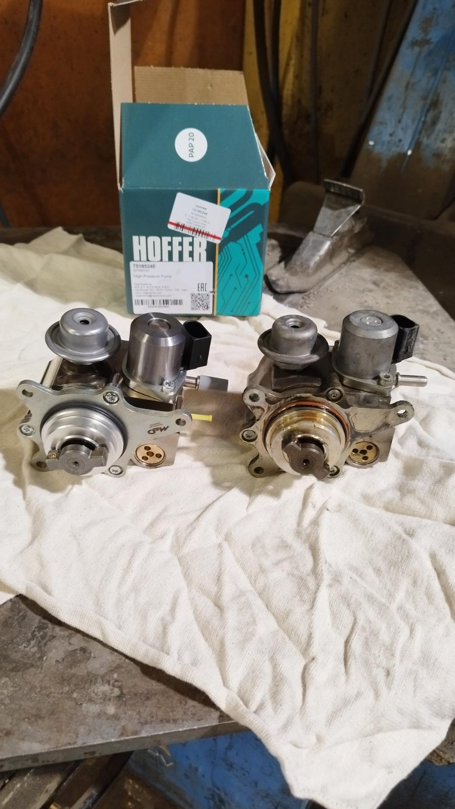

Happy spring to all forum members! I finally made a decision and ordered a new hpfp for the car. I ordered it from Trodo for 603€. The brand was Hoffer. Google's ai told me that it is a company owned by the Meat & Doria and they are practically the same parts, in different packaging. This new Hoffer pump had the M&D logo, so apparently this information was correct. The replacement was easy. In hindsight, it probably would have been worth replacing the pipe between the pump and the nozzle rail as well. Apparently it is recommended to replace both at the same time. After replacing the pump, the car has been working perfectly for a week. No more cold start problems or error codes! The fault was indeed HPFP!

So that life wouldn't be too easy and comfortable, I bought myself a completely identical car! The only differences are color and that my car doesn't have half-leather seats, but I have a glass roof!
The seller of the car lives +300km away and his car broke down in my town. The local repair shop examinded the car and stated that the 2nd cylinder injector is broken, it is leaking through. The owner managed to get another ride home and wanted to get rid of this car quickly. He put it up for sale for €500, I bought it right away! New Bosch injectors seemed to cost 65€/each. I think I will replace all 4 of them and see what happens!
