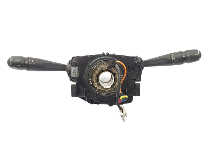

https://ibb.co/PvcvY232
Thanks for the link. Based on the unit in my 2016 C4 (image attached), I can see a circular grille on the right side of the assembly. I assume the buzzer is located right behind that. Since the sound was intermittent before failing, I suspect a dry solder joint on the PCB or the buzzer itself rather than a software issue.
