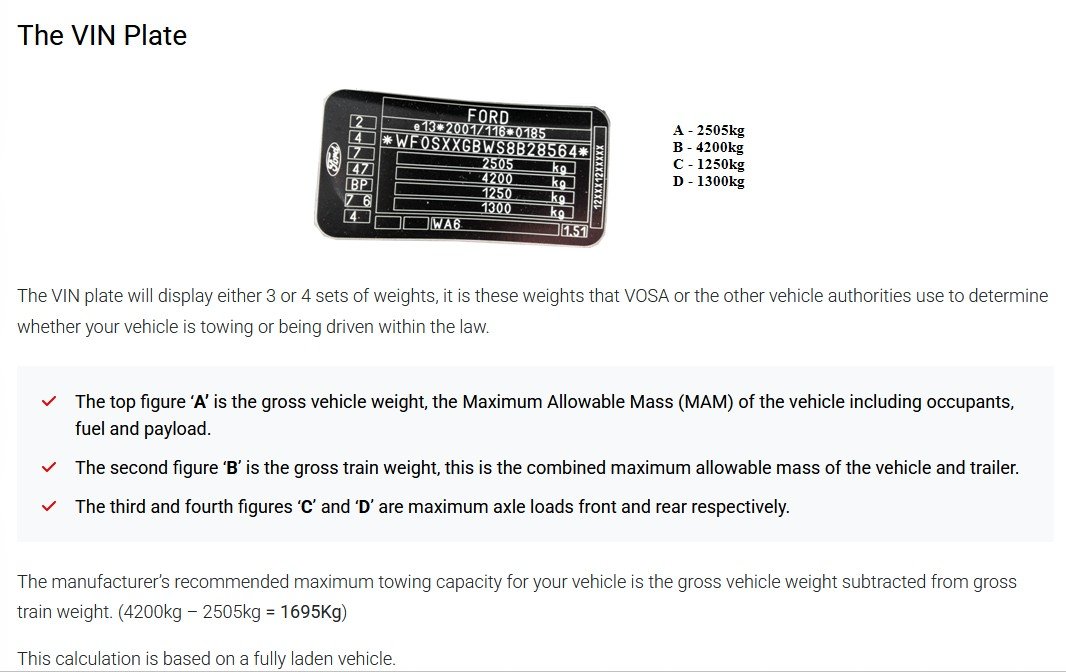

hi gotta c5 mk1 2003 2.0 hdi saloon model looked on log and has no towing weight on it just blank any ideas
ty
Posts: 21139
x 8119
Re: c5 v5 logbook
The info is on this site but you do have to scroll down a fair distance!! :-D
https://www.towingcapacity.co.uk/car-ma ... itroen-c5/
x 3567
Re: c5 v5 logbook
You should be able to calculate it from the VIN plate....
VIN plate - NTTA
VIN plate - NTTA
https://www.ntta.co.uk/law/law/towing-capacity
