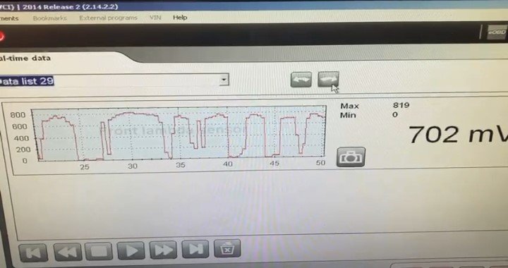

Front lambda sensor signal measured with an oscilloscope ? The signal correlates with the “grunting” at idle.
Front lambda sensor signal oscillates normally at 1500 rpm, and the engine runs reasonably well if RPM is held steady with the throttle.

Still not replaced: brand?new injectors and lambda sensors. Timing chain/belt has also not been opened. What would you suggest? Attached is a picture of the front lambda graph at idle. This has been a hobby since I have stopped counting how much time I have used to this, but I still don't agree to give up as this has become some kind of challenge to me even the car should have scrapped the day this problem occurred (+260k kilometers and 20 years behind).

Yes I have replaced the air filter and also tried to run the engine without the filter at all but this has no affect to anything. Another thing I forgot to mention is that I have also replaced the coolant temperature sensor but neither this did affect to anything. One thing I have been wondering is that even the lambda graph seems ok, why does disconnecting the lambda sensor not affect to anything. I would have thought that disconnecting the lambda would affect to something but nothing except a new fault code appears to happen.
