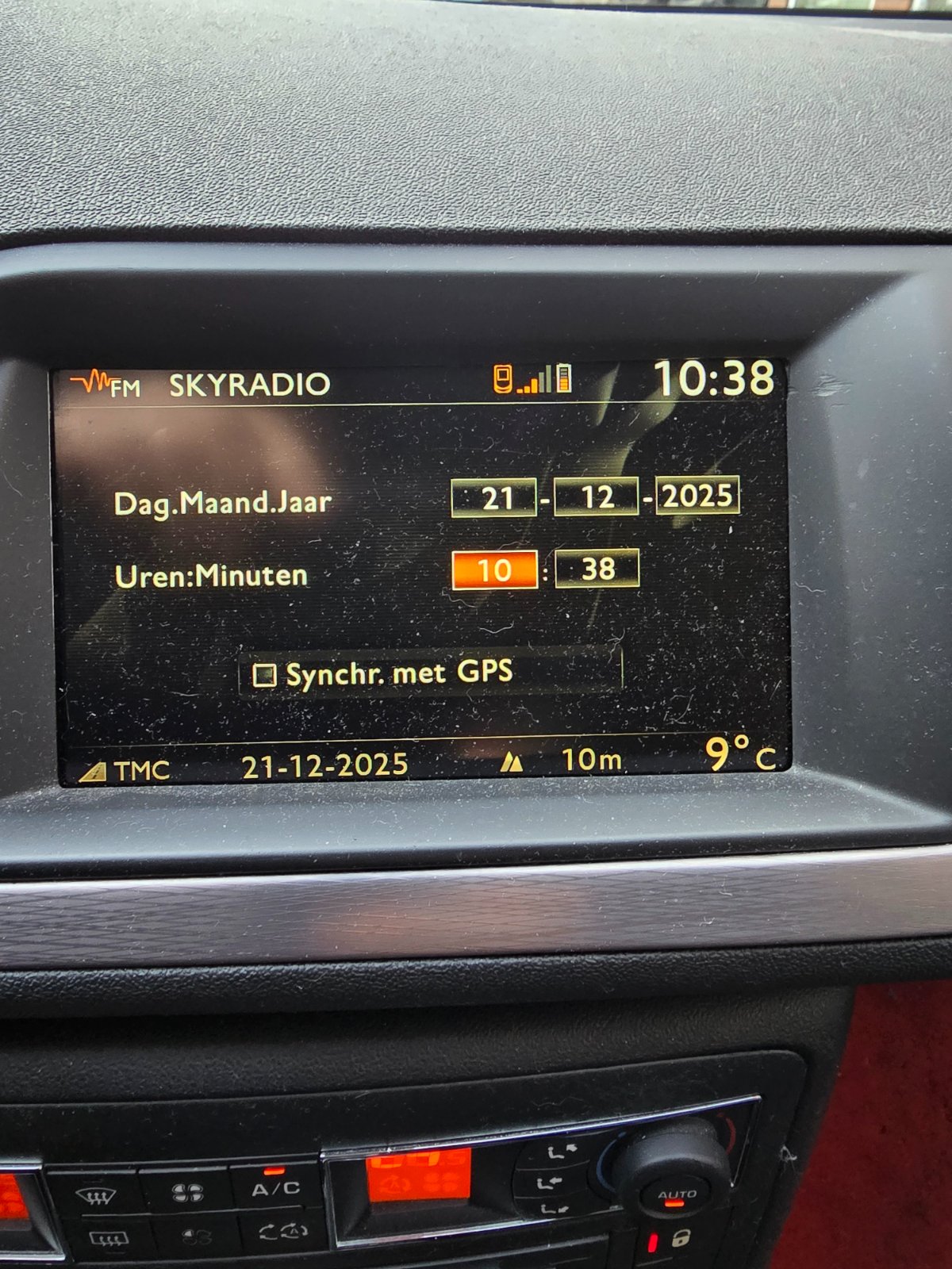

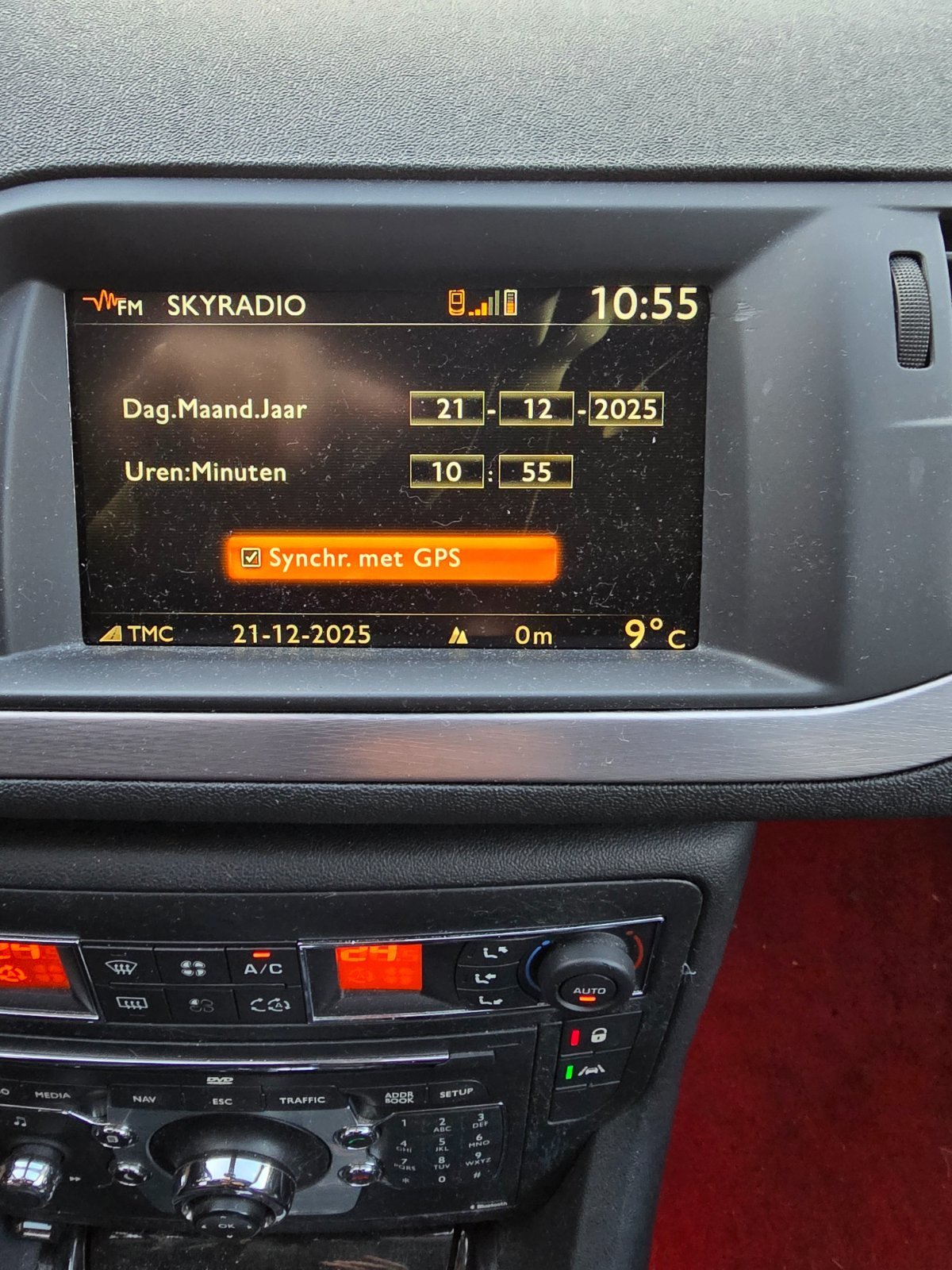

I have the same unit and just checked it for you and saw, this date today: 17-11-2025.
So went to the setup to change, gps sync was on, change the date and go back to the main nav screen.
The date went back to 17-11- 2025.
Now I go back to the setup, change GPS sync to off, and now this is important! after you switch GPS sync off GO BACK to the main nav screen and check if the date is still correct, if yes then you can the GPS sync back on and it will be oke and keep the correct time and date.

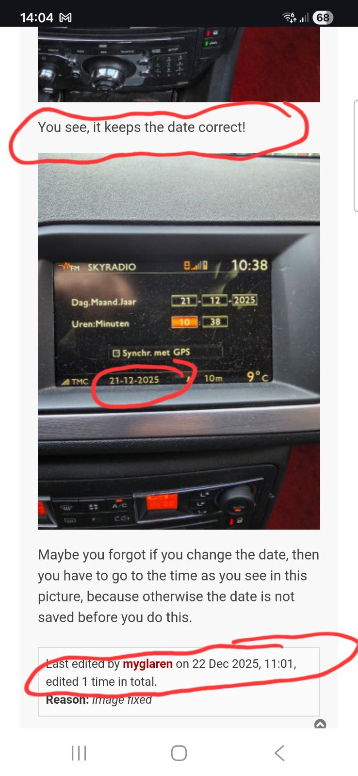

Date can't be change when GPS sync is on.
It looks like you’re also experiencing an issue with the date getting stuck. Tomorrow, you’ll see today’s date, which will be incorrect.

You see, it keeps the date correct!
Maybe you forgot if you change the date, then you have to go to the time as you see in this picture, because otherwise the date is not saved before you do this.

But today is 22 dec not 21 dec. 8-[
The problem is that the date does not change with the days, manual change and saving is not a problem. When I change the date manualy I do this by silmply click OK with the main dial to save it.

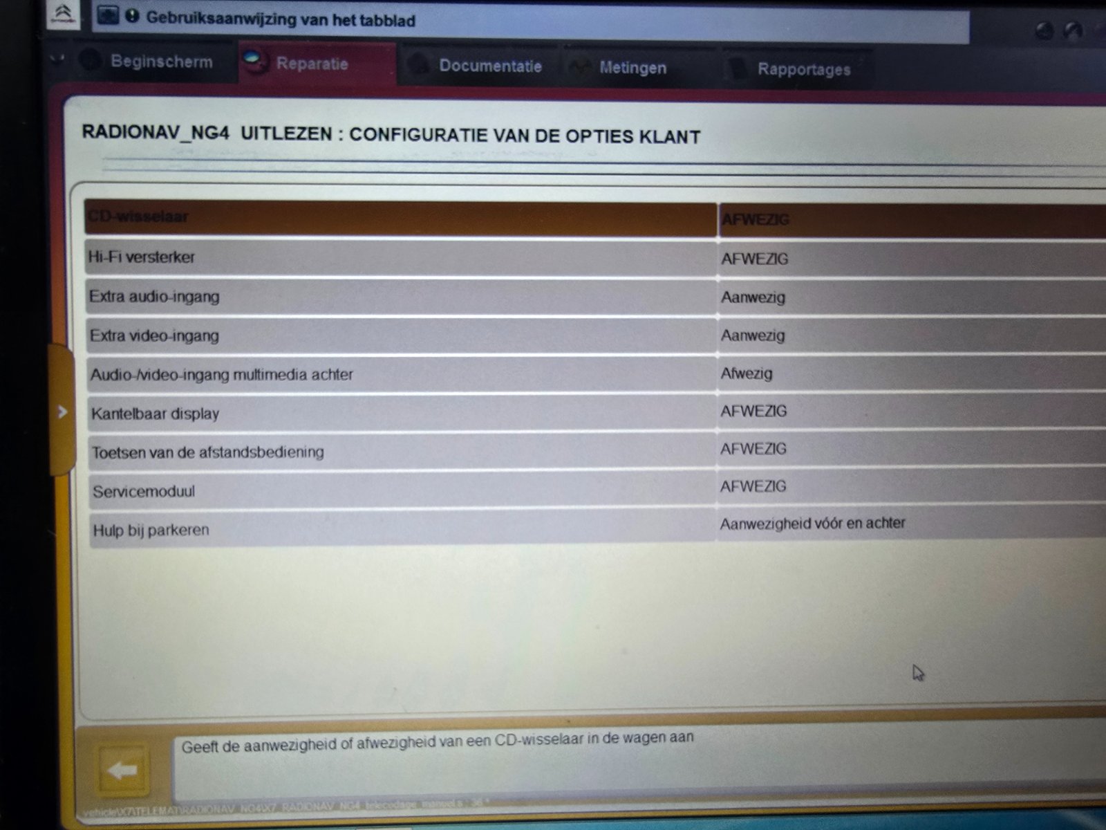

Maybe you have to look in a different direction, see this post:
viewtopic.php?p=830826#p830826
In the past I replaced the RT4 for the NG4. For this reason i don't have this module in my car and therefore switch this of with the diagbox.

You go to repair/NG4/options costumer/manual telecodering/servicemodule
