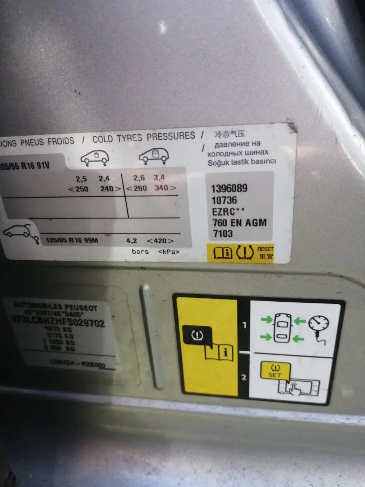

With it being a stop/start vehicle it should have an AGM battery but some S/S cars across the Stellantis range were released with EFB batteries, presumably because they had a temporary shortage of AGM ones. Then, when you check battery suppliers, you'll probably find that they recommend AGM.
The type of battery actually fitted should be recorded on the tyre pressure sticker and will say either AGM or EN. Post a photo if you're not sure.
As AGM is a better spec than EFB fitting one is an improvement and not depreciated.

- Posts: 9344
- x 1942
Re: Which battery? start stop, C4 Spacetourer 1.5 hdi
This is what I mean by looking at the tyre pressure sticker.

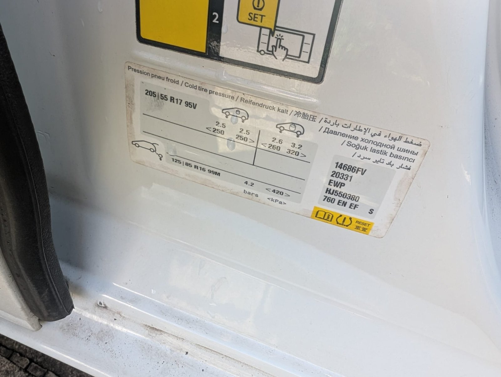

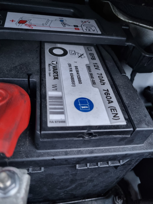

Just had a look at our 2019 1.5 hdi 308. Nothing on the tyre sticker (a bit disappointed after reading above) but it has the original Varta battery and the label on it gives EF 760A EN so not an AGM battery.
Thanks for answers. My old battery is EFB. I Will also check the sticker.
