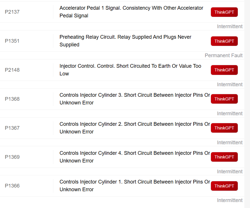

1.6HDi in a 2011 Belingo Van, I would really appreciate some help. There are some things that are noticeable: it runs perfectly on really cold days until the engine warms, then loses power and stalls on any slight gradient or the limp mode cuts in but clears after a restart, when not in limp mode if i can keep the revs over 2900 it is no problem but between 2000 and 2900 it is very rugh and mainly cuts out. Also, occasionally, when in limp mode, the accelerator stops responding.
Here are the relevant fault codes.
P1237 intermittent Accelerator pedal one signal. consistency with other Accelerator pedal signals
P2148 intermittent Injector control. controle; short to earth
P1369 intermittent controls Injector cylinder 4. Short Between pins
P1368 intermittent controls Injector cylinder 3. Short Between pins
P1367 intermittent controls Injector cylinder 2. Short Between pins
P1366 intermittent controls Injector cylinder 1. Short Between pins

Your first fault code P1237 might be the cause of the others, Inside the pedal sensor are 2 sensor tracks and they must read the same value. I would try one from a breakers to eliminate it, then clear your faults and try again

Check that the accelerator pedal errors are no longer appearing. It's unlikely but not unheard of for used parts to also be faulty.
After that I'd be taking a good close look at the engine bay wiring loom for any sign of damage. It's unlikely all 4 injectors have intermittent shorts, even if they're the crappy Siemens ones.

Re: Engine trouble 1.6HDi in a 2011 Belingo Van, intermittent but getting worse
You do seem to be getting a fair few "short to earth" issues.
No specific clues I'm afraid, but to give you an idea of the sort of thing to look for...
On mine, the airbox had been badly refitted, and was missing the assorted rubber bits to hold it in the right place. As a result, the sirbox had rubbed through the glowplug wiring harness in two places.
