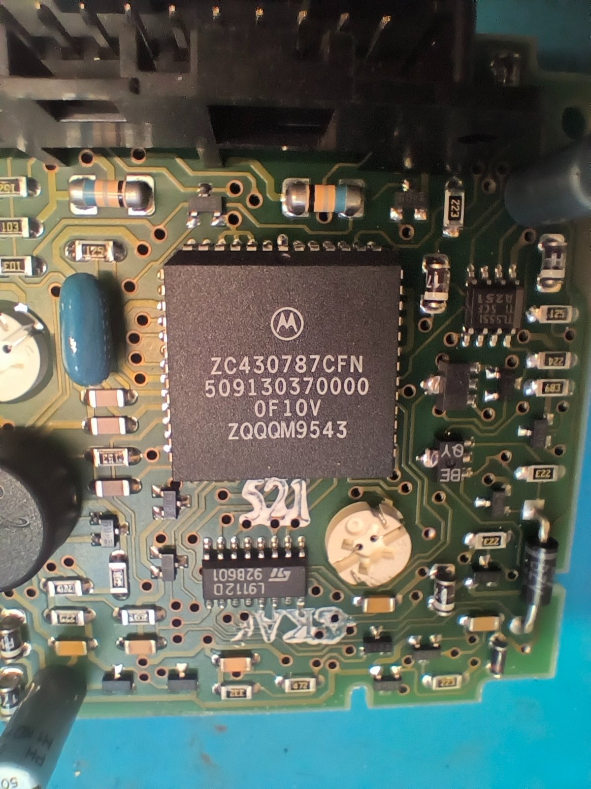

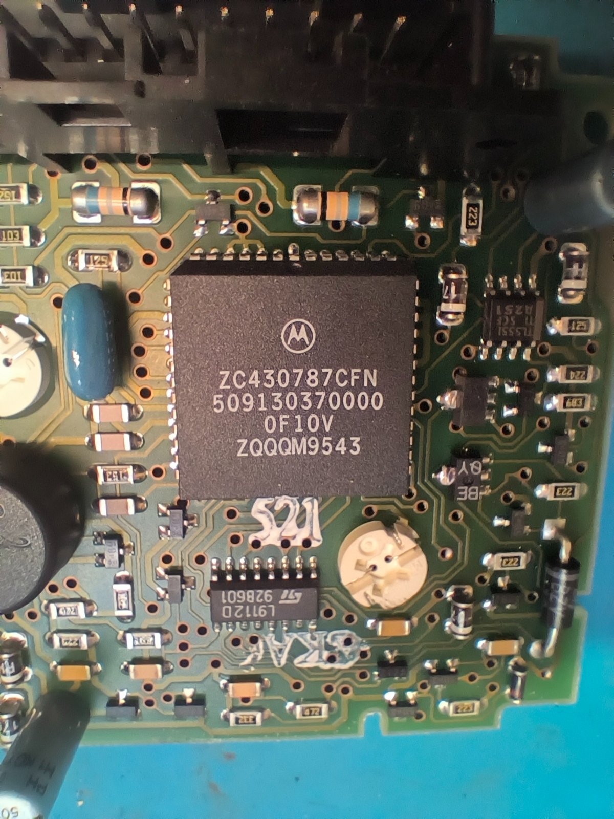

Ok i will have a look tonight, as far as the keypad goes i believe its the big square motorola MCU

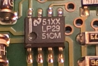

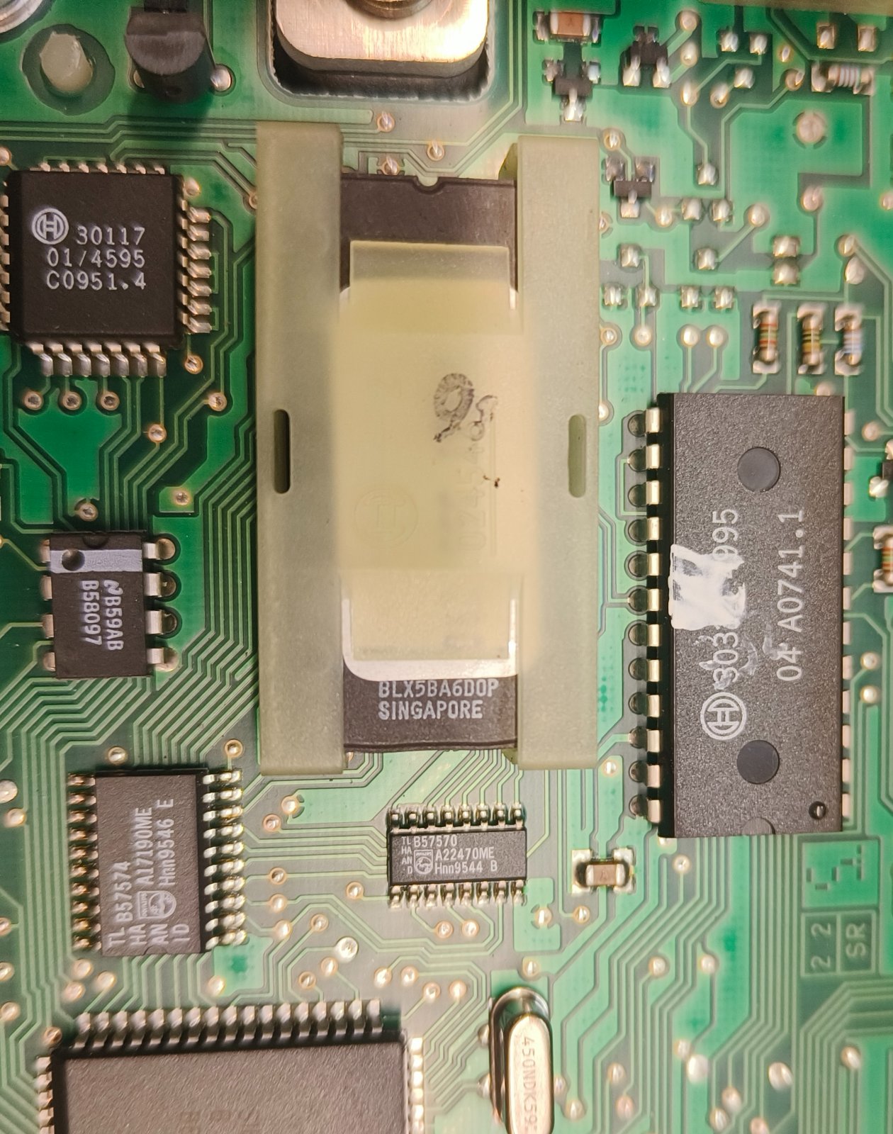

Re: Old school problem: 406 keypad bypass

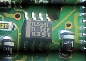

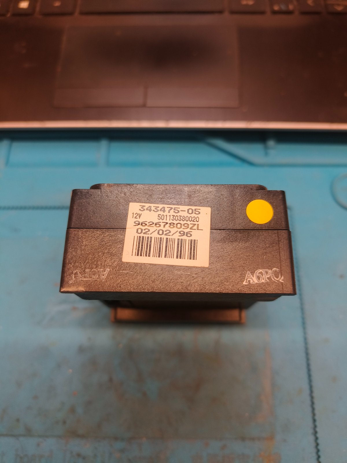

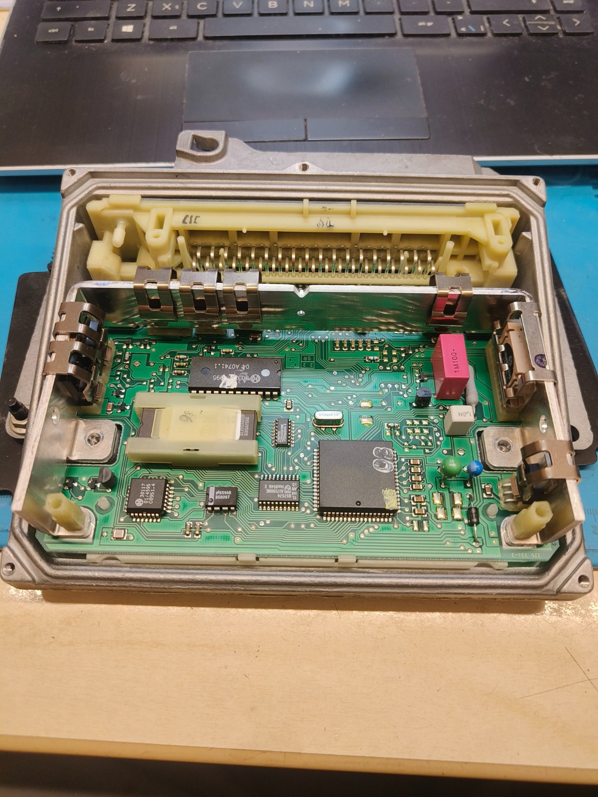

Here are pics of engine ECU and keypad PCB. Keyboard seems to have 3 ICs, one timer, one regulator and one unknown to me.

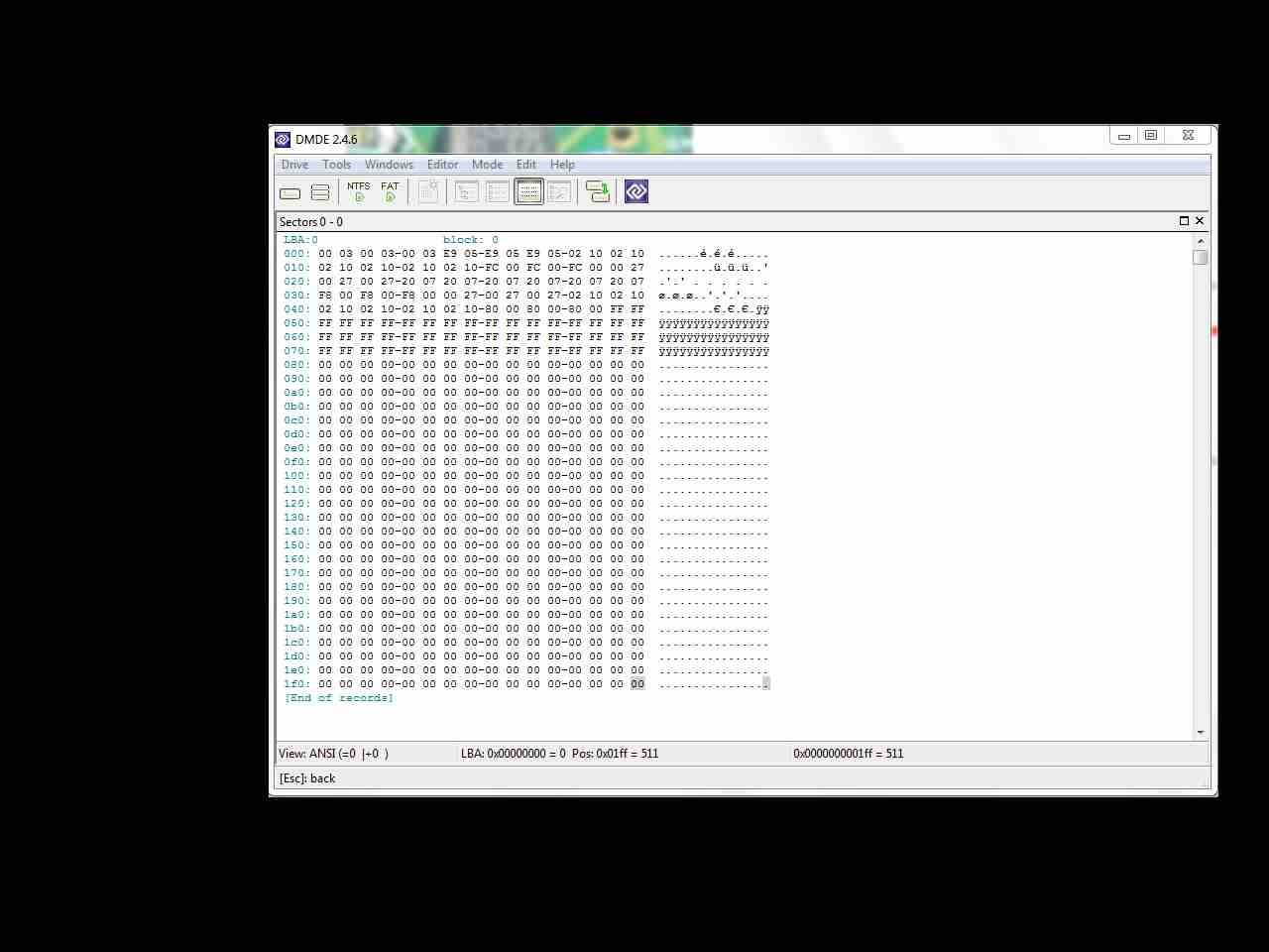

Trickiedickie
- Posts: 57
- Joined: 12 Mar 2018, 10:32
- x 14
This might help. Its the dump viewed in a simple hex editor.....
