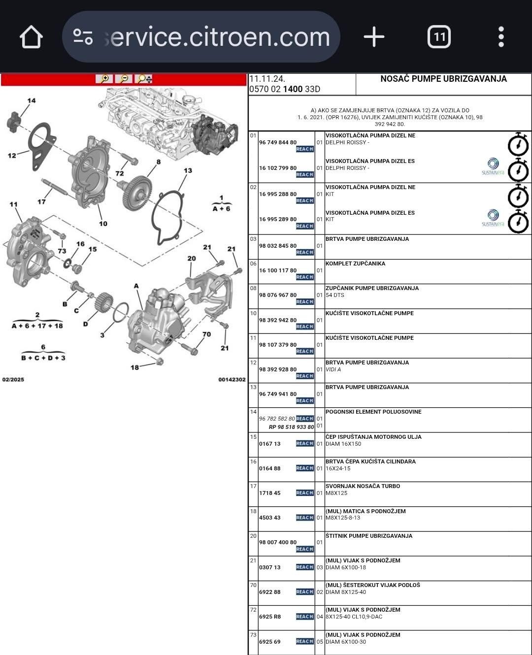

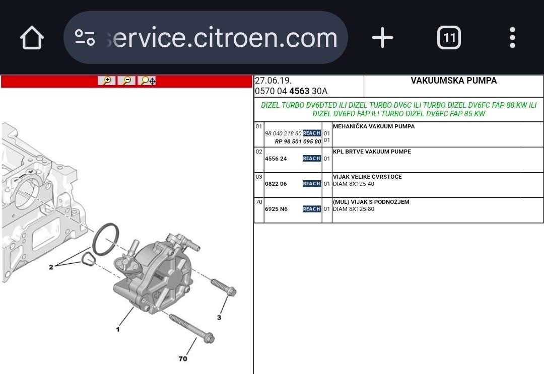

Hello,
It seams i have a oil leak due to high pressure fuel pump drive mechanism gasket failiure. It its used to seal the engine block and drive mechanism driving the hpfp.
Would like to change that gasket + hpfp o ring seal + vacuum pump two o ring seals but having issues finding those parts and even part numbers in Serbia.
Anyone knows or can check anywhere the actual OEM part numbers or replacement part numbers?
Thanks..

Managed to get the parts. Attached here in case someone else might need it..
