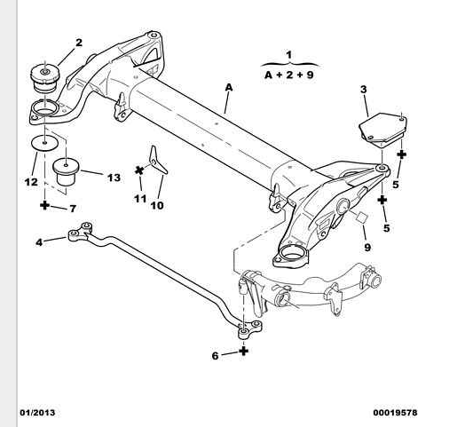

think, Bigger Xantia....due to it being a swing arm suspension it is more a torsion bar than a arb as we know them as the bar bolts directly to the swing arm itself..
