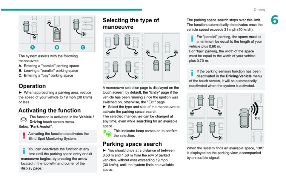

I don't know if this covers what you are looking for:
BFTW
BFTW

Hi mick thanks for try, but this is manual how to use it, i need tutorial for programming bsi/nac to have this option, my car by default doees not have it
