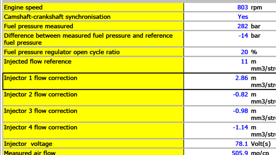

I then borrowed a Lexia diagnostic tool to check for fault codes. No major faults were found, except for an IAT sensor fault (P0110). However, when reviewing the live data from the ECU, I noticed something unusual related to the injectors.
The problem occurs as follows: on the first cold start in the morning, the car runs normally for about 40 minutes. After turning the engine off, each subsequent start allows the car to run for only about 10 minutes before it shuts down again.
I have attached a photo from the injection ECU data for reference. Based on this information, could the injectors be causing the engine to shut down, or do you have any other ideas or suggestions about what might be causing this issue?

At first, I suspected the battery because the problem started when the weather became very cold. However, after checking in more detail, several local mechanics suggested that the issue might be related to the fuel system, such as the fuel pump, fuel pressure regulator, or similar components. I replaced these parts, but the problem was not resolved.
