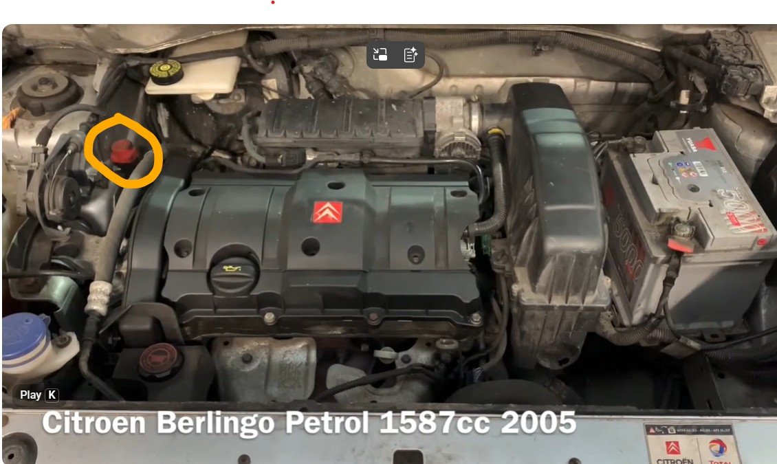

MarkA67 wrote: 10 Dec 2025, 22:08 if I turn the key off and then back on the hazard lights come on again.
This is classic symptoms of a tripped inertia switch, and also the fact the fuel pump is no longer priming.
Did it cut out whilst driving?
The inertia switch should be on one of the strut turrets O/S from memory, try pushing it down to re set it.
If there was an immobiliser issue you would get a flashing key warning light on the dash & beeping if the key is not detected, also on this model if the key is not detected it does not stop the low pressure fuel pump operating.
