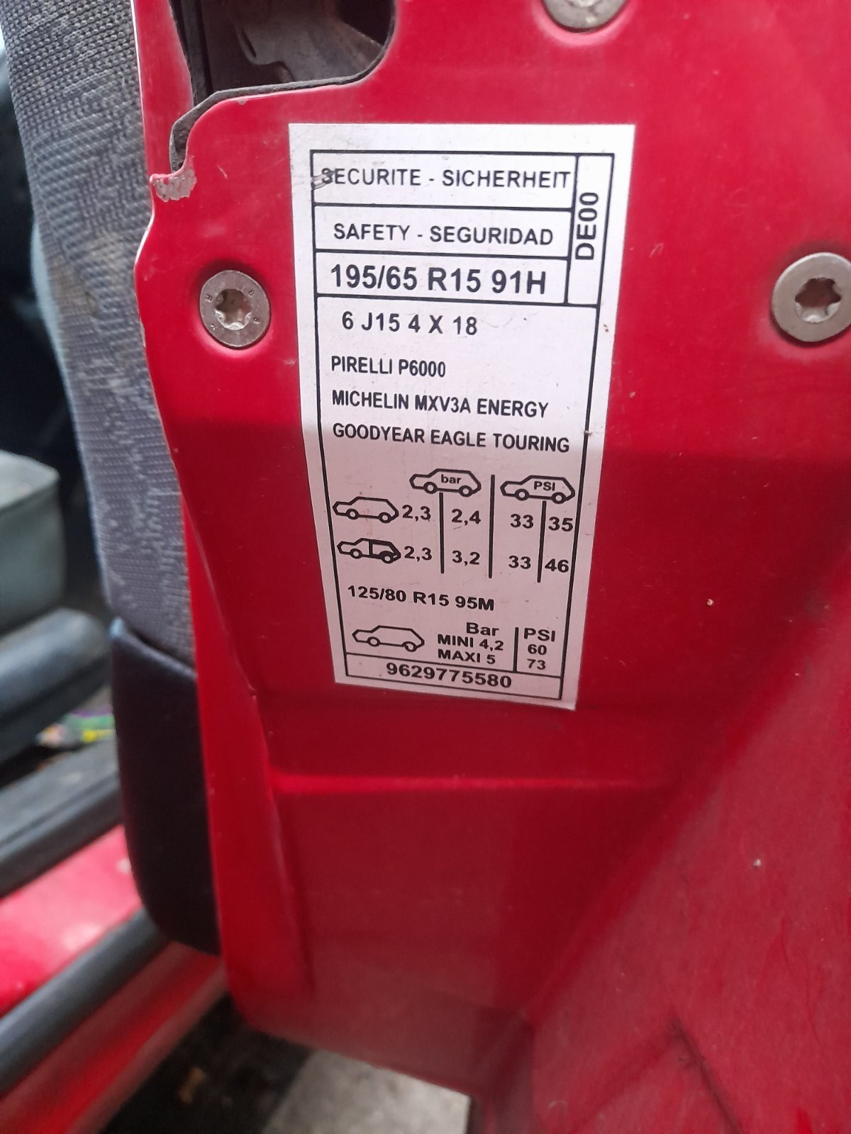

It is on the tyre pressure sticker on the door pillar. Post a pic of the sticker and I will confirm the RPO from it. :)

mickthemaverick wrote: 11 Dec 2025, 15:15 It is on the tyre pressure sticker on the door pillar. Post a pic of the sticker and I will confirm the RPO from it. :)
Beat me as I edited, does 784889 sound plausible? Will check door sticker now. Thanks!
EDIT- last 6 on the sticker says 775580 so probably not looking at the right thing (unless not the original door, which is highly plausible also given the bodywork condition), will grab the missus' phone and try get a photo uploaded!

No, it generally starts with a 1 and is a 5 digit number, sometimes followed by two characters that show the country of origin :)

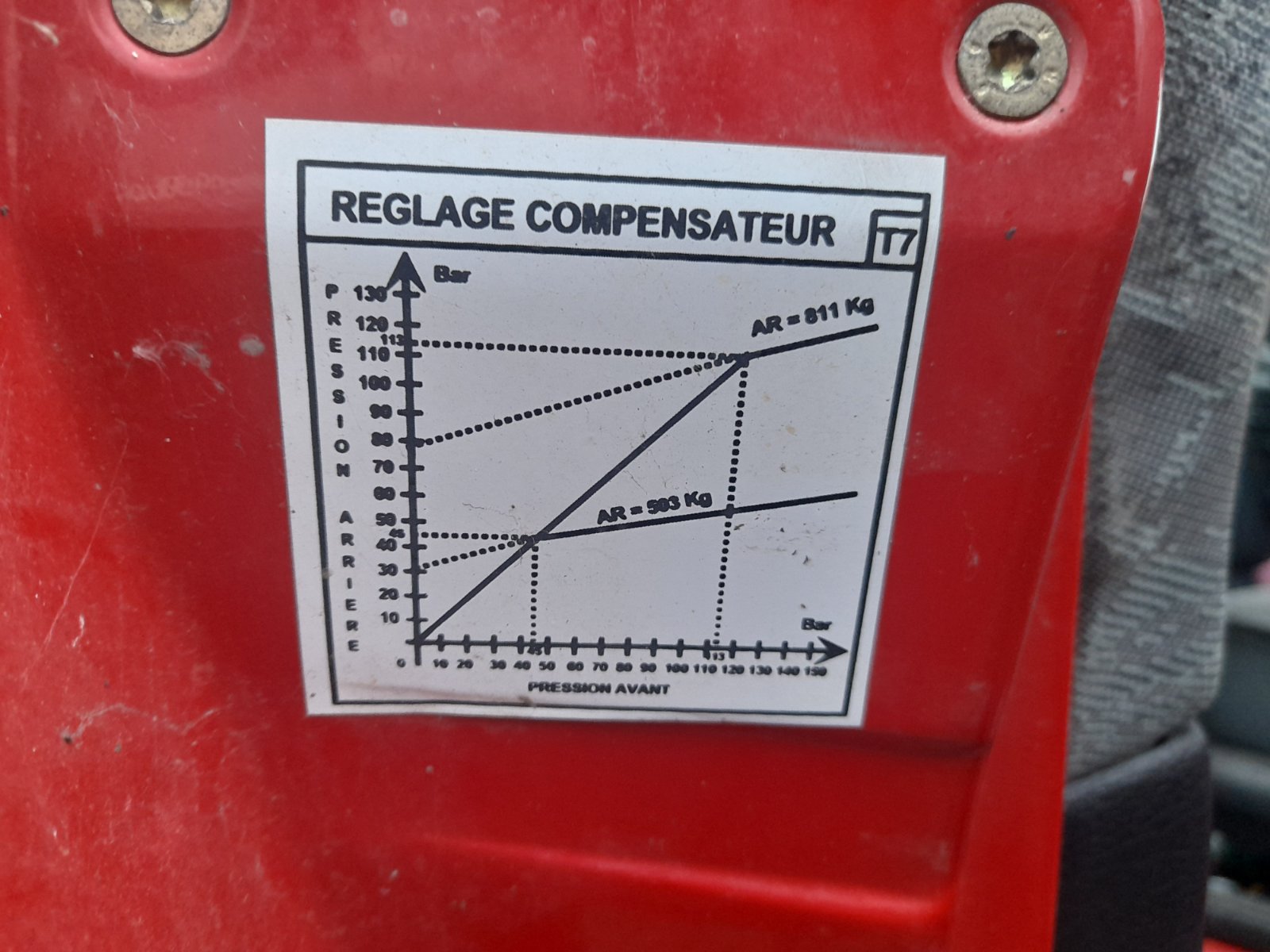

Going to attempt getting the photos across from phone to laptop now, but there's no 5 digit number on either of the stickers I can see (Unless you count the "195/65" part of the tyre size on the pressure chart lol). Only other sticker is the "Reglage Compensateur" or "Compensator Adjustment" sticker on the left door.
If I wasn't confused prior then I am now.
Damn phone is acting up not sending the photos across (This is exactly why I refuse to have a mobile! They just serve to infuriate!), but I can confirm nothing matching what you were expecting on either sticker #-o

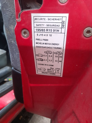

Finally it's worked, photos of what I have :) Please tell me I'm not going blind!

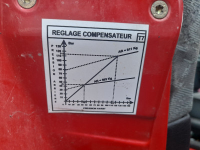

And the other one...

No you are not Dan, your car must be pre the practice of putting the RPO on that sticker. In which case I'll work out one for the year when looking for your diagram!! I'll be back in due course :-D
