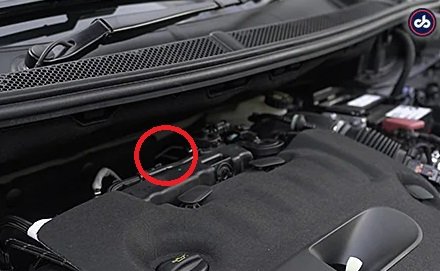

Any chance you can point out where I might be able to locate the heater feed and return hoses? The engine bay is super stacked and I'm not seeing anything obvious. Any pictures/videos will be super helpful.

I found this picture on the net and think the pipes are those I've circled in red but I may be wrong, it's not a very clear picture to begin with. :)

Oh yeah I think I found them! two black hoses one over another. The top one has a bleeder valve. Thanks mate, I'll see if I can squeeze in there somehow and check the temps.
