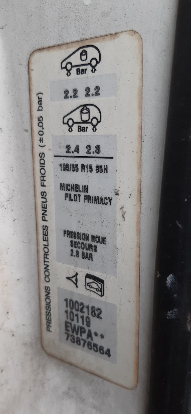

In order to access the correct diagram for your car we need to know the RPO number which is on the tyre pressure sticker. A pic of that sticker is the easiest way to post it. :)

Oh, I forgot that... sorry :wink:
RPO Sticker
RPO Sticker
