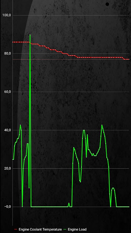

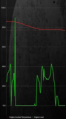

The engine cooling during coasting is quite a lot, here in this screenshot from Torque there is about 20 seconds of coasting during which the ECT drops nearly 10 deg C even though the coolant isn't anywhere close the thermostat opening temperature of 98 deg C.

I should get the VCI hardware sometime during next week. Lets see if that makes any difference.
